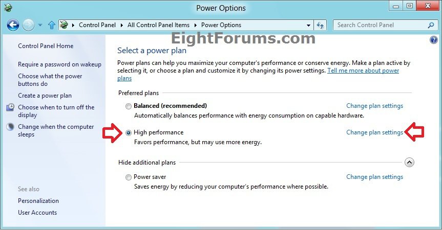

4. Click/tap on the Change plan settings link to the right of the power plan that you want to change the settings of, then do either step 5 or 6 below for what you would like to change. (see screenshot below)
NOTE: Normally you would want to change the settings of the power plan that you have selected (dotted) as your default power plan.

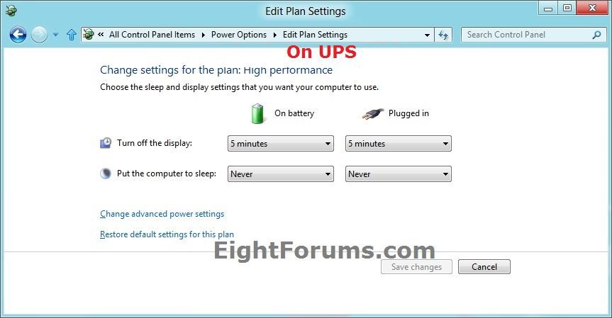

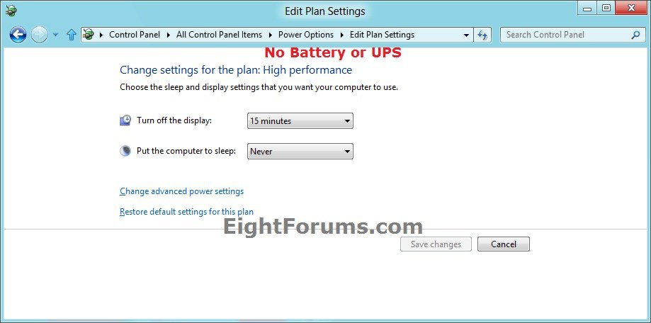

5. To Change "Sleep" & "Display" Power Plan Settings
A) Select how many minutes to wait for the Turn off display and Put the computer to sleep settings, or select never if you do not want to use a setting. (see screenshots below)
NOTE: If you have a computer has a battery (ex: laptop or tablet), or connected to a UPS, then you will be able to change these settings for when your computer is on battery and plugged in.
B) When finished, click on the Save changes button to apply your changes. (see screenshots above)

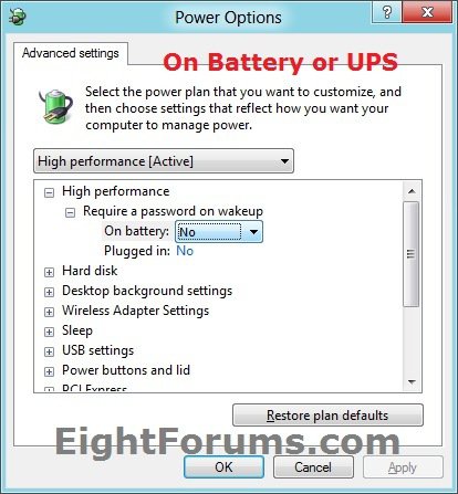

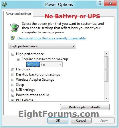

6. To Change Advanced Power Settings
A) Click/tap on the Change advanced power settings link. (see screenshots below step 5A)

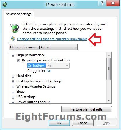

B) Click/tap on the Change settings that are currently unavailable link. (see screenshot below)
NOTE: You will need to be signed in as an administrator for this option. This option allows you to change the power plan settings that are grayed out by default.
C) You can now make changes to the power plan settings below to suite your needs. (see screenshots below)
D) When finished, click/tap on OK to apply your changes. (see screenshots above)
