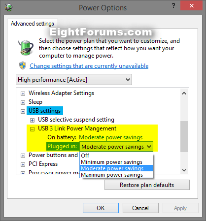

This tutorial will show you how to add or remove the "USB 3 Link Power Mangement" setting under USB settings in Power Options for all users in Windows 8 and 8.1.
This setting specifies a power management policy below to use for USB 3 links when they are idle.
- Off = Do not enable the U1 U2 states.
- Minimum power savings = Enable the U1 U2 states, but choose conservative timeout values to optimize for performance.
- Moderate power savings (default) = Enable the U1 U2 states, and choose optimal timeout values to balance power and performance.
- Maximum power savings. = Enable the U1 U2 states, and choose aggressive timeout values to optimize for power.
This could be handy if you wanted to set this how you wanted, then remove the setting to prevent other users from being able to change it in Power Options.
EXAMPLE: "USB 3 Link Power Mangement" in Power Options
HKEY_LOCAL_MACHINE\SYSTEM\CurrentControlSet\Control\Power\PowerSettings\2a737441-1930-4402-8d77-b2bebba308a3\d4e98f31-5ffe-4ce1-be31-1b38b384c009
Attributes DWORD
1 = Remove
2 = Add
