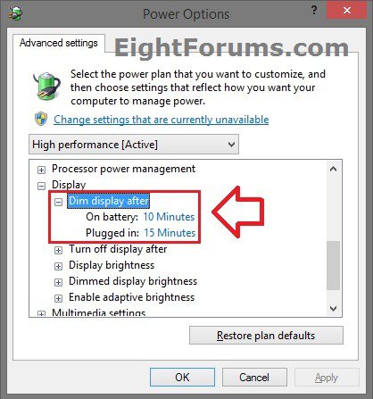

EXAMPLE: "Dim display after" added to Advanced Power Settings
