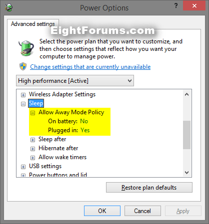

This tutorial will show you how to add or remove the "Allow Away Mode Policy" setting under Sleep in Power Options for all users in Vista, Windows 7, and Windows 8.
Away Mode is designed specifically for scenarios where the user is done interacting with the computer, but the system must remain powered on to record a TV broadcast or share media files with other systems and devices. For example, the system might be providing access to Windows Media Center Extender or other consumer electronics devices and therefore must remain available even though the user is not interacting with the system at the local console. Away Mode enables a living room media PC to respond to a user’s power on-off requests in the same manner as a television or set-top box that might appear off, but actually continues working.
This could be handy if you wanted to set this how you wanted, then remove the setting to prevent other users from being able to change it in Power Options.
The Allow Away Mode Policy setting will enable or disable Away Mode for users using the same power plan scheme this was set in.
An example of an Away Mode setting, is the Allow the computer to enter Away Mode for When sharing media in your power plan scheme "Power Options".
EXAMPLE: "Allow Away Mode Policy" in Power Options
HKEY_LOCAL_MACHINE\SYSTEM\CurrentControlSet\Control\Power\PowerSettings\238C9FA8-0AAD-41ED-83F4-97BE242C8F20\25DFA149-5DD1-4736-B5AB-E8A37B5B8187
Attributes DWORD
1 = Remove
2 = Add

2. To Remove "Allow Away Mode Policy" from Power Options
Remove_Allow_Away_Mode_Policy.reg
3. To Add "Allow Away Mode Policy" to Power Options
Add_Allow_Away_Mode_Policy.reg
6. If prompted, click/tap on Run, Yes (UAC Windows 7/8) or Continue (UAC Vista), Yes, and OK to approve the merge.

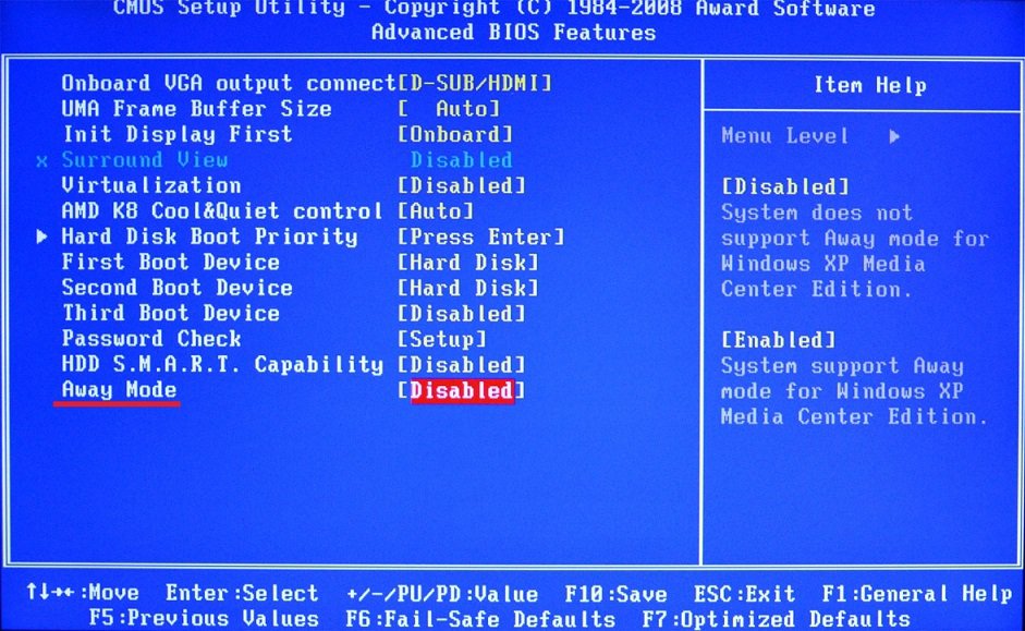

8. Boot to and check your BIOS settings to see if it may have an Away Mode setting that needs to be enabled or disabled as well, then exit BIOS with saving the changes. (see screenshot below)
Please read your computer's or motherboard's manual for this step.
This step will vary per computer/motherboard on how to boot to BIOS (setup), and if and where the Away Mode setting is.
