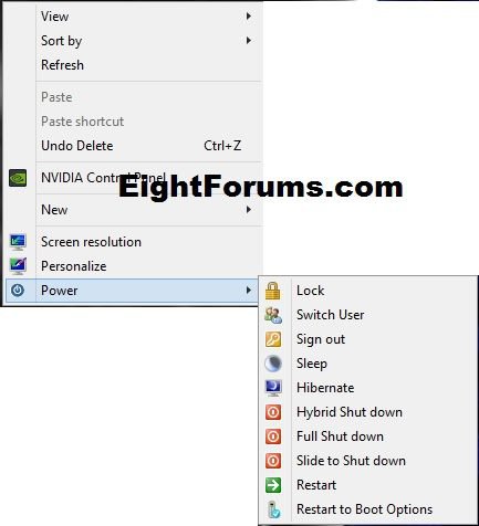

EXAMPLE: "Power" Cascading Context Menu

6. Right click on your desktop to see the change.
