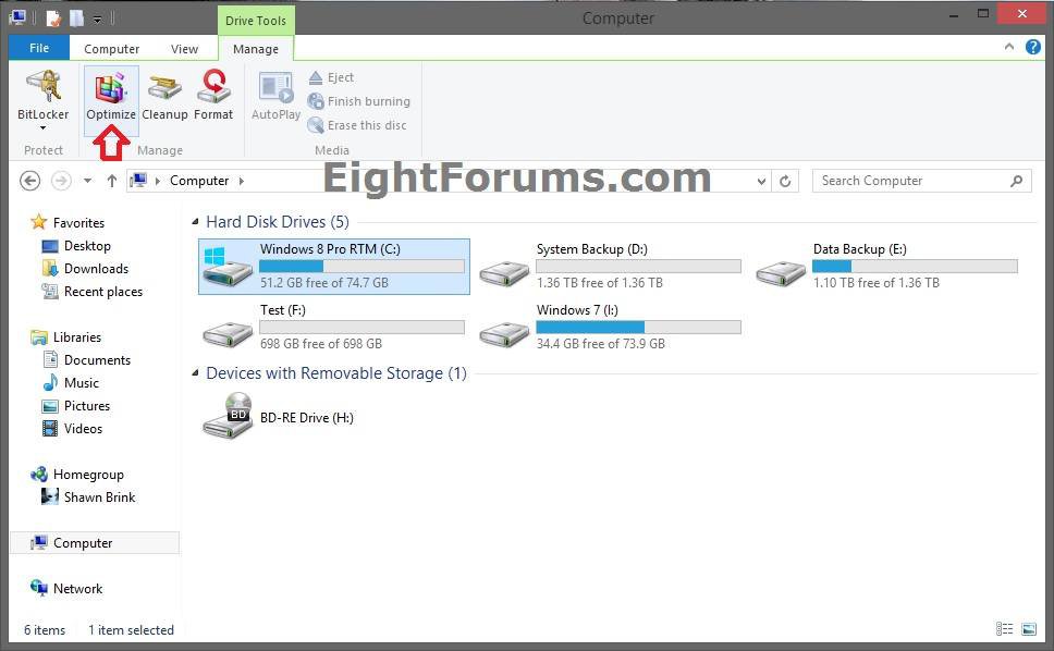

1. In File Explorer, click/tap on Computer (Windows 8) or This PC (Windows 8.1), do step 1A or 1B below, then go to step 2 below.​
A) Select a HDD or SSD, click/tap on Manage (Drive Tools) tab, and click/tap on the Optimize button in the ribbon. (see screenshot below)​

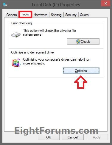

B) Right click or press and hold on a HDD or SSD, click/tap on Properties, click/tap on Tools tab, Optimize button, and on OK. (see screenshot below)​

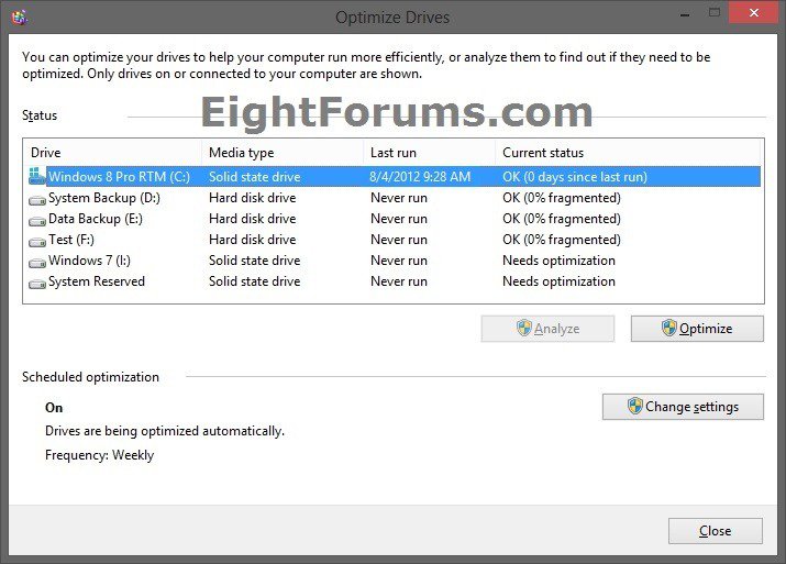

2. Under Status, click/tap on the drive you want to optimize. (see screenshot below)​
NOTE: The Media type column tells you what type (HDD or SSD) of drive you're optimizing.​

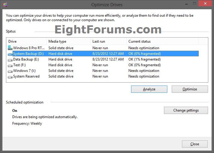

3. To determine if a HDD needs to be optimized, click/tap on Analyze. If prompted by UAC, then click/tap on Yes. (see screenshot below)​
NOTE: This is not available for a SSD.​
4. Check the Current status column to see whether you need to optimize the drive (SSD or HDD). If the drive is more than 10% fragmented, then you should optimize the drive now.​
5. To optimize the selected drive, click/tap on Optimize. If prompted by UAC, then click/tap on Yes. (see screenshot above and below)​
NOTE: Optimizing a drive might take anywhere from several minutes to a few hours to finish, depending on the size of the drive and degree of optimization needed. You can still use your PC during the optimization process.​
6. When finished, you can close the Optimize Drives window.​

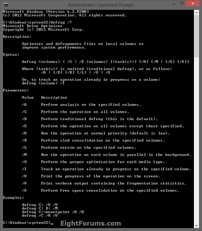

4. In the command prompt, type in the following command below followed by one or more switches (flags) that you would like to use below with a space between each switch and press Enter.​
Syntax:
defrag <volumes> | /C | /E <volumes> [<task(s)>] [/H] [/M | [/U] [/V]]​
Where <task(s)> is omitted (traditional defrag), or as follows: /A | [/D] [/K] [/L] | /O | /X​
Or, to track an operation already in progress on a volume: defrag <volume> /T​
Commonly Used Commands:
defrag C: /O
NOTE: Substitute C: in the command with the drive letter you want instead.​
defrag /C /O
NOTE: For all HDDs and SSDs.​

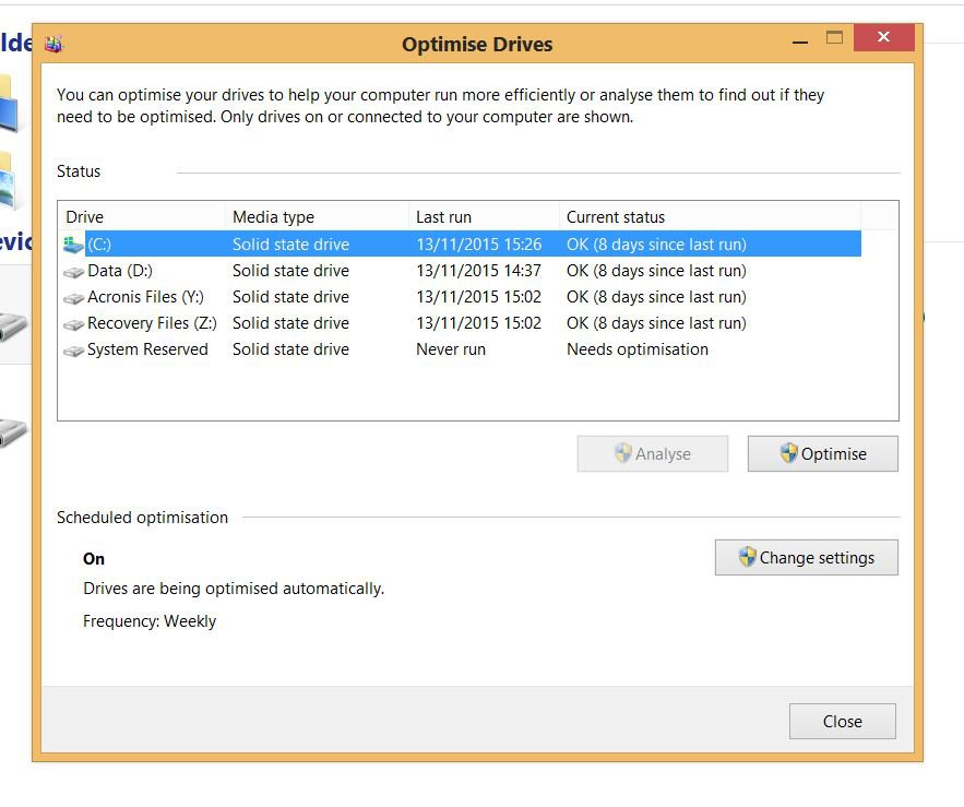

I recently fitted a new SDD drive to my laptop and clean installed W8.1 onto it but there is one thing I'm not sure about. In the external link in post #1 (The real and complete story...) there is mention that 'Volume Snapshots' or 'VSC' needs to be enabled for the 'Optimise' function to run on schedule, and which as I understand it means that the standard Restore Points utility in Windows should be active and not disabled..
Now I have System Restore turned OFF simply because I use disk imaging instead.
So a couple of questions...
Is having System Restore disabled the reason I have now over run the first scheduled weekly 'Optimise' ?
Is this also the reason I don't see the 'Analyse' option, (its greyed out) and so consequently I don't see how fragmented the drive is.
Any recommendations (I could turn System Restore on if it would help) but you don't normally have that function enabled for other partitions and so what about those.
Or should I just manually run 'Optimise' every once in a while. When I do this though, it all seems to be over with in seconds.
Edit... trim is enabled when I check using a command prompt.

Thanks for the reply Shawn :) so I can see I have a bit of reading up to do here as I'm confusing what some of the services actually do. Looking in 'Services' and I see that Volume Shadow Copy is set to manual. Now I've never altered that (or anything in services)...... so I'm sort of wondering why its now 9 days (its just rolled past the time in my screen shot above and added another day) and nothing seems to have happened.
Ah, now that's interesting to know. It may well not need any maintenance, at least based on how I was used to defragmenting manually the previous HDD and rarely seeing more than 1% fragmentation when performed weekly. A big round of updates would push that to perhaps 3% at most.
So perhaps that is actually a likely reason.
The frequency is set to 'Weekly' but the PC probably wasn't on at the exact time. The standard Windows Maintenance ? routine seems to run daily in the mornings if I just leave it idling for a 3 or 4 minutes... I see the action centre flag change to show its running. I don't know if the SSD optimise would occur then if a time were missed.
I'll leave it be and see how it goes, like many things in Windows I'm sure it knows what its doing even when its owner is left wondering (lol).
Performance of the SSD is terrific though, things like a full image backup taking around 2.5 minutes compared to 10 minutes with old drive. So I just want to keep it like this.
