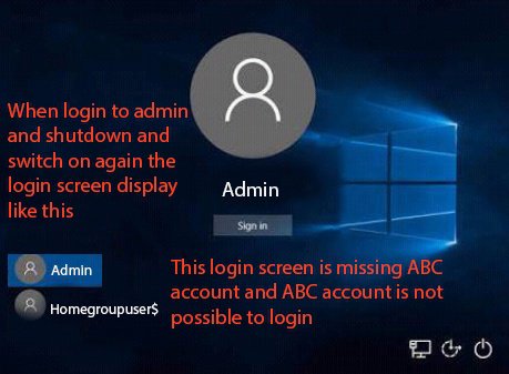

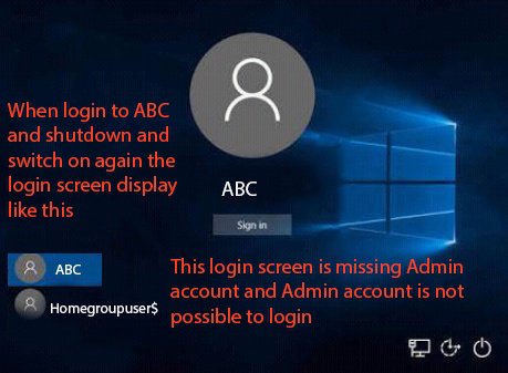

Windows 10 Single language login screen display only one user
which is default login user others missing. And when pressing switch user in ctrl+alt+del it
directly login to default user. What cause this problem and how do we solve this? I have
two users account 1.ABC and 2.Admin. Both of these are working and
switching user account is possible only by restarting and typing user name
in the login box and password but in normal windows 10 all users
names are appear on the left side in the login screen. please help
Sorry Brink I go through your link but cannot solve myself. If possible I just want to return to default windows login screen. Please help. Some problems with photo are attaching here.
admin acclog.jpgabclogin.jpgAdminuamoua.jpgABC uamoa.jpgnetplwiz admin.JPGRege 0-1.JPG

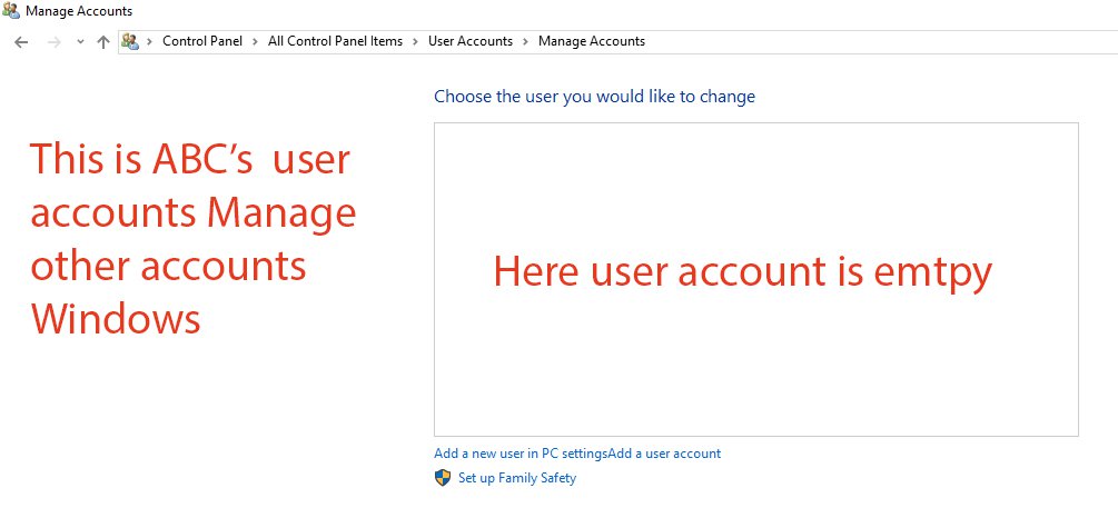

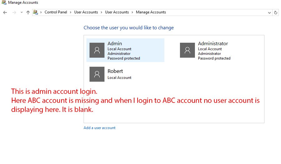

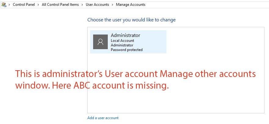

Brink I go through your tutorial given above but strange my problem still remain unsolved. Only newly created account by this admin account is displaying in login screen but not ABC account. Usually I have two user accounts one admin and the other ABC. When i login to admin account I cannot switch to ABC account, even abc user account is not visible in the user account only new account created through this admin account is visible. I cannot delete ABC account also because it is not visible to admin account. Only ABC folder is visible in Computer/Windows/users folder. What cause this problems and how do we solve it? Please help

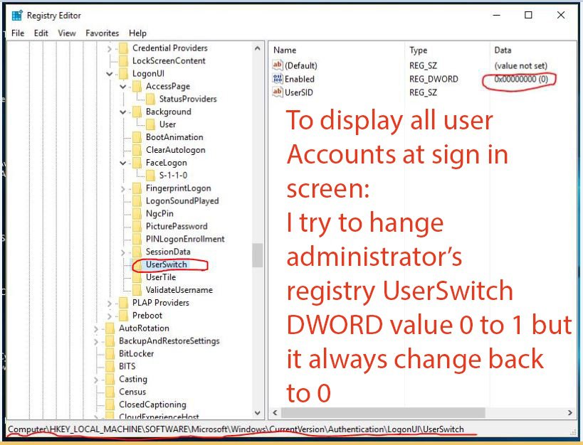

In addition, check using the tutorial below to see if you may have "Switch user" disabled. If so, enable it to see if that may help.
http://www.eightforums.com/tutorials/8169-switch-user-add-remove-windows-8-a.html

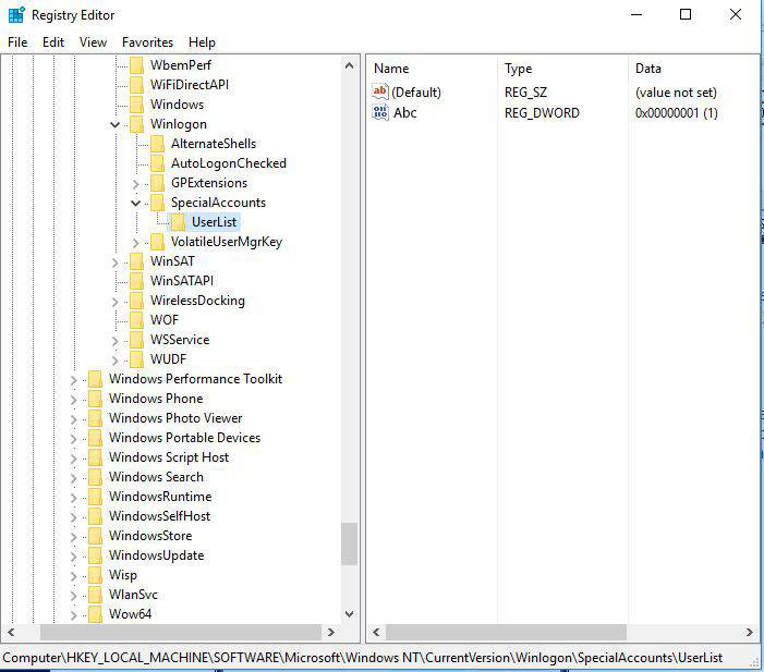

Let's double check using METHOD TWO in the tutorial below to see if the "ABC" account is shown as a DWORD in the SpecialAccounts key. If it is, then delete the ABC DWORD and see if ABC is displayed on the Sign-in screen afterwards.
User Account - Hide
HKEY_LOCAL_MACHINE\Software\Microsoft\WindowsNT\CurrentVersion\Winlogon\SpecialAccounts
After modifying registry according to your option no2 user account Abc is now appearing in user account list but a weird thing is that two same admin are also displaying in the login screen. Resulting photos are given below-
Did you want the "Abc" account to be a guest account instead of a standard local account?
What is the "Mayo" account. I didn't see it listed in your account details report? Did you rename it from the "Robert" account?

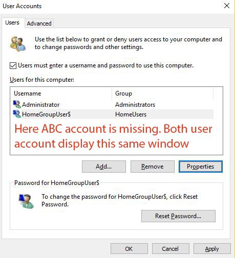

Do you still have the box checked in netplwiz to require users to sign in at startup?
I replace Mayo by Robert in cmd text copy because its my real account but in hurry i forgot to rewrite Mayo in user account list :)
Now Abc account is displaying in control panel user account list but not in both netplwiz user accounts and login screen. Abc account should be standard account i dont know how it become guest account.
If you like, you might see if creating a new account to use instead of "Abc" will show on the sign-in screen. If it does, then you could delete the "Abc" account afterwards if you like.
Now by the above tutorial I can delete the problematic ABC account. Everything is okay now. Thank you very much Brink for your tireless help.
