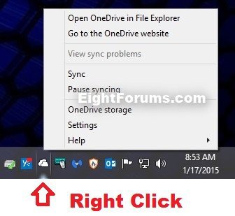

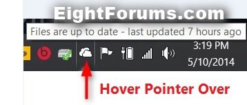

The OneDrive OneDrive_Icon.jpg notification area icon on the taskbar makes it easier to open OneDrive in File Explorer, view sync problems, and sync status.

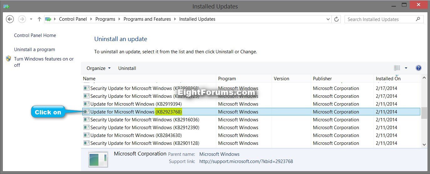

2. To Remove OneDrive Notification Area Icon
A) Uninstall the KB2923768 Windows Update, and restart the computer when prompted.​
3. To Add OneDrive Notification Area Icon
A) Install the KB2923768 Windows Update, and restart the computer when prompted.​
If the KB2923768 update is not already installed and unavailable in Windows Update, then you can also manually download and install the 32-bit or 64-bit KB2923768 for your same 32-bit or 64-bit Windows 8.1 at the Microsoft link below.

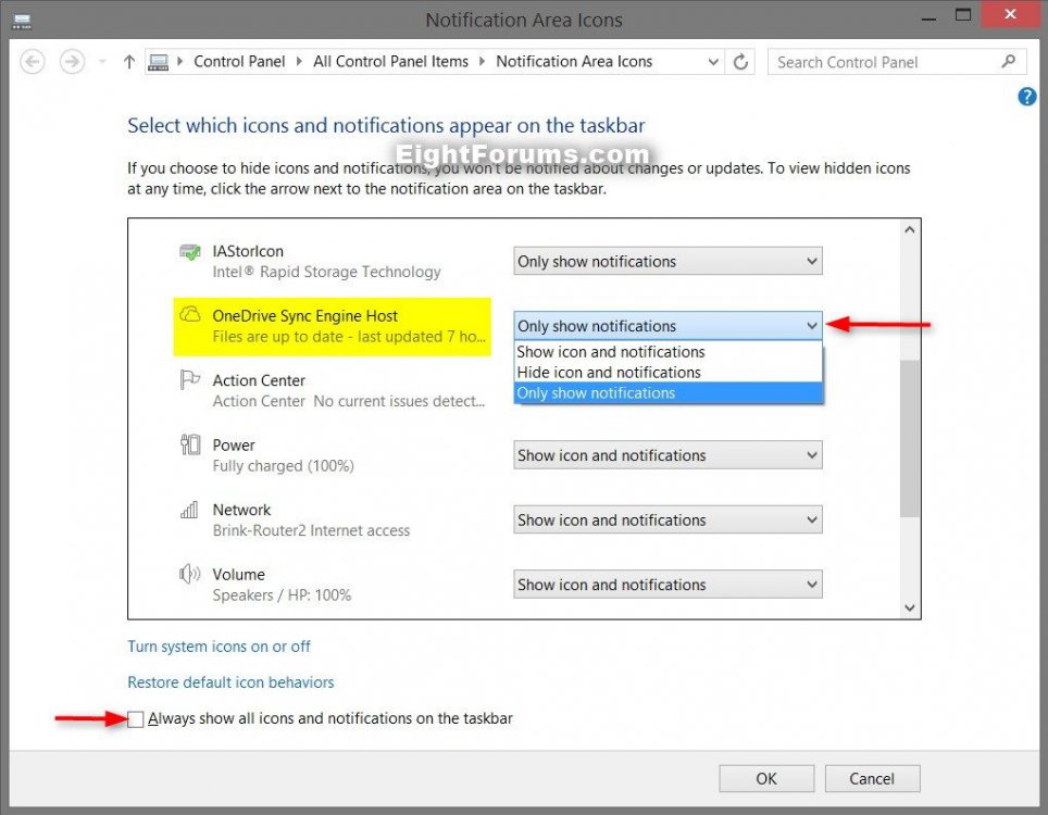

To Hide or Show OneDrive Notification Area Icon
This option will only affect your Microsoft account in Windows 8.1.
1. Open your Notification Area Icons settings, and do step 2 or 3 below for what you would like to do.​

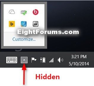

2. To Hide OneDrive Notification Area Icon
A) Uncheck the Always show all icons and notifications on the taskbar box. (see screenshot below)​
B) For OneDrive Sync Engine Host, select either Hide icon and notifications OR Only show notifications for what you want.​
3. To Show OneDrive Notification Area Icon
A) Check the Always show all icons and notifications on the taskbar box. (see screenshot below)​
OR
B) Uncheck the Always show all icons and notifications on the taskbar box, and select Show icons and notifications for OneDrive Sync Engine Host.​

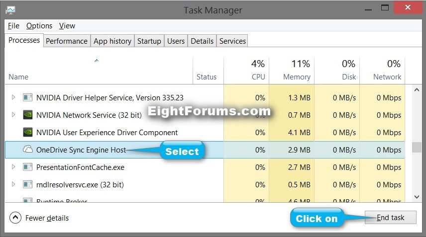

OPTION FOUR
Temporarily Remove OneDrive Notification Area Icon in Task Manager
This option will only affect your user account.
The next time you open the modern OneDrive app or sign in to Windows, the OneDrive notification area icon will return.
1. Open the Task Manager in more details view.​
2. In the Processes tab, click/tap on OneDrive Sync Engine Host to select it, and click/tap on the End task button. (see screenshot below)​
3. Move the pointer over the OneDrive OneDrive_Icon.jpg notification area icon on the taskbar to have it go away.​
4. You can now close Task Manager if you like.​
