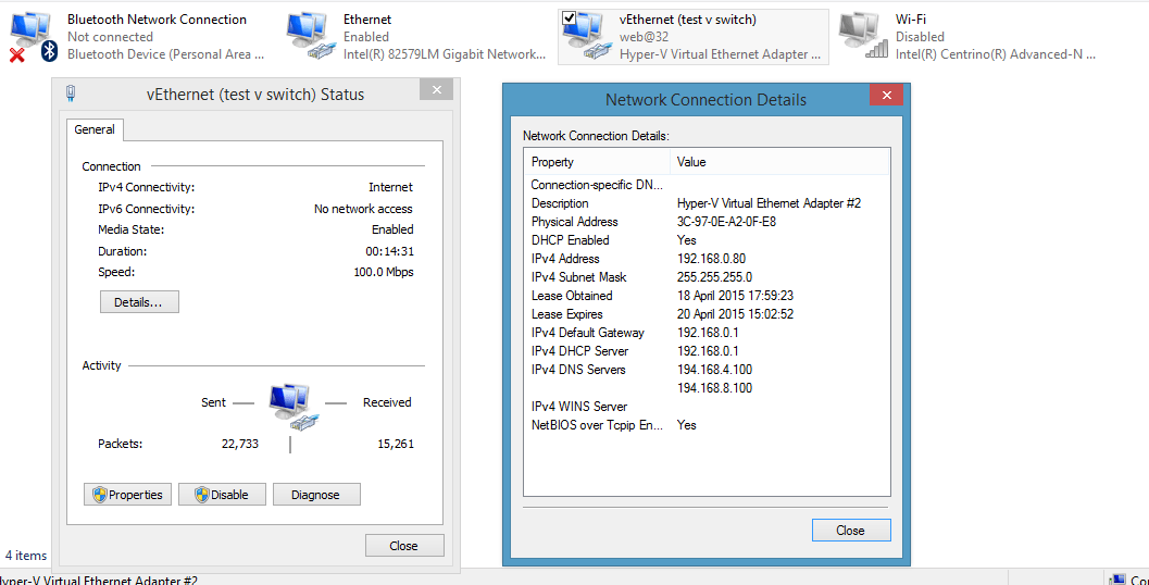

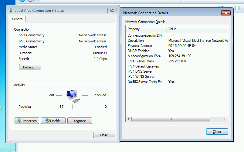

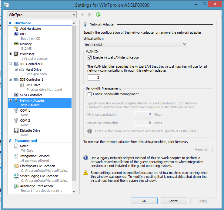

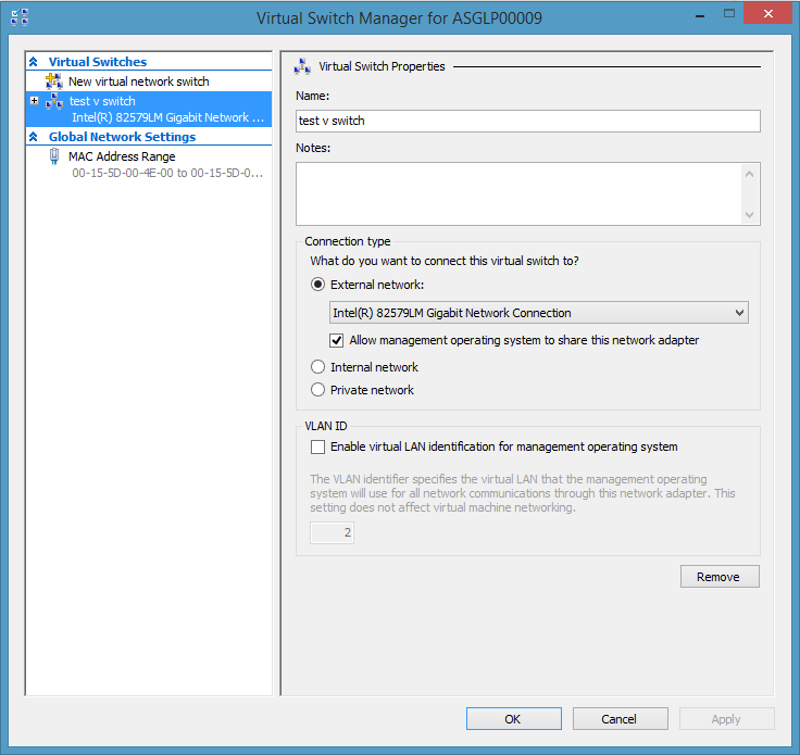

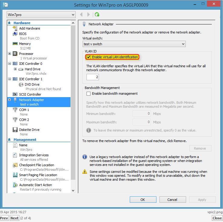

Hi Kari thanks for trying to help, hopefully I have all the images you want
Virtual network setting (win7)
attachment.php
Host network settings (win8.1)
attachment.php
Virtual Network Adapter setting
attachment.php
Virtual Switch settings
attachment.php
OK, one thing clear is that the Windows 7 vm is not at all connected. This is most probably because you have enabled the virtual LAN identification.
Disable it in vm settings, I've highlighted the checkbox in your screenshot you should unselect:
Try that and come back to tell how it went.
Kari
It worked
Found this post through google
@Kari Thanks for the solution, it was indeed that checkbox which was not letting the host and guest talk.
