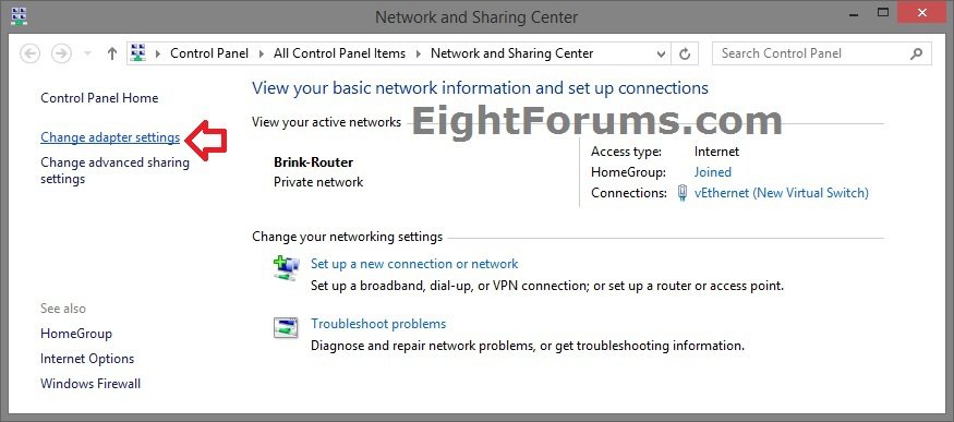

To Enable or Disable a Network Adapter in Network Connections
1. Open the Control Panel (icons view), and click/tap on the Network and Sharing Center icon.
2. Click/tap on Change adapter settings on the left side. (see screenshot below)

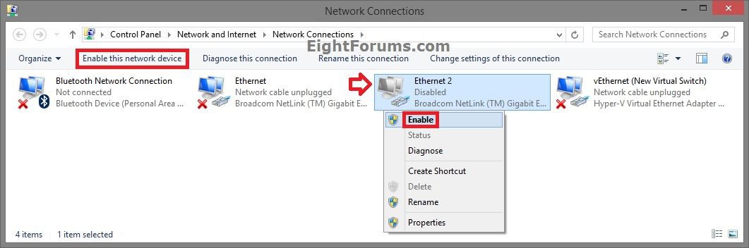

4. To Enable a Network Adapter
A) Click/tap on the network adapter (ex: Ethernet 2), and go to step 6 below. (see screenshot below)
OR
B) Select the network adapter (ex: Ethernet 2), click/tap on Enable this network device in the toolbar, and go to step 6 below. (see screenshot below)
OR
C) Right click or press and hold on the network adapter (ex: Ethernet 2), click/tap on Enable, and go to step 6 below. (see screenshot below)

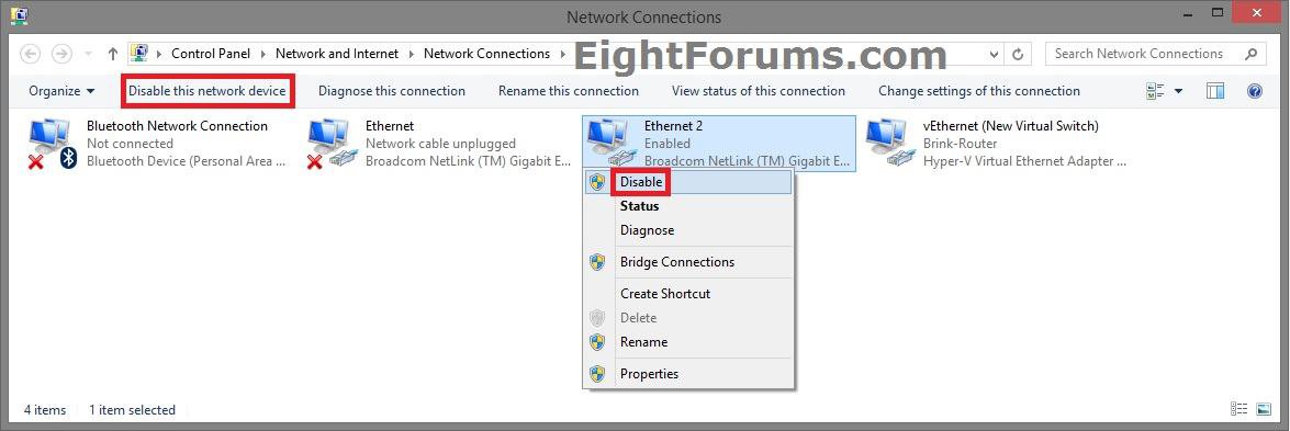

5. To Disable a Network Adapter
A) Select the network adapter (ex: Ethernet 2), click/tap on Disable this network device in the toolbar, and go to step 6 below. (see screenshot below)
OR
B) Right click or press and hold on the network adapter (ex: Ethernet 2), click/tap on Disable, and go to step 6 below. (see screenshot below)

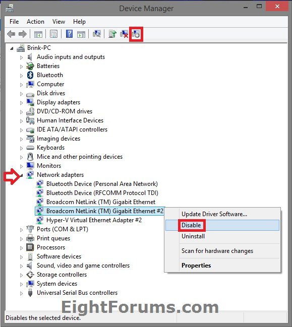

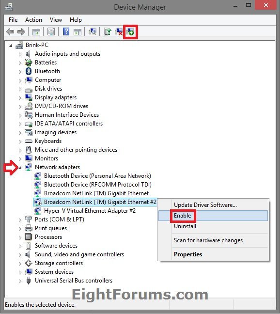

To Enable or Disable a Network Adapter in Device Manager
1. Open the Control Panel (icons view), and click/tap on the Device Manager icon.
3. Close the Control Panel, expand open Network adapters in Device Manager, and do step 4 or 5 below for what you would like to do. (see screenshots below step 4 and 5)
A) Select a network adapter (ex: Broadcom NetLink (TM) Gigabit Ethernet #2), click/tap on the Enable icon
OR
B) Right click or press and hold on a network adapter (ex: Broadcom NetLink (TM) Gigabit Ethernet #2), click/tap on Enable, and go to step 6 below. (see screenshot below)

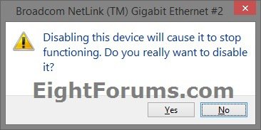

A) Select a network adapter (ex: Broadcom NetLink (TM) Gigabit Ethernet #2), click/tap on the Disable icon
OR
B) Right click or press and hold on a network adapter (ex: Broadcom NetLink (TM) Gigabit Ethernet #2), click/tap on Disable, and go to step 5C below. (see screenshot below)
C) Click/tap on Yes, and go to step 6 below. (see screenshot below)
6. When finished, you can close Device Manager if you like.

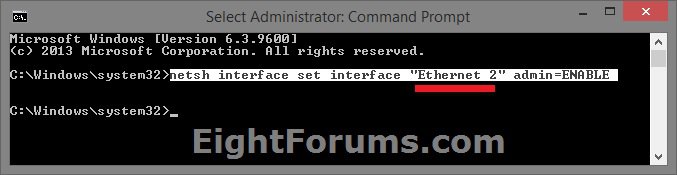

To Enable or Disable Network Adapter using "netsh" Command
2. In the elevated command prompt, copy and paste the command below, and press Enter. This will show you all network adapter names on your PC. (see screenshot below)
netsh interface show interface
3. Do step 4 or 5 below for what you would like to do.
A) In the elevated command prompt, type the command below, press Enter, and go to step 6 below. (see screenshot below)
Substitute network adapter name in the command below with the actual adapter name (ex: Ethernet 2) within quotes from step 2 above that you want to enable.
netsh interface set interface "network adapter name" admin=enable
For example: netsh interface set interface "Ethernet 2" admin=enable

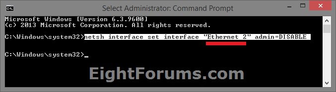

Substitute network adapter name in the command below with the actual adapter name (ex: Ethernet 2) within quotes from step 2 above that you want to disable.
netsh interface set interface "network adapter name" admin=disable
For example: netsh interface set interface "Ethernet 2" admin=disable

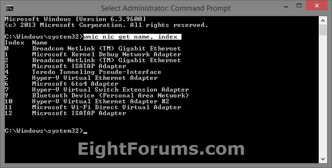

OPTION FOUR
To Enable or Disable Network Adapter using "wmic" Command
2. In the elevated command prompt, copy and paste the command below, and press Enter. This will show you a list of all network connections on your PC with an index number for each. (see screenshot below)
wmic nic get name, index

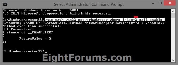

Substitute index-number in the command below with the actual index number (ex: 2) of the network connection (ex: Broadcom NetLink (TM) Gigabit Ethernet) from step 2 above that you want to enable.
wmic path win32_networkadapter where index=index-number call enable
For example: wmic path win32_networkadapter where index=2 call enable

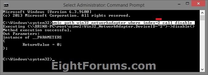

Substitute index-number in the command below with the actual index number (ex: 2) of the network connection (ex: Broadcom NetLink (TM) Gigabit Ethernet) from step 2 above that you want to disable.
wmic path win32_networkadapter where index=index-number call disable
For example: wmic path win32_networkadapter where index=2 call disable
