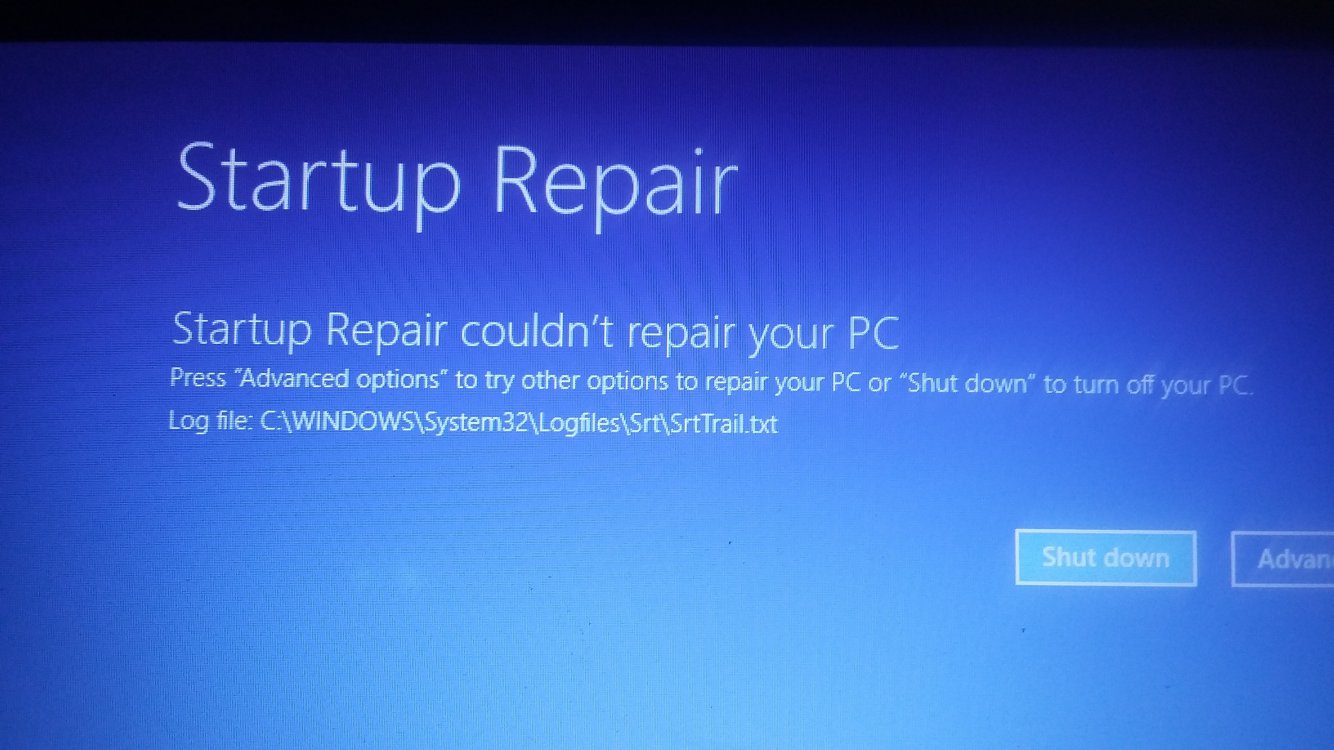

Ok here is what I did step by step.. I booted from flash drive then I went into advanced options and clicked Startup repair. It said the fallowing on the picture I attached. I am so not sure if I did this right.

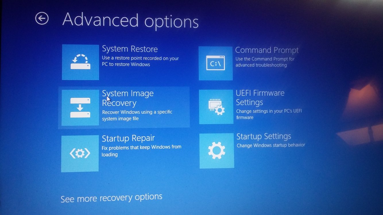

Startup Repair is not right. Did you get to the Advanced Options screen? I believe the first screen is this
imagepng
Next click on Troubleshoot, on the next screen click on Advanced Options, then System Image Recovery

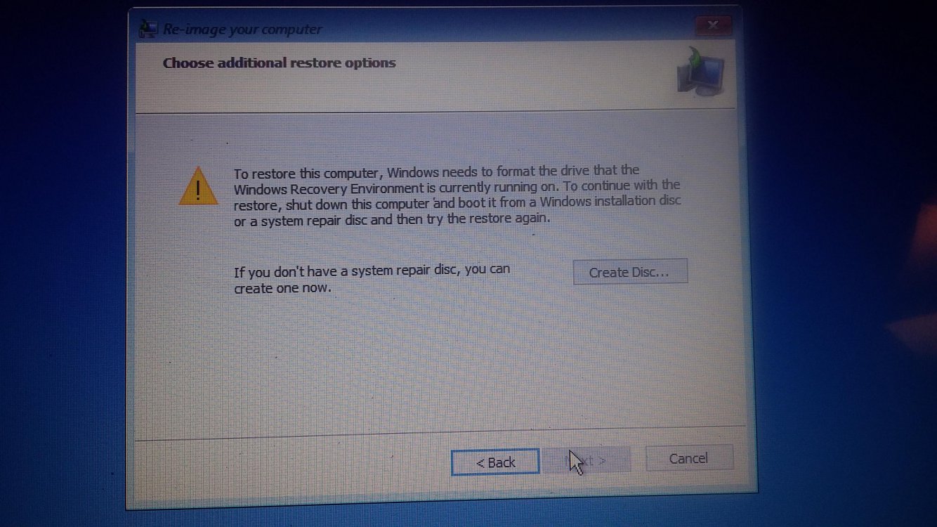

Yes I did that it keeps telling me I need to put the recovery disk in.. So what I think I will do is boot and download windows 8 and then try and do the sys:)tem image recovery. What do you think?
I'm not sure I follow you. You have to boot from the flash drive because Windows needs to format your hard drive. That's why you were getting that message when you tried holding down the shift key and rebooting.

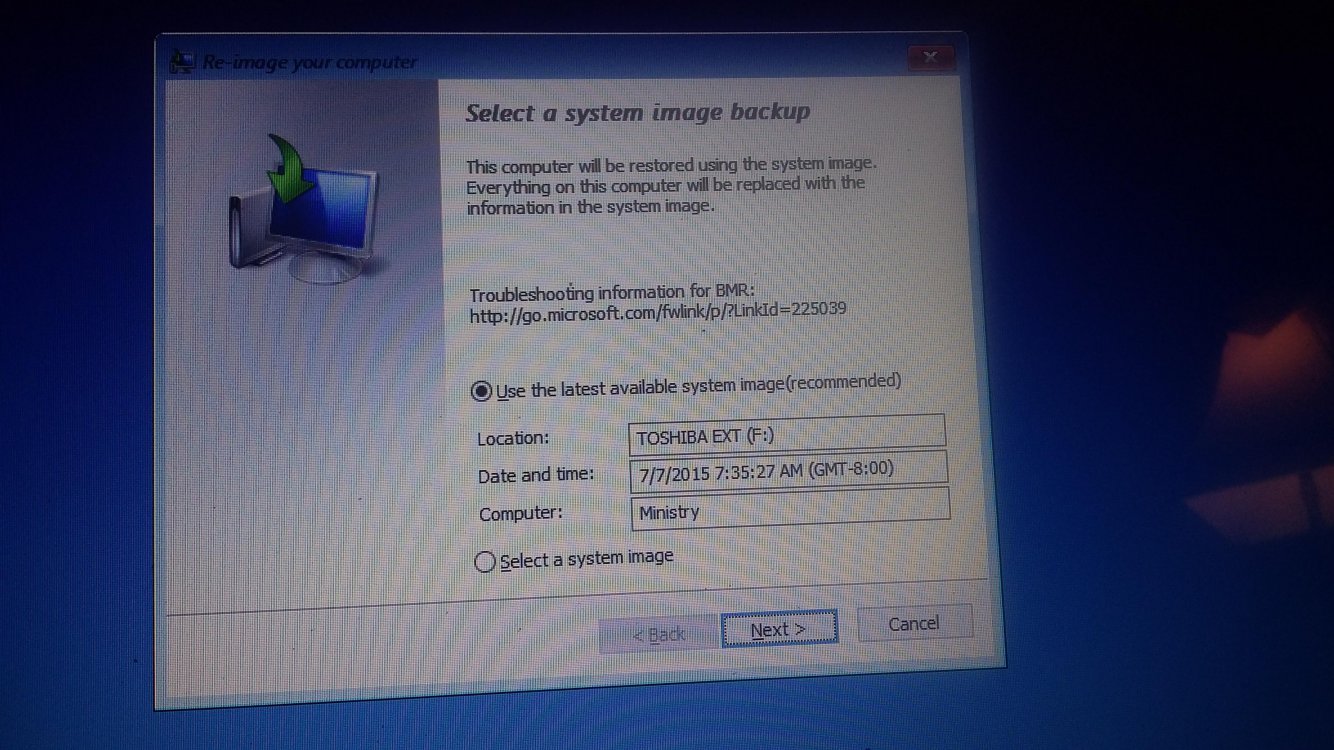

When it's asking for the recovery disk, does Windows give you the option to browse to your portable hard drive, and then where the WindowsImageBackup is located?
Here is a pic of what advanced options given to me. I clicked in System image Recovery step 1pic step 2 picture it reads external hard drive, I click it step 3 and it shows me the fallow pic. Then I am stuck and can go no further.:cry:
