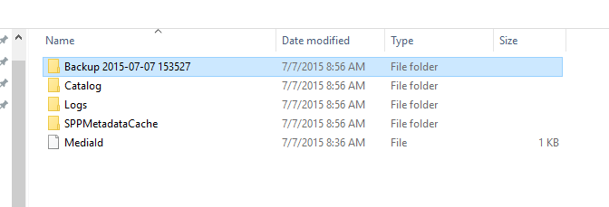

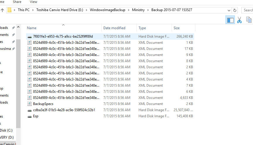

Hey I found the backup file in my external hard drive. I will post pictures I know this is this is the right one... Please have a look at it.

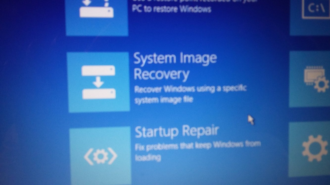

I watched them and tried once it was asking if I wanted to make a recovery before I could go forward when I went to do that with a flash drive it took me to bios I was not sure what to do from there. Any ideas?
Follow this guide to get into Advanced Options. Right click the Start Button, hold down the shift key, click on Restart. On the first screen click on Troubleshoot, on the second screen click on Advanced Options. On the third screen click on System Image Recovery. Then follow the on screen prompts.

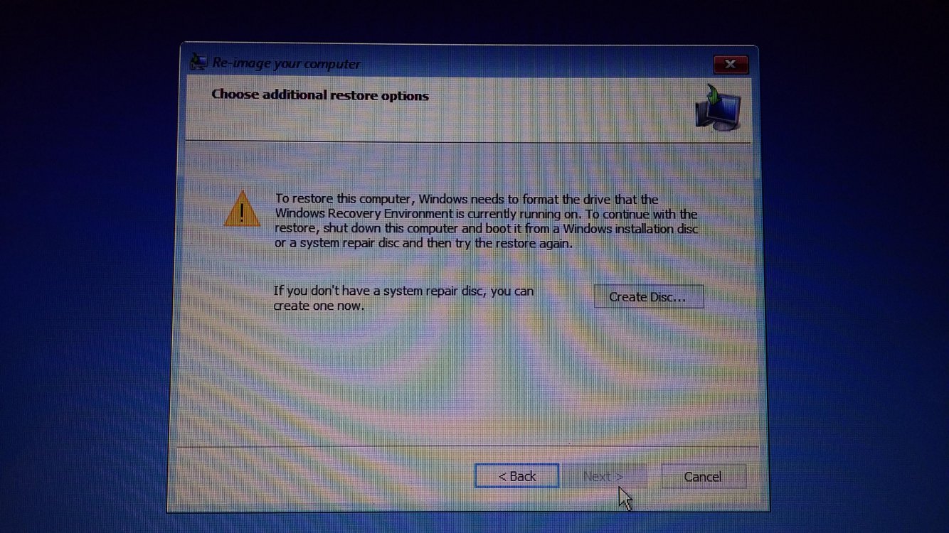

Yes I did that and that is when it did everything but then it told me I had to make some recovery. I will try it again and will take a picture to show you.
When I did the above this is what I got after I hit system image recovery, then it shows me my external drive I click on that it shows me to create a disc, When I clocked on creating this disc it would take me back to the first page when I started. Weird. Why can't things go smooth argh!:shock:

I've been searching the Internet for a solution to your problem. So far I have not come up with a solid answer. One person said he keep trying and eventually it worked. I'll keep searching but I think you should start a new thread with this new problem. Maybe someone will jump in with the answer.
I've been thinking about it and there is one thing you can try if your up to it. Since the oem recovery partition is trashed anyway, do a true clean install and then try the System Image Recovery again. Let me know if you want to try or just start a new thread.
