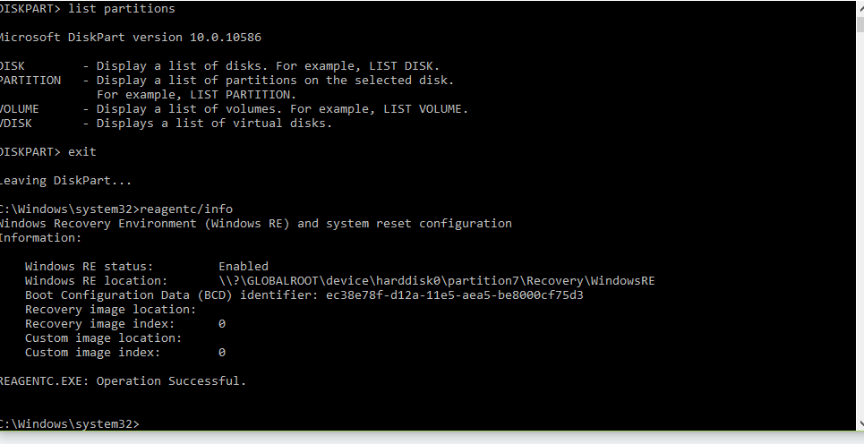

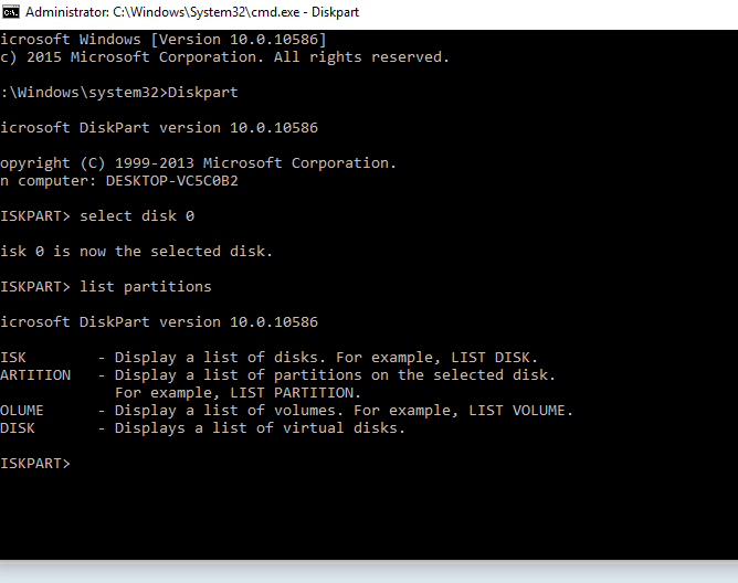

Since we can not see any of your partitions or files on those partitions - pictures would be helpful......
open command prompt(admin) and type
Diskpart
select disk 0
list partition
exit
reagentc /info
post pic of cmd windows

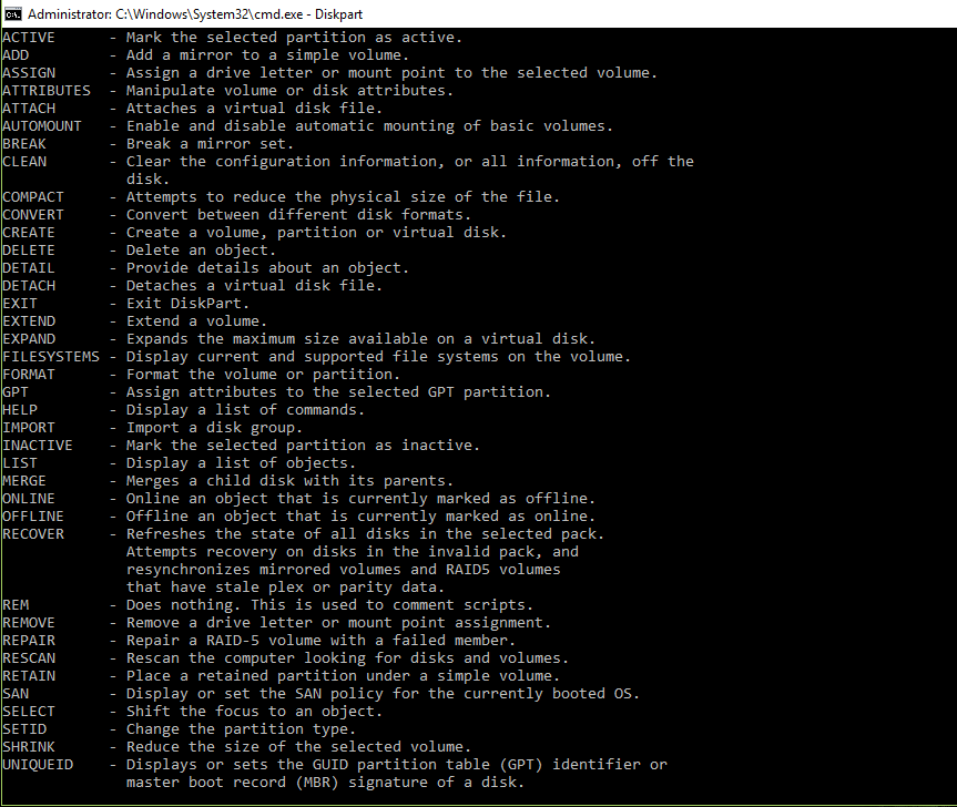

Okay my question is when I open the command prompt it does not show anything not even disk 0. Here I will send a picture.

The picture you posted shows you are at the Diskpart command prompt. Now at the Diskpart prompt type "select disk 0" without the quotes and hit the Enter key. It will say Disk 0 is now selected. At the prompt type "list partition" again without the quotes and hit the Enter key. It will list all the partitions on disk 0. Take a picture of the partitions on disk 0 for KYHI to look at. At the prompt type Exit and hit the Enter key. You will leave Diskpart and be back at the regular command prompt. At the regular command prompt type "reagentc /info" without the quotes and hit the Enter key. Take a picture of the information it returns. Post the pictures for KYHI.
I hope that helps.
Okay here is the first shot. Thanks for your help I was at a loss Trust me.:)

Okay O tried it again yikes I am not having luck with this thing. here is another picture.

Okay yea I go it. Here is the last picture you wanted. Again Thank you Trustme. "YOU ROCK!!":):)
