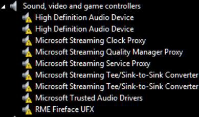

After the installation and reboot none of the drivers in 'sound, video and game controllers' were working! They were all there but they all had a yellow '?' sitting on them...
(I had more drivers than what the picture said. Two of my monitors had audio so they had drivers, plus I had a couple of virtual Midi cable programs which carry audio drivers.) Plus Realtek HD Audio driver...

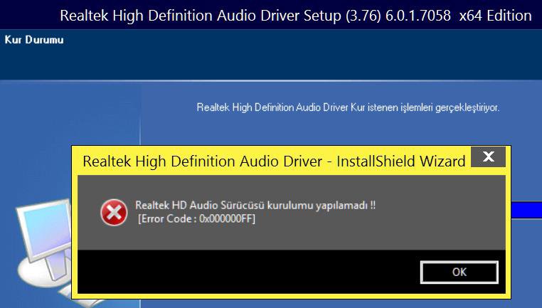

Realtek on the other hand came up with a new error code:
Realtek HD driver could not be Installed !! Error Code: 0x000000FF
(Realtek HD Audio Driver Setup 6.0.1.7058)

All the other Microsoft items disappeared from the Device Manager Sound and game controllers... Unlike the first picture above, this one has two drivers. Realtek High Definition Audio and High definition Audio Device... Which is suppose to disappear after a third party Audio driver installed. In this case Realtek.

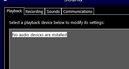

When you right click on speaker icon and select Troubleshoot Sound Problems and then when it says: "There is a problem with the driver 'High Definition Audio Device'. Reinstalling Audio Device might fix this problem." And of course it doesn't!
and this is the picture of my Audio Playback Devices...
Nothing to select!
