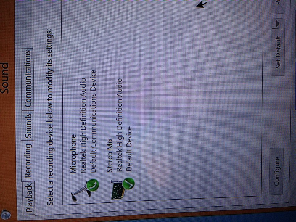

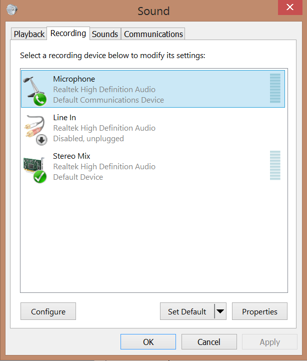

All of my drivers should be up to date - I built the computer less than 2 weeks ago - and I have enabled, displayed all of the potential input / output devices.

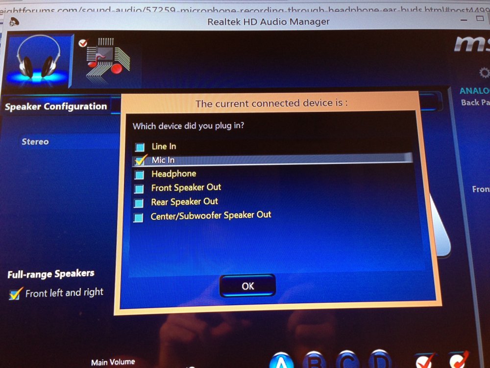

2. When my headphone/mic combo is plugged into the mic jack, the sound is limited to my monitor (which is connected to my GPU via HDMI). How do I set it up where I can listen to the voice chat through my headphones and the other sound through my monitor (e.g. when playing a game and on teamspeak)? I was able to set this up when my headphone/mic was plugged into the headphone jack, but not when plugged into the mic jack.

I wasn't able to find any other posts on the topic and would love any feedback you may have! Thank you in advance.

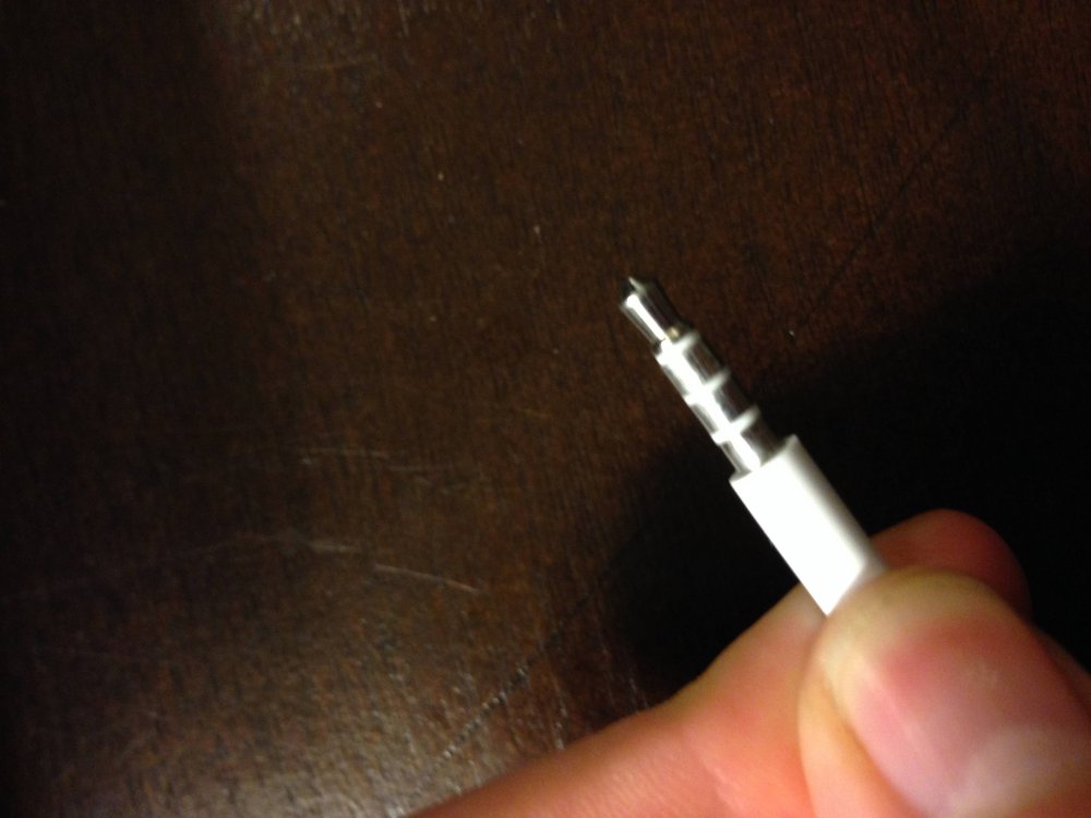

Which kind of connector is at the end of that earphone/mic combo. If it's one for phones and has 4 connections than it will not work right in computers, they need 3 connector 3.5 mm plugs. For PC you need earphone/ mic combo with 2 , 3.5mm plugs, one for microphone and one for earphones or an USB combo.

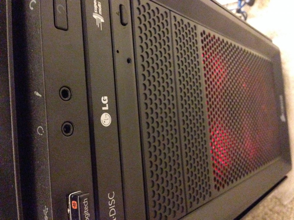

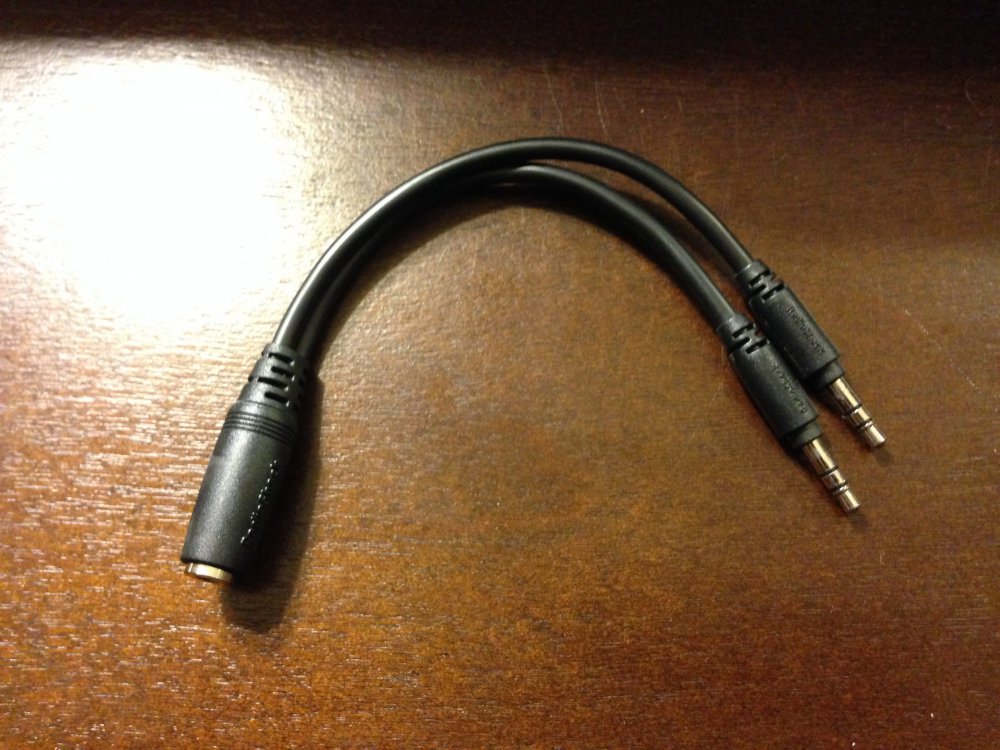

The end of the headphone/mic headset has 3 rings on the 3.5mm plug. Just went to radioshack and they recommend I use the adapter pictured below to plug the headset into both the headphone and mic jacks. That did not resolve the issue. Pictures of the headphone plug, headphone / mic jacks on the desktop case, and adapter:
As before, my computer recognizes the device, but doesn't allow me to speak through the headset.
Strangely, when I blow into the headphone's ear buds (not the mic hole on the headset), I can hear my breath through the monitor's speakers. Pushing the volume up/down buttons, which straddle the mic hole, also makes a clicking sound. However, speaking into the mic yields no result.
I'm assuming you mean the two male plugs on the adapter? If so, nothing happens. I've wiggled, rotated, and switched positions without a change in effect.
