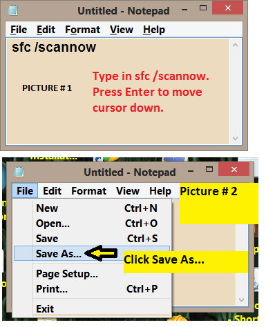

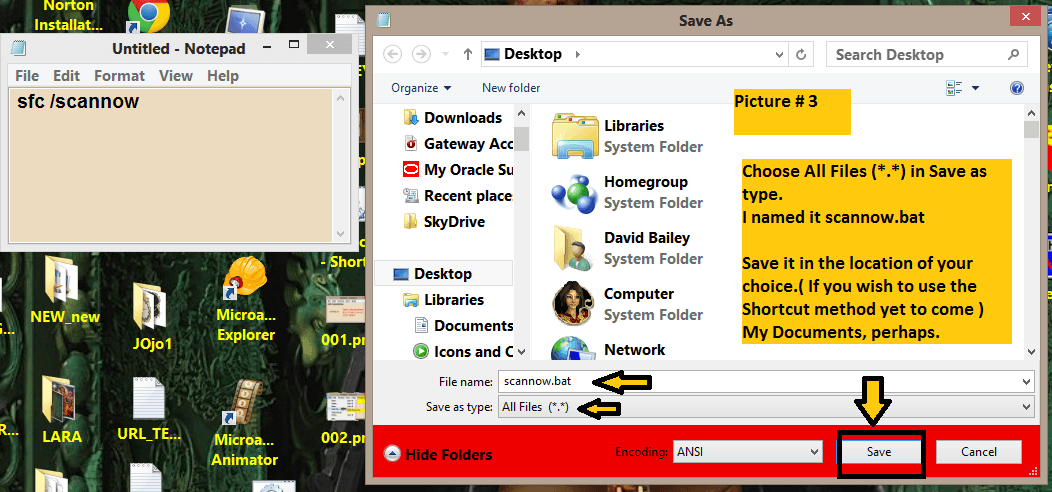

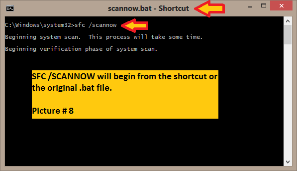

The following images show how to make a batch file for sfc /scannow that opens with one or two clicks:
They are numbered in the order of reading them.
I numbered them because they never show up in the proper order when attached. :(

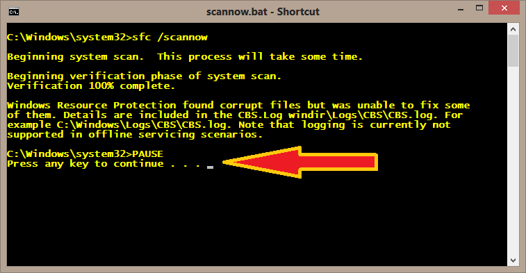

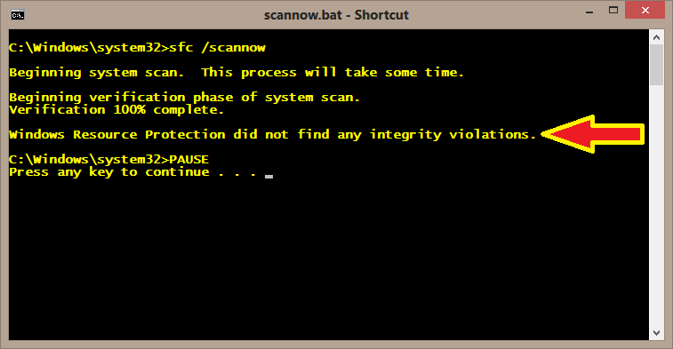

I added the PAUSE & it kept the window open.
It said to press any key to continue.
I pressed Space bar & the window closed. :)

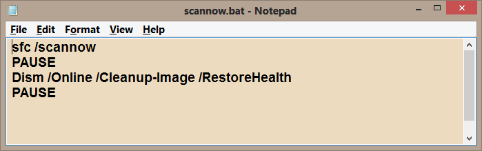

Added new Lines to .bat code
sfc /scannow
PAUSE
PAUSE

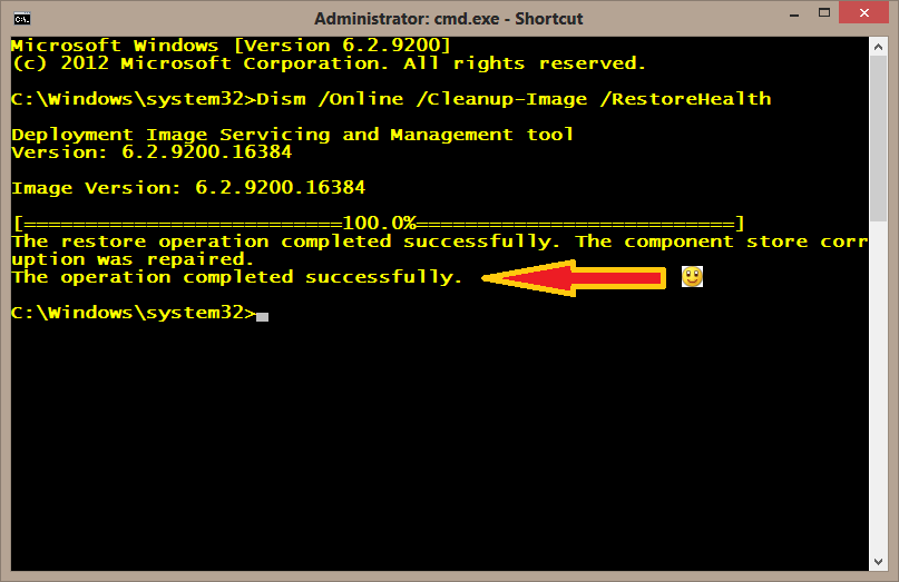

The DISM command actually fixes things SFC can't fix.
See picture:
Before running it, SFC found un-fixable problems.
After running it, All problems were fixed. :)
See picture:
If you run sfc /scannow as in the .bat file & see problems not fixed press any key & the DISM command will run & fix the problems. :)

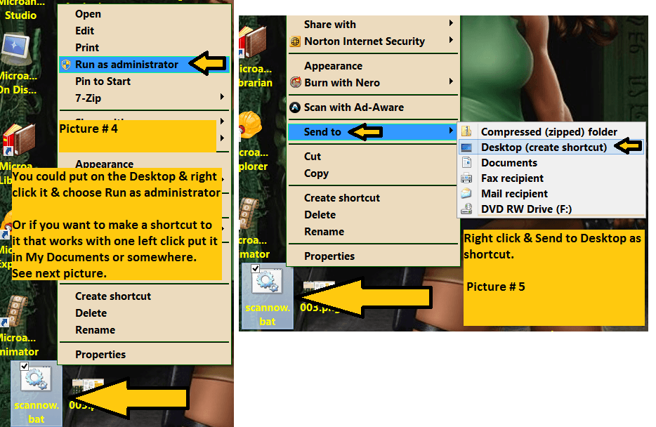

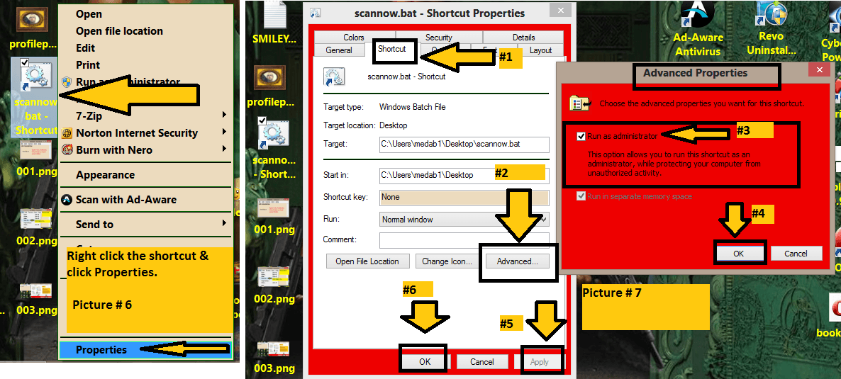

Yes, the same batch files will work in Win10 and Win11. Note that to use the SFC and DISM commands you need to run the batch file as an administrator. To make life simple I have put shortcuts to my batch files on the desktop, and have set their Advanced Properties to 'Run as administrator'.
It has (obviously) taken me time to get round to trying and replying. It worked so well right from the start that I can not imagine why I posted the question. But I CAN say that 'running it as administrator' makes ALL the difference.
