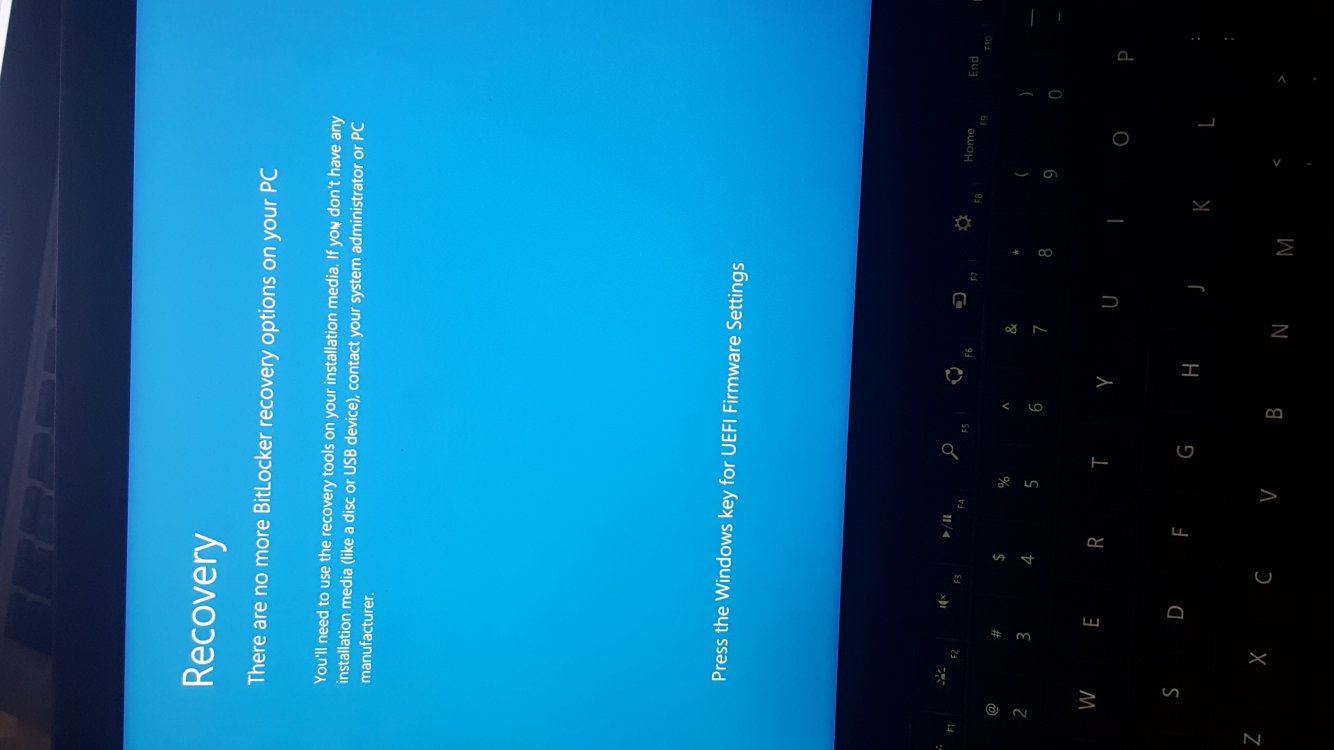

Thanks Ztrucker but that doesn't work either. When I turn on my SP3 - a blue screen comes up and says: "RECOVERY – there are no more Bitlocker recovery options on your PC"
I have tried making a bootable USB drive - and it won't book from it. I have tried to hold do the "volume up" button with the "power" button to enter BIOS but it still wont' boot from USB.
I think Bitlocker is missing and I can't do anythign at this point.

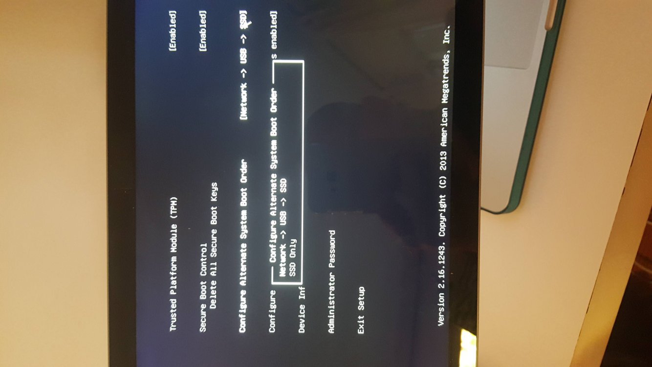

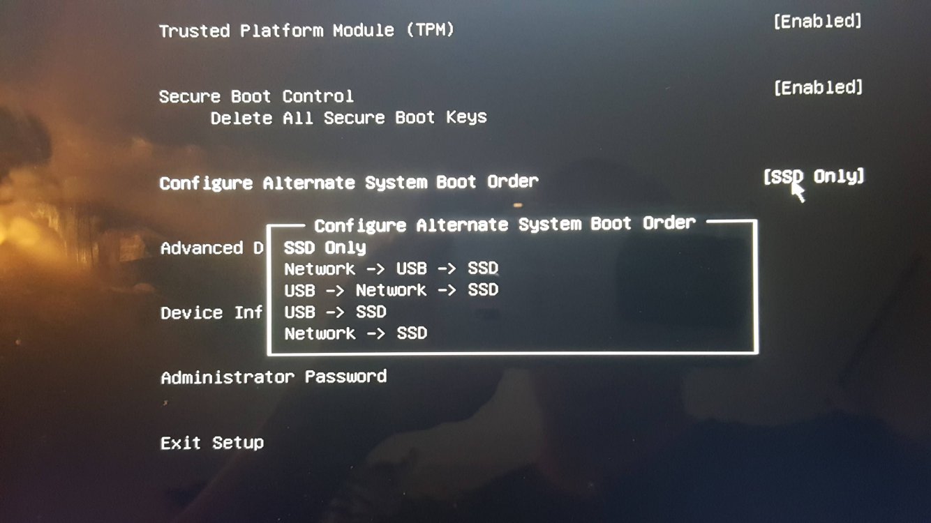

Thanks again Ztruker - I read that post too. I think the problem is Bitlocker. I have 2 other SP3s and I can get them to boot via USB. When I get into the BIOS, on either of my other 2, they have 4 options for booting - one of them being USB. When I try on my old work one, I only have the option to boot "Network>USB>SSD" or just "SSD".
I'm thinking it is Bitlocker that is keeping me from being able to boot in USB?

Thanks David. I went to a Microsoft store today and they didn't have any solution for me as to why the option for USB isn't available. See the 2 picture. One is from my everyday SP3, the other is from the work one. You'll notice the options are different. The blue screen is what it says when I power up the SP3.

I used a software called RUFUS to create the USB. I don't think it's a USB problem. It's the fact that the option to boot from USB is missing.
