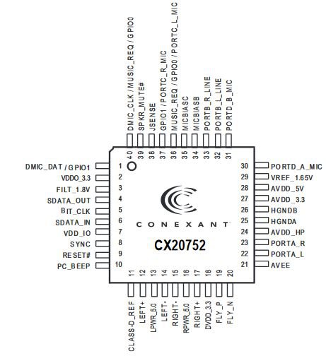

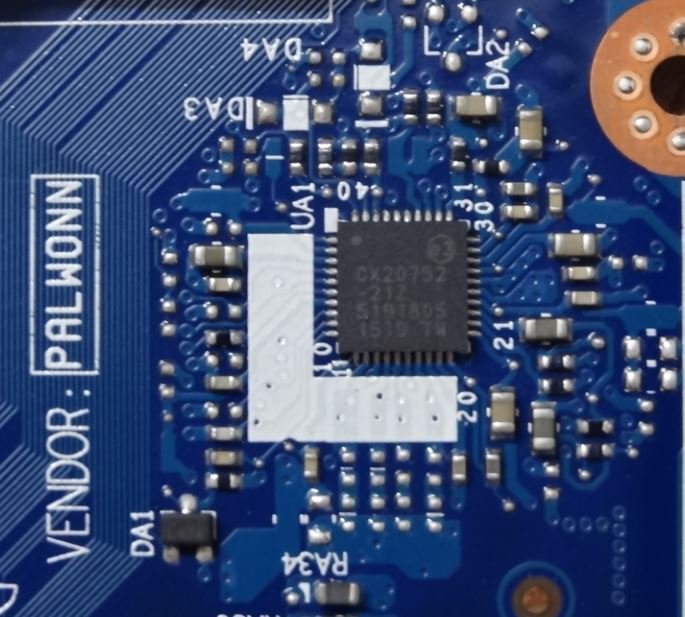

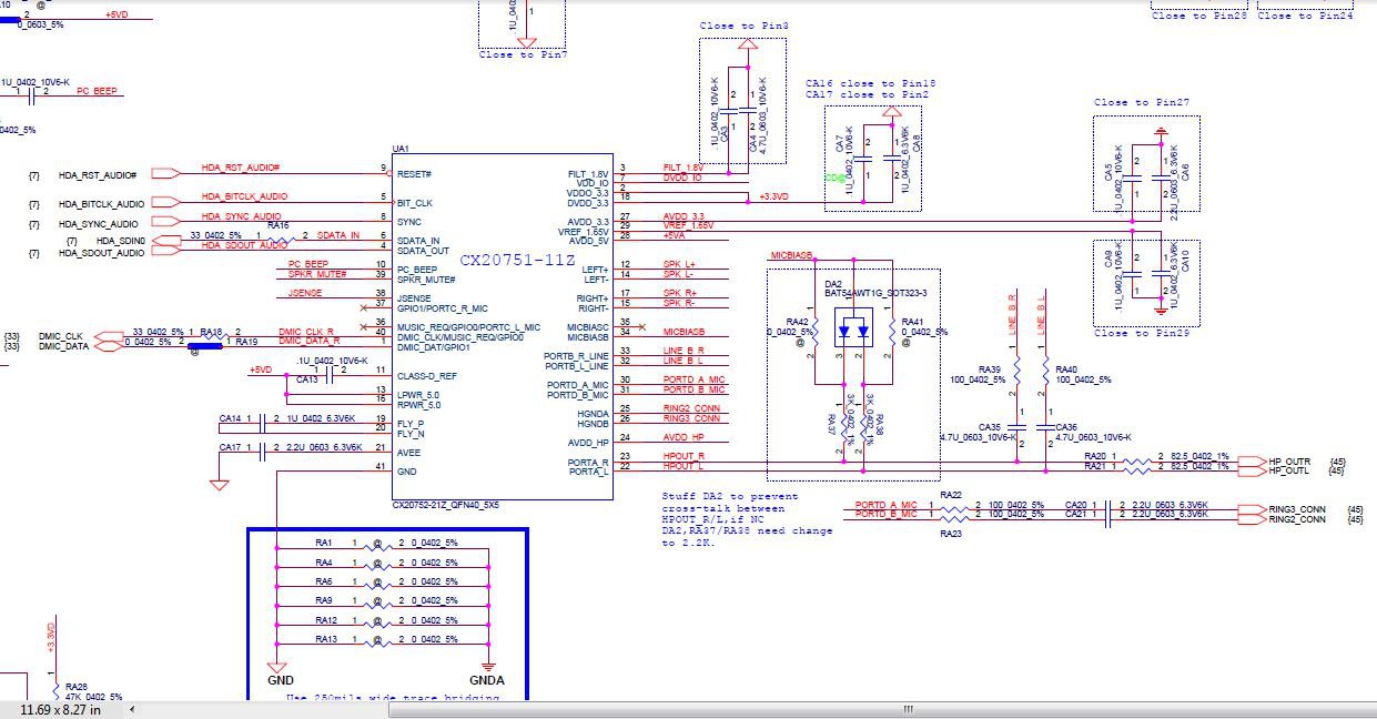

Lenovo G50-70 audio circuit board and schematics. Which components should be test? How do we test this audio chip?

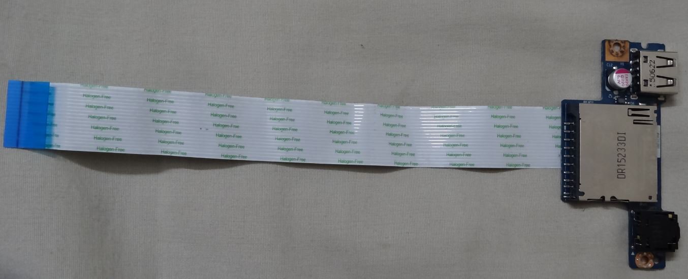

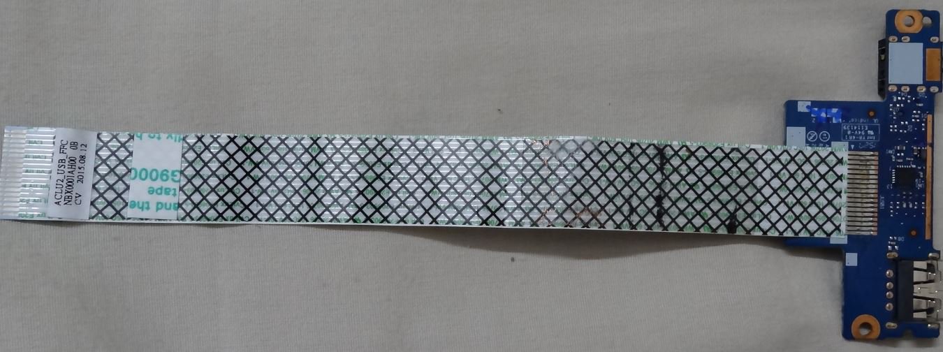

I think the fault is not with this port because i have tried with this Audio Port cable removed
I would think special test equipment is needed and at a minimum an oscilloscope. You could use the oscilloscope on Pins 23 and 24 to see if there is audio. However, that does not test the speakers or the circuitry (which could include the "small daughter board) which feeds the speakers and/or headphones. The schematics you have appear to be generic and not specific to your PC and how the output sound is actually routed. If there is audio on pins 22 and 23. Other than the use of a scope to check the output pins and possibly trace it through the PC I don't see much else you can test.

I did a search for the part number DR15233DI but did not come up with anything. On SOME (not all) laptops a small board such as that has the sound chip and if it were defective replacing the part will fix it. However, I can't find anything on that part so I can't say for sure if it is the sound chip and associated circuitry.
In its user's manual this small board is called usb and audio board. I think it may associate with vital parts of the audio system
Here this defected cx20752 IC display no symptoms in device manager and have no error report, windows cannot detect this dead IC except no sound. This was the problem that cause lots of confusions in troubleshooting and diagnosing.
