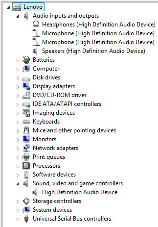

One other thing to try. Uninstall the Conexant sound AND uninstall the driver (in the Device Manager). Then restart the PC and Windows should detect and install the generic, basic function, High Definition Audio Codec (driver) if it can find it. If that works, then the hardware is OK and there is another problem.

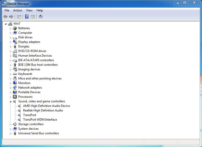

After you do that, post a screenshot of the Device Manager, Sound.... Section.
Screenshots and Files - Upload and Post in Eight Forums
Here is my Sound section, for example. (Disregard the Tranzport entries, that if for my recording studio) The AMD High Definition Audio Device is for an AMD Video Card HDMI audio. The Realtek in my case is my sound "card".
Windows installed the High Definition Audio drivers, so the sound "card" is being recognized by Windows.

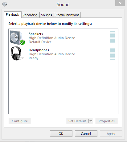

Go to the Sound Panel and verify "Speakers" are set as the default audio playback device.

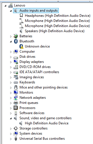

I see an Unknown Device under Bluetooth. I wonder if that is causing the problem. Disable the Bluetooth device (unknown device) and see if that allows speaker sound.

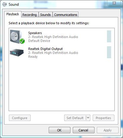

Here is my Sound, Playback Panel.
Speakers are setting as default playback device and i 've disabled unknown bluetooth device but getting same result. also why can't we install conexant audio driver here in this laptop?

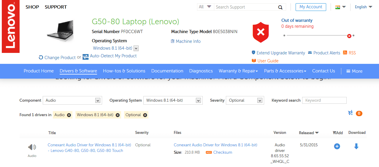

You should be able to install the Conexant driver from Lenovo (don't try other drivers). I linked you earlier to the drivers.

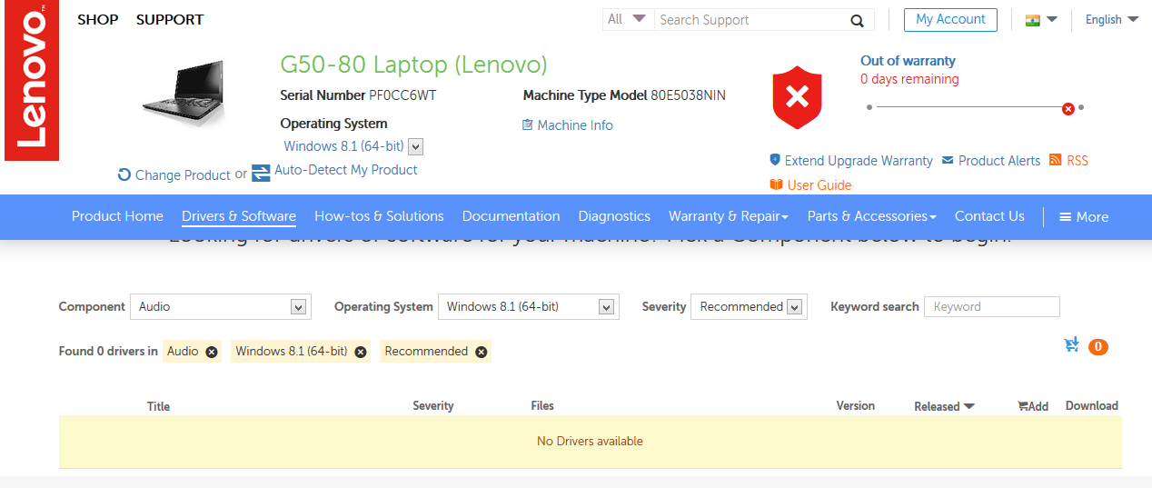

In the Lenovo support page "severity" option when "recommended" is selected no driver is available for Lenovo G50-80 but when selected "optional", one conexant driver appear which give device not found error while installing.
That appears to be the correct driver. I have to leave for a music playing job (I'm a musician) but I'll try to help more in the morning.

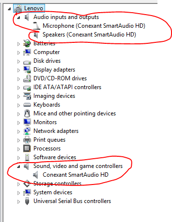

You are right conexant driver successfully installed but no sound again. Thank you very much fireberd. Have a great day
