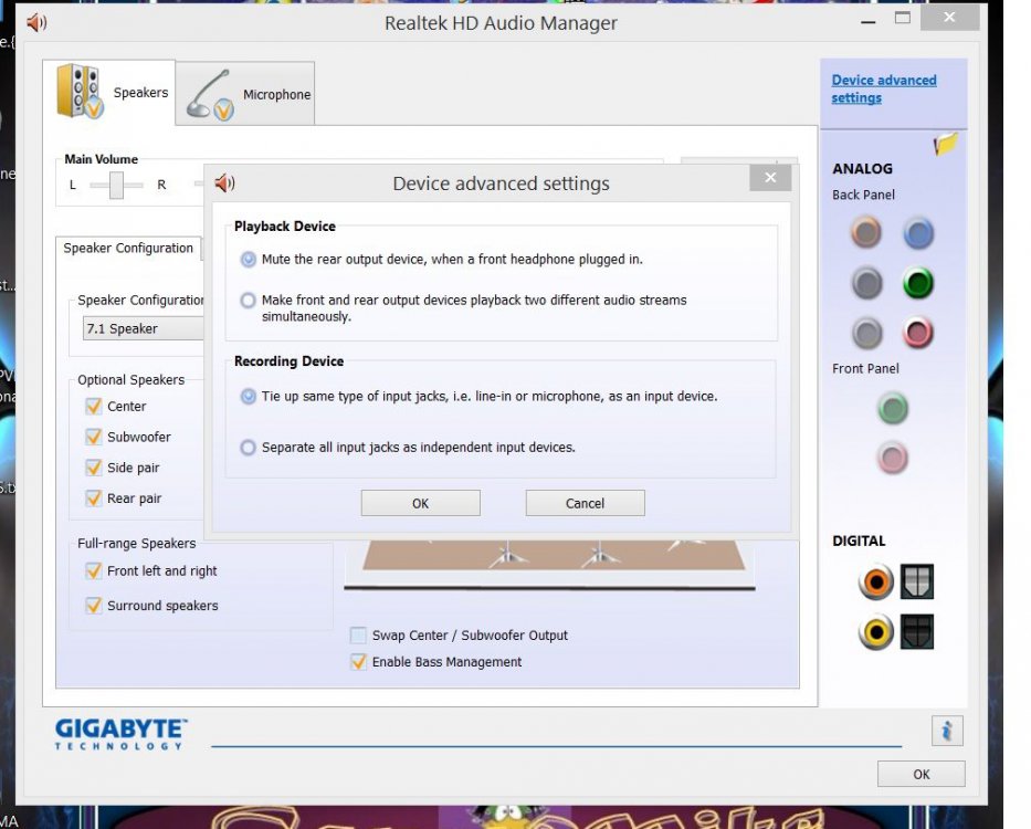

Now when you have Realtek drivers, check "Realtek HD Audio manager" in control panel. In top right corner, in blue letters should be "Device Advanced Settings" and try settings there.

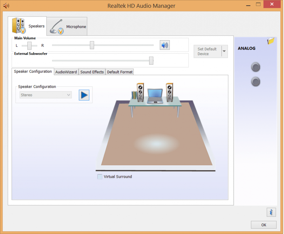

CountMike: I cant see what you are referring to... keep in mind I am now using the Classic View (generic) version of Realtek HD Audio Manager which was installed from the Realtek site as R2.75, so Im not using the Asus laptop specific version aanymore (which is dated 2013!).

Yes I see the blue icon that says "Realtek HD Audio Manager", but when I click it it opens it but my version does not have any Advanced Settings option or menu.

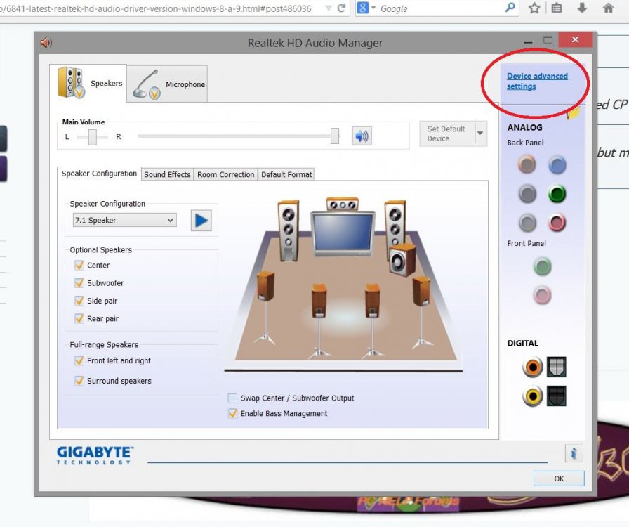

Blue letters underscored, it's not a tab.
Thanks for the screenshot. i dont have that and I notice your version is a Gigabyte version. I possibly had something similar when I was using my Asus specific version too but I needed to update the drivers to the generic ones in order to be able to just record from the external mic.
What are you able to do under the Advanced Settings? Can you take a screenshot of that please?

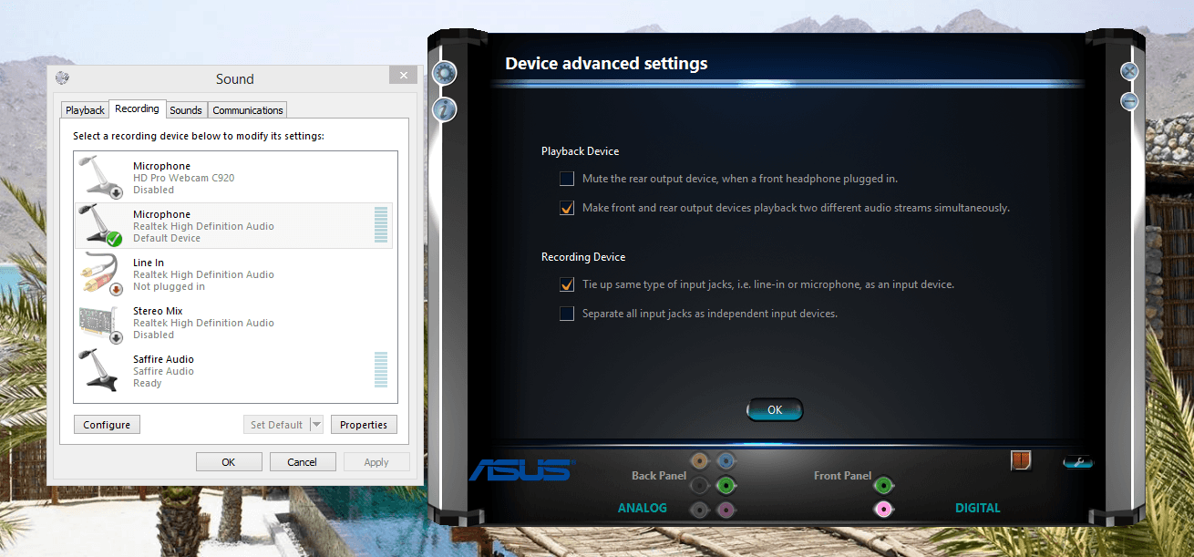

OK, now moving on the my desktop with ASUS motherboard. Able to record audio from my Rode SmartLav+ lapel mic when using the Rode SC3 adaptor, which converts it from TRRS to TRS so that it will work on dedicated mic input jack. (on my laptop the adaptor was not necessary...probably because it was a mic/phones combo jack..)
However, now on the desktop setup, I wonder why it is that even with "Mute rear output..." UNCHECKED, plugging headphones in the front panel still kills the audio being routed to the speakers connected to the rear panel?
Even with these settings, the moment I connect headphones to the front phones jack, the speakers connected to the rear output get muted.

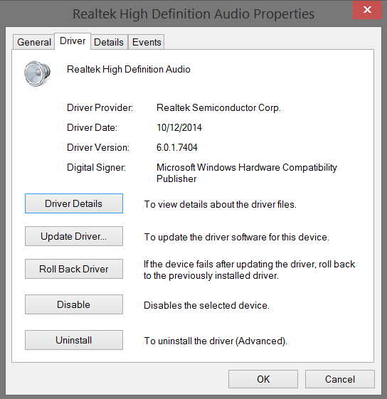

I currently have 6.0.1.7404

Hmmmm.... now I'm even more confused.... the link I speak of is at the beginning of this sticky thread by Brink and the driver version is the same format as the one I have showing in my Device manager->Sound-> Realtek HD Audio->properties->Driver
No mention of R2.75.
