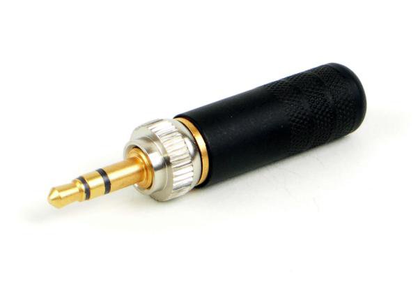

What type of plug does the Samsung have? Is it the tip ring ring sleeve type? (see picture below).
(I deal with audio but on a different level as I have a recording studio and don't use the PC sound).
Hey fireberd, both devices tested (the Samsung headset AND the SmartLav+ mic) use TRRS connectors (like your image). They both record well without the use of an adaptor. Its just that when the mic only is plugged in, the laptop shuts off the built-in speakers to route the audio to "nowhere"... and when I have the opportunity to hear the audio thru earbuds of the Samsung smartphone headset, the laptop suddenly decides to leave on the built-in speakers instead of routing the audio to the headset. :(
If I may, most stereo headsets, speakers and earbuds use the Tip Ring Sleeve arrangement but they can screw up the Tip Ring Ring Sleeve rig as the Ring and longer Sleeve on the plug messes up the contacts inside the TRRS socket, simply the different ways the two are made. Compare this image with the other one posted:
Berton, I'm not sure how this helps me solve the issue... I have an adaptor which converts TRRS to TSR but its not needed in order for me to record successfully from either of my 2 options. In fact, it makes things worse in one case. As mentioned, the problem is with Playback. Laptop is disabling internal speakers when external lapel mic is connected, and is keeping them enabled when headset with mic is connected!
