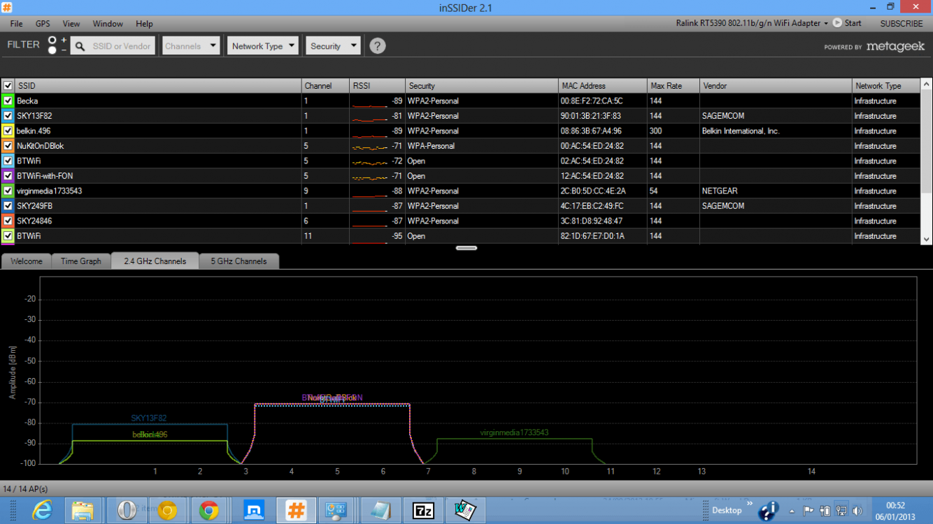

With loads of auto-channel hopping routers all around in the urban streets near me, there can be a game of chase going on where you only get to stay on the least populated channel for a few seconds. I select a fixed channel firmly in the middle (channel 5) with my BT Home Hub 3, and have the BTwifi and the BTwifi-with-FON services opted in. That way, my neighbours wireless routers see my 3 SSIDs and 3 MAC addresses on Channel 5, and thus tend to auto select channels 1, 9, or 13, leaving channel 5 alone.
I also find that WPA personal, rather than WPA2 + WPA personal encryption gives a better signal range with Windows 8. Windows 8 on the same hardware seems less sensitive, but more stable than Windows 7.

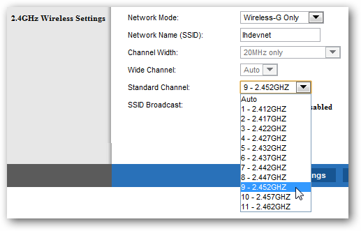

In 2.4GHZ wireless settings, There's an offset of .005 in frequency range between channels so you need to set your router channel that is different from other devices in your home, for example: you might have a 2.4GHZ cordless phone or your neighbor might have set their router to the same channel, therefore interference will occur between devices. Here's a picture showing each channel and their associated frequencies.
To determine what channel to set for, download inSSIDer – Discover The Wi-Fi Around You | MetaGeek to find out all the channels being used by other devices then set your router channel accordingly.
