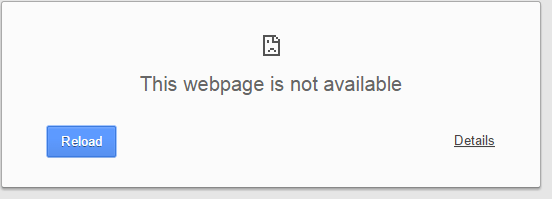

It occurs at very random times and I don't really notice a "trigger" that starts it to happen. I've taken screenshots and will post them below:
^ This is what I sometimes get when I try to load websites.

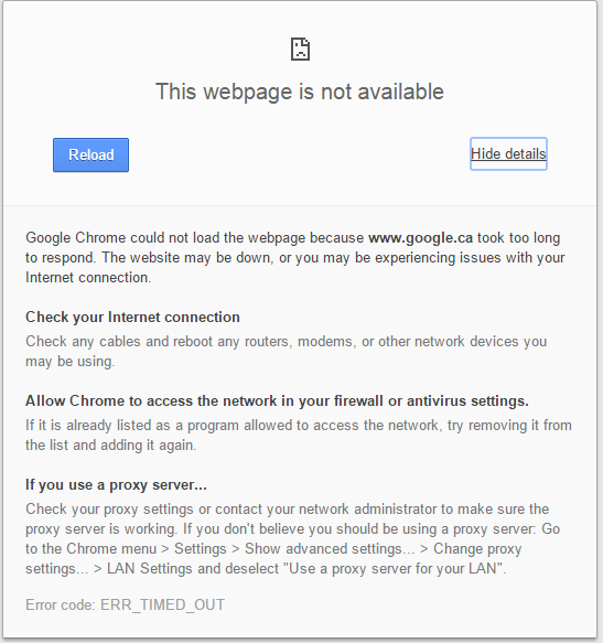

Opening up the details get me this:

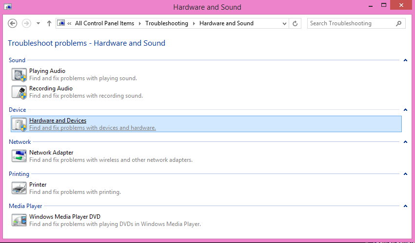

I open up the troubleshooting tool and diagnose every option. Once I get to Hardware and Devices

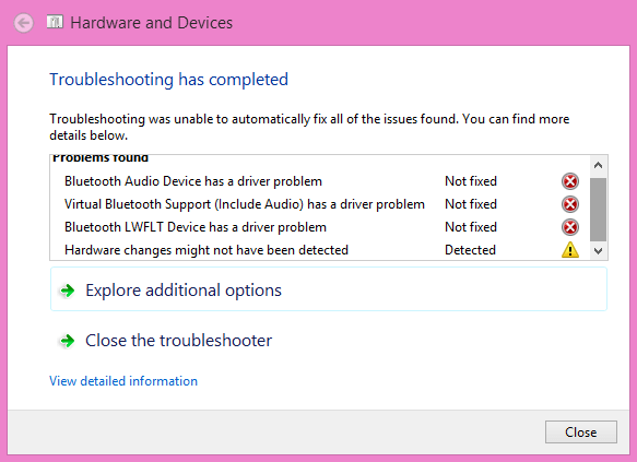

I get this window
I've tried the DISM /Online /Cleanup-Image /Scanhealth thingy but it found nothing.
sfc scannnow didn't find anything either...

Looks like you've got some driver issues to sort out. Try that first and then come back if the problem doesn't go away.
