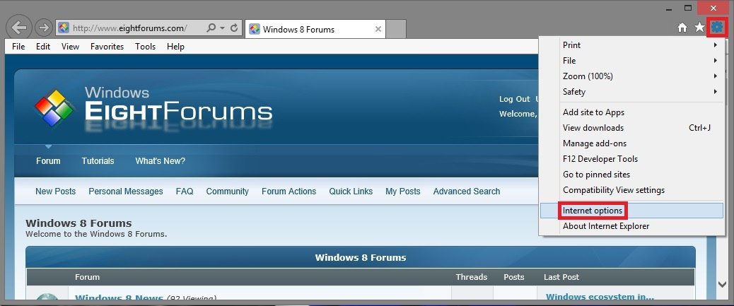

1. Do step 2 or 3 below for how you would like to open Internet Options.​
2. Open the Control Panel (icons view) in Windows 7 or Windows 8, click/tap on the Internet Options icon, and go to step 4 below.​
3. Open Internet Explorer (for desktop in Windows 8), click/tap on the Tools Tools.jpg button, click/tap on Internet options, and go to step 4 below. (see screenshot below)​

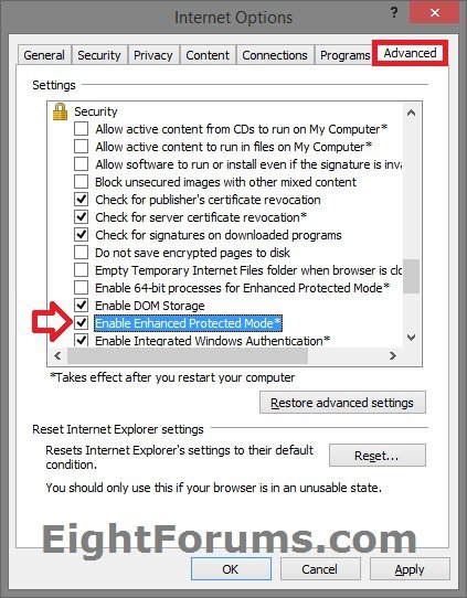

5. To Turn On Enhanced Protected Mode in your IE10 or IE11
A) In the Advanced tab, check the Enable Enhanced Protected Mode box under Security, and go to step 7 below. (see screenshot below step 7)​
6. To Turn Off Enhanced Protected Mode in your IE10 or IE11
A) In the Advanced tab, uncheck the Enable Enhanced Protected Mode box under Security, and go to step 7 below. (see screenshot below step 7)​
7. Click/tap on OK, and restart the PC to apply.​
