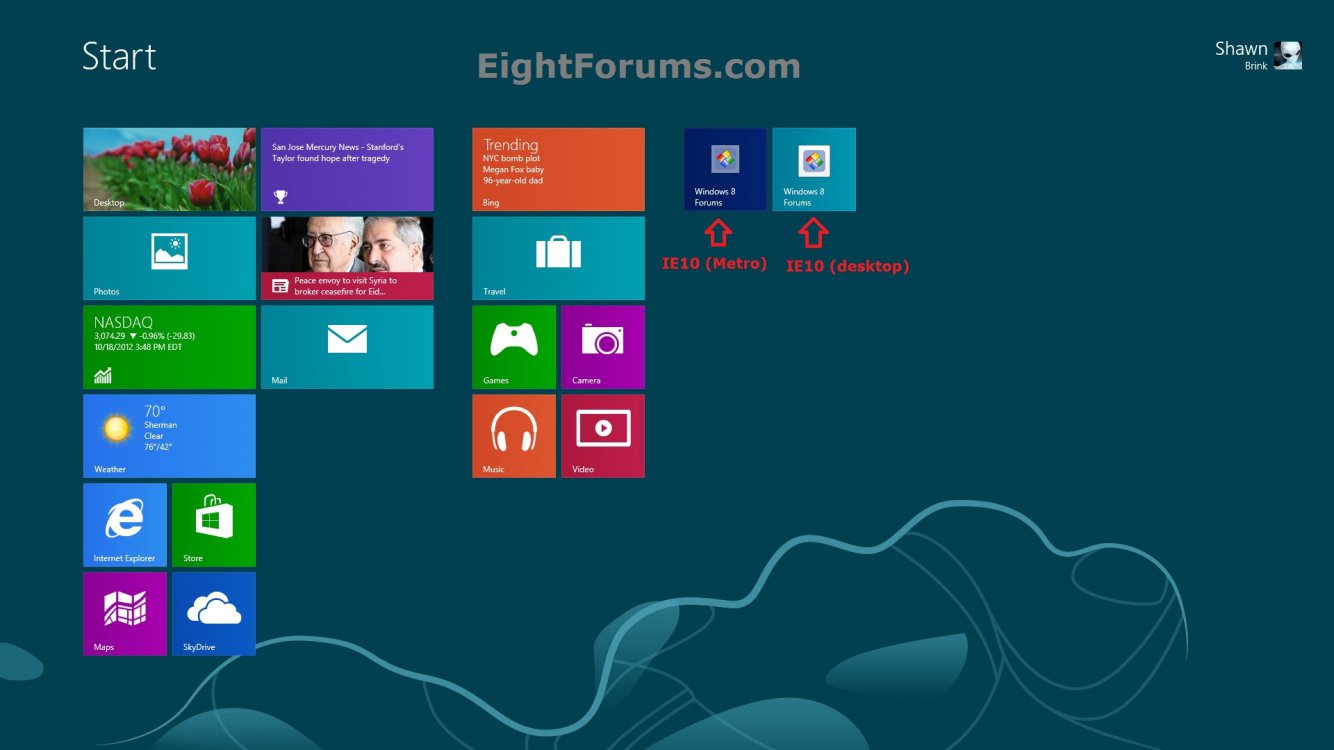

EXAMPLE: Pinned Site on Start in Windows 8

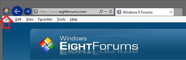

To Pin Site to Start in Desktop IE10
When you open a pinned site tile on the Start screen that was pinned from the desktop IE10, desktop IE10 will open with that pinned site set as it's home page. You will also notice a home button for the pinned site to the left of the back and forward arrows at the top left in desktop IE10.
This does not apply to the modern IE10.
1. While in the IE10 version from the desktop, open/go to the website that you would like to pin to Start as a tile.​

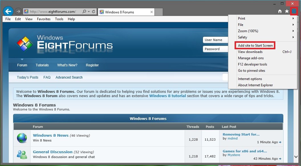

2. Click/tap on the Tools (gear) button on the command bar, and click\tap on Add site to Start Screen. (see screenshot below)​

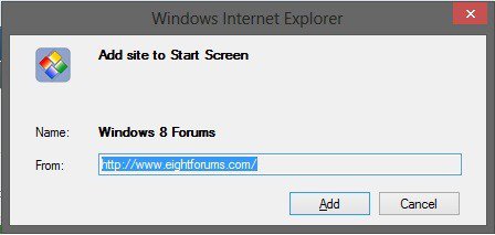

3. Click/tap on Add. (see screenshot below)​

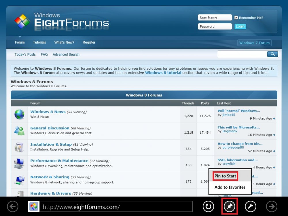

5. In modern IE10, click/tap on the Pin site (push pin) button to the right of the address bar, click/tap on Pin to Start, and go to step 8 below. (see screenshot below)​

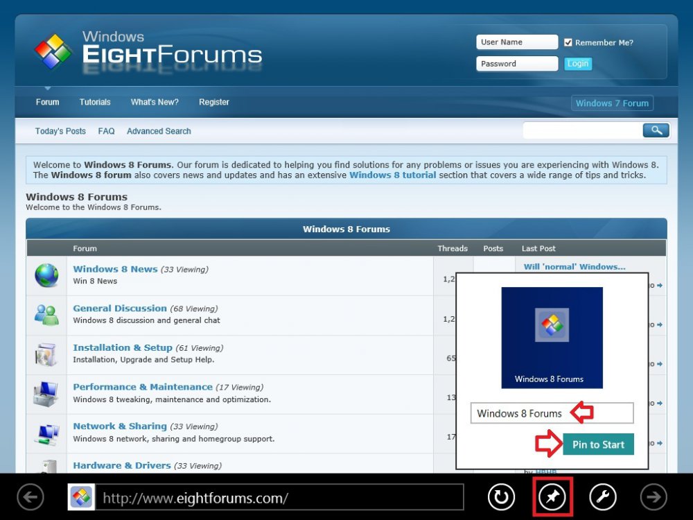

6. Type in a name you want for the tile, and click/tap on Pin to Start. (see screenshot below)​

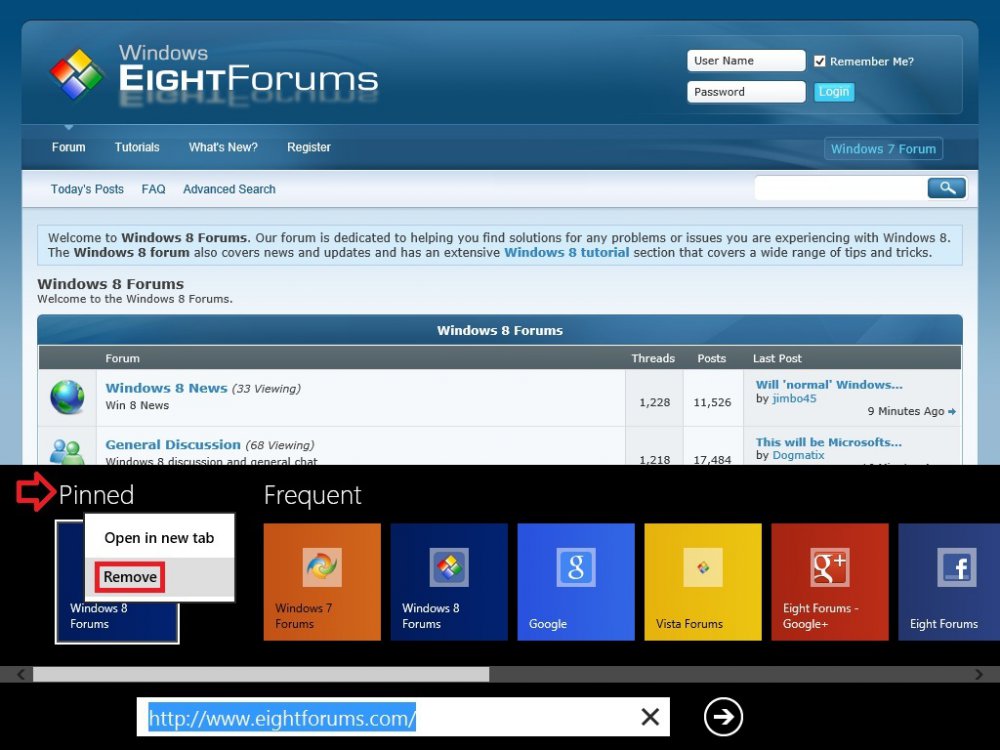

6. From here, scroll left and right until you see the Pinned site that you want to remove, right click or swipe down on the pinned site, and click/tap on Remove. (see screenshot below)​

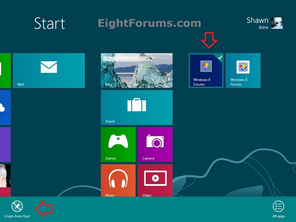

To Unpin IE10 Site from Start Screen
1. While on the Start screen, right click or swipe down on a single pinned site that you want to remove to check it, then click/tap on Unpin from Start in the apps options bar at the bottom. (see screenshot below)​
NOTE: You could press the Windows key to return to the Start screen if not already on it.​
