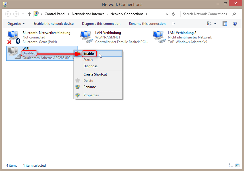

1.1 Enable WLAN:​

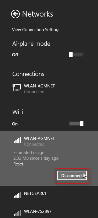

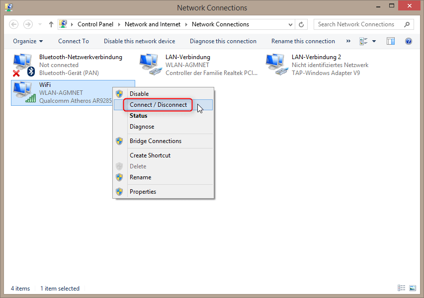

1.2 Disconnect WLAN from a WiFi network:​

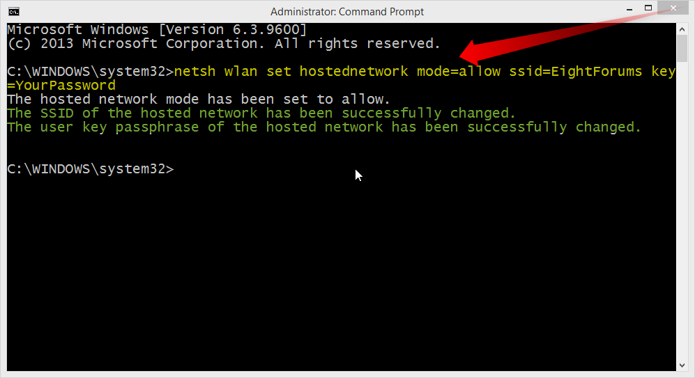

2.2 Type the following command to create a virtual WLAN network (HotSpot), hit Enter:​
netsh wlan set hostednetwork mode=allow [COLOR=#ff0000][B]ssid=EightForums[/B][/COLOR] [COLOR=#008000][B]key=YourPassword[/B][/COLOR]
(SSID = give your HotSpot any name you want to, KEY = give the HotSpot any pre-shared key (password) you want to.)​

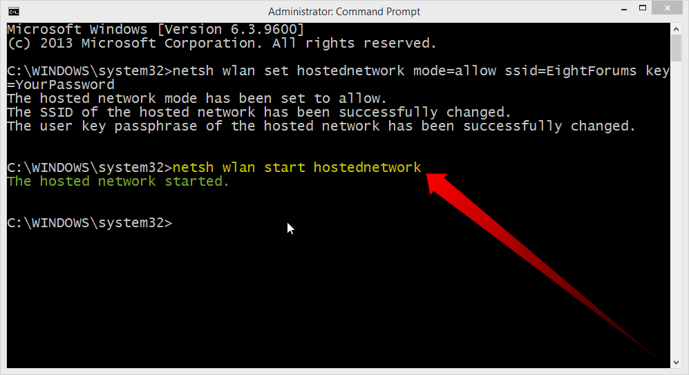

2.3 Still in elevated Command Prompt, start the HotSpot by giving the following command:​
netsh wlan start hostednetwork

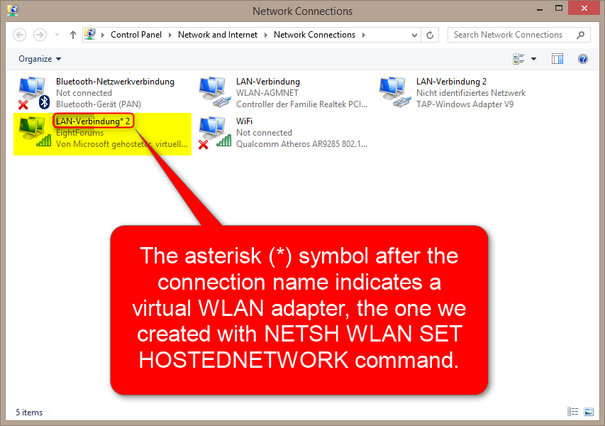

2.4 Network Connections will now show a new virtual connection and that it is already connected to the HotSpot we created, in this case the "EightForums":​

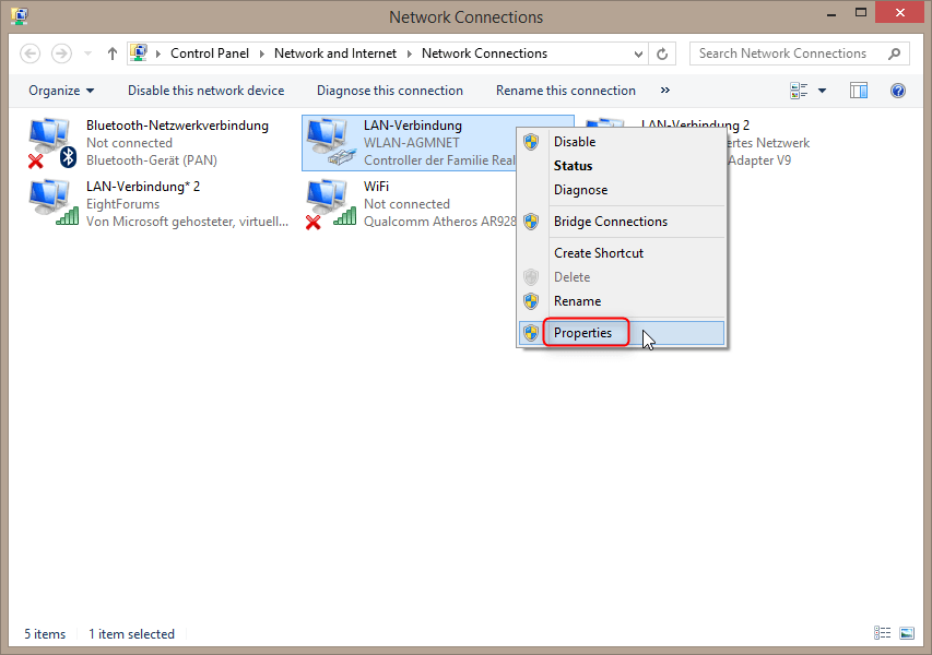

3.1 Right click your actual working ETHERNET (LAN) connection, select Properties:​

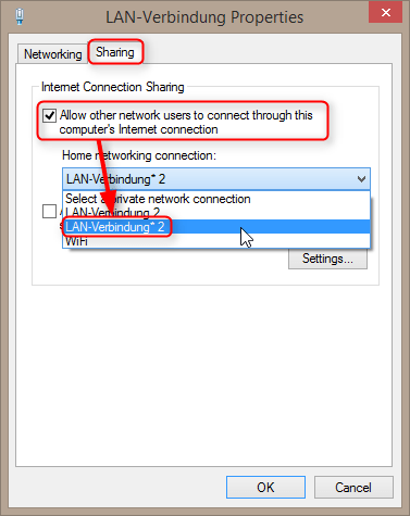

3.2 On Sharing tab select Allow other network users to connect through this computer's Internet connection, select your virtual network connection from the drop down list, click OK to save settings:​

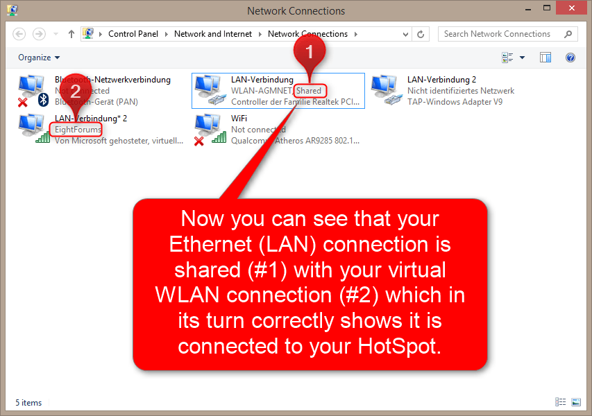

3.3 Done! Your HotSpot is now online:​

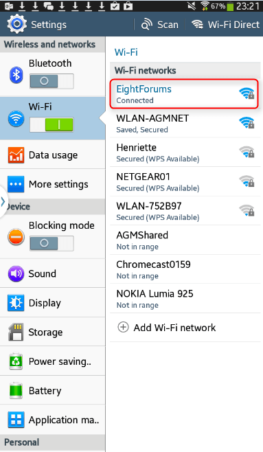

3.4 You can connect your other WiFi devices to your HotSpot and start surfing. In this example I have connected an Android device to my HotSpot:​

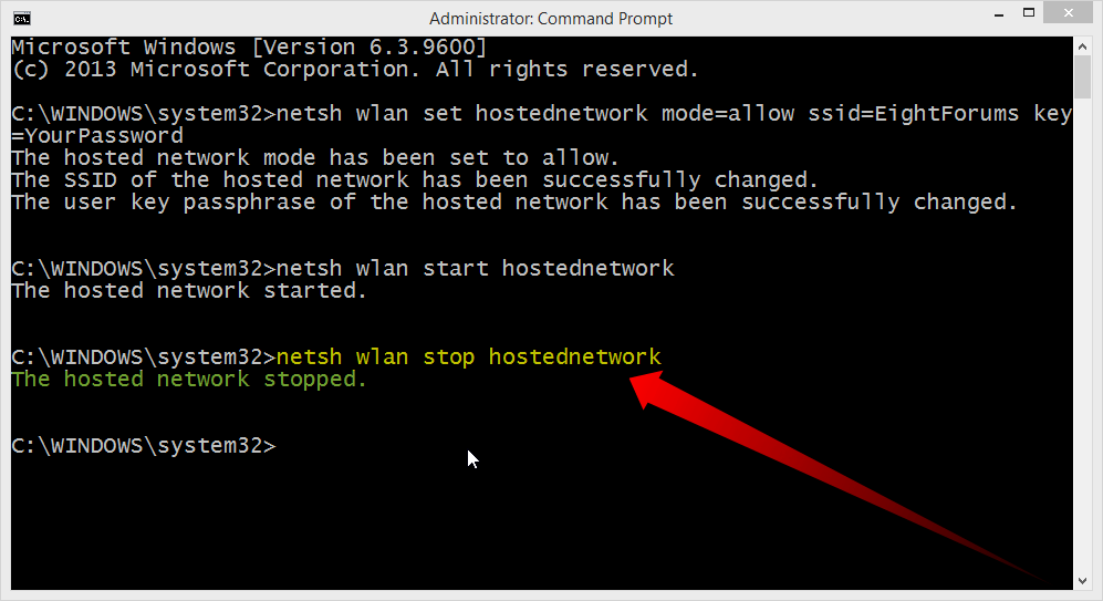

STEP 4: Turn Off the HotSpot
4.1 Open an elevated Command Prompt, give the following command:​
netsh wlan stop hostednetwork
4.2 Turning the computer off or rebooting also turns the HotSpot off. However, the HotSpot still exists (it "survives" the reboot); from now on you only need to turn it on when needed with the netsh wlan start hostednetwork command.​

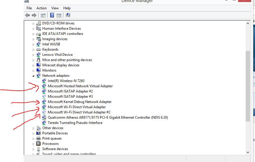

I guess I could just click uninstall on the Network wifi in question.. here..
Notice they aren't actually gone, just stopped or disabled..
1. Know what the other ones are?

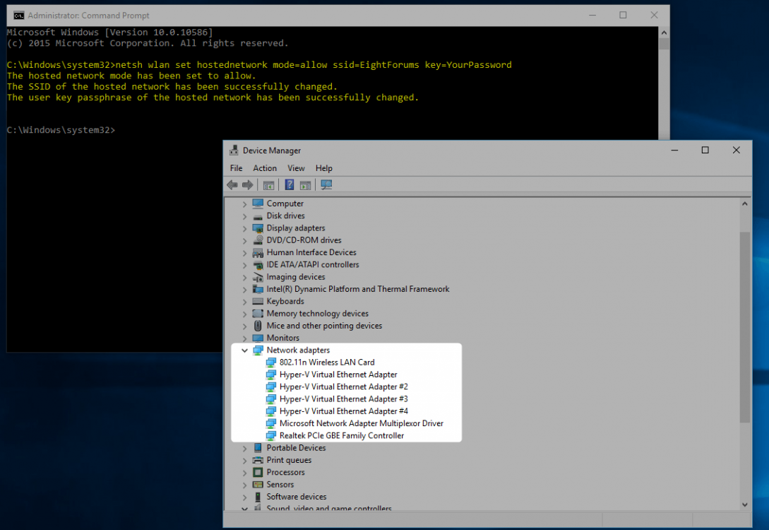

I am a bit confused... What tutorial are you referring to?
Sharing the wireless connection as told in this tutorial does not create any virtual devices. In screenshot below you see me creating a wireless hot-spot following instructions in this tutorial, then checking the Device Manager; no new virtual devices created, no need to remove anything:
(Click to enlarge.)​

but anyway, I thought creating a hotspot and your commands in Command prompt create a virtual Network adapter.. that's how it shares and others connect.. or so I thought..
Well, if that is not the case, I need to find out what my "virtual adapters" are and why I have a "virtual hosted network adapter" then..
