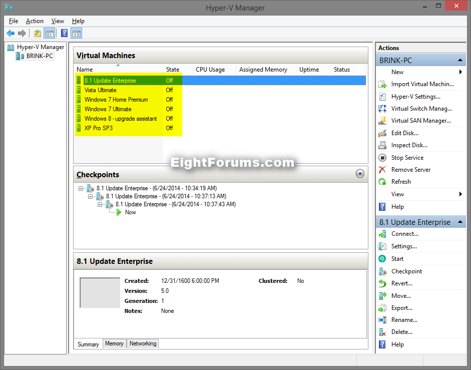

EXAMPLE: Hyper-V Manager
NOTE: The virtual machine names are listed under Virtual Machines at the top in the middle pane.

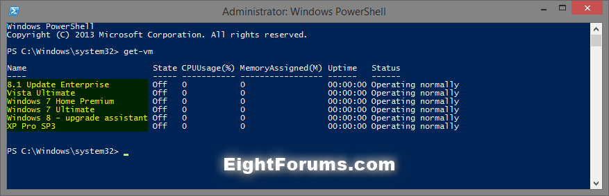

3. In the elevated PowerShell, type get-vm, and press Enter to see a list of all Hyper-V virtual machine (VM) names on the host PC. Make note of the VM's name (ex: 8.1 Update Enterprise) you want to completely delete. (see screenshot below)

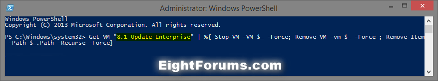

4. In the elevated PowerShell, type the command below, and press Enter. (see screenshot below)
Get-VM "[COLOR=#ff0000][B]VM Name[/B][/COLOR]" | %{ Stop-VM -VM $_ -Force; Remove-VM -vm $_ -Force ; Remove-Item -Path $_.Path -Recurse -Force}
Substitute VM Name in the command above with the actual name of the VM from step 2 above.
For example:
Get-VM "8.1 Update Enterprise" | %{ Stop-VM -VM $_ -Force; Remove-VM -vm $_ -Force ; Remove-Item -Path $_.Path -Recurse -Force}

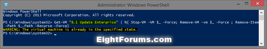

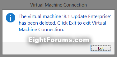

5. If the Hyper-V VM is currently running, then click/tap on Exit when prompted, and go to step 7 below. (see screenshot below)

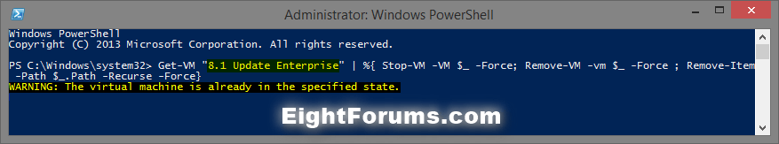

6. If the Hyper-V VM is not currently running, then you will see the WARNING: The Virtual machine is already in the specified state message just to let you know. There's nothing that needs to be done. (see screenshot below)

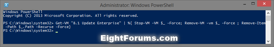

7. When you see the PS C:\Windows\system32> prompt return, the VM has finished being completely deleted. (see screenshots below)
NOTE: This could take a little while to finish.
