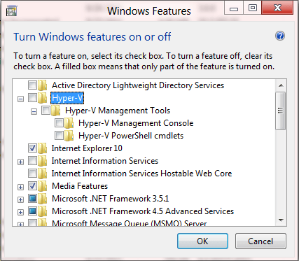

The first thing we need to do is to enable the Hyper-V components. To do this, we need to turn them on.
Open Windows Features. Provide Administrative credentials if prompted by UAC.
Expand the Hyper-V sub-section and ensure that all options are checked (ticked) as shown below. Click on OK and restart your computer to apply changes.
If all options remain checked after a reboot, and you haven't received any error messages, then you are good to go. Continue with the next section, Here's How:. If not, then I'm sorry but your system doesn't support this feature.

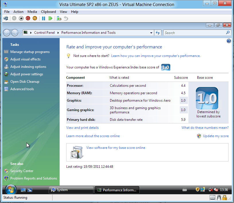

Here it is. Windows Vista SP2 x86 running as a Hyper-V guest OS.
At the moment, there is no network connectivity and no audio. Graphics is just generic. But it is running. I'll see what I can do as regards these functionality problems, but in the meantime if anyone can come up with any answers it would be appreciated.

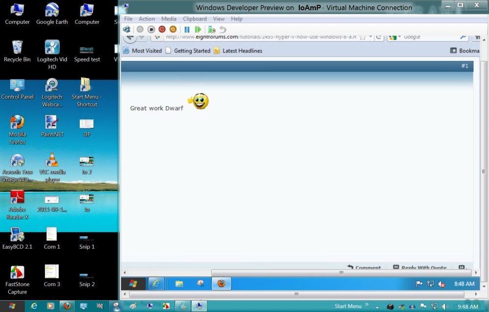

Dwarf I have established a working network connection in the Hyper V Windows 8 Virtual Machine and host. Note that the network Icons are both connected and the time is different on each task bar in the snip and this thread is also visible from the Hyper V VM .

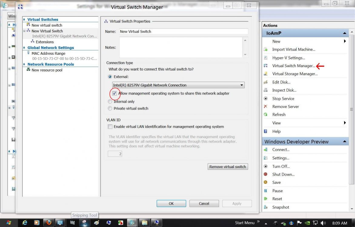

It's hard to explain really but I took snips of my working settings and will explain as best I can and have a wired connection.
First I set my virtual switch in the Virtual Switch Manager (note: check mark and arrow)

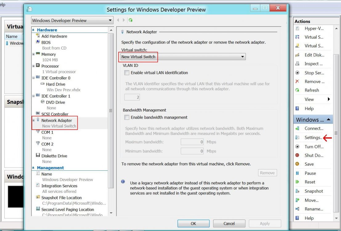

Second in the developer preview section under settings I un-checked the VLAN ID box below "New Virtual Switch"

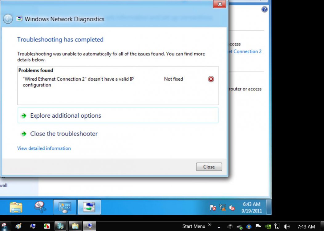

After making these settings and still having no connection I diagnosed the connection in network and sharing center and ran the network troubleshooter and the message below appeared which was solved by renewing my IP address by disconnecting the power and ethernet cables from the modem for 10 seconds then reconnecting. Note it took an few tries before this worked and you will have to wait a few minutes before the network is identified after renewing IP Address.

Your Hyper-V settings are the same as mine, but I still don't get the connection with Windows Vista SP2 x64. Let me try a different OS and report back.
Maybe I just got lucky as there was a lot of trial and error involved, like you I had the same settings before and still did not have a connection but just kept repeating the process until somehow I was successful.

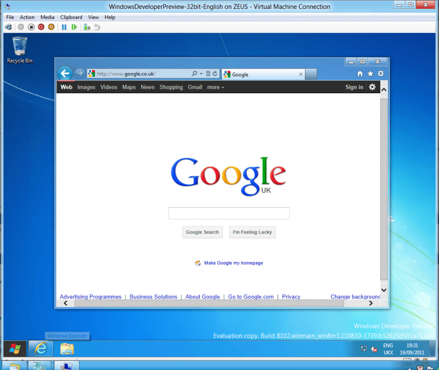

I've just installed the WindowsDeveloperPreview-32bit-English as a VM using exactly the same settings as in the Tutorial, and I got network connectivity straight away. Here's the proof:
The only thing that I can think of is that the emulated hardware (network adapter) isn't supported in Vista but is in WDP.

Dwarf Google "really is your friend" if it worked straight away. Glad you got it working and looking forward to your updated Tut.

Bridged to Wireless... Little Flakey?
Finally have this working with an "External" Virtual Switch set to my wireless NIC (and the checkbox checked to "Allow management operating system to share this network adapter"). Took a few tries (setting and unsetting the configuration). Anyone else tried bridging to wireless?
