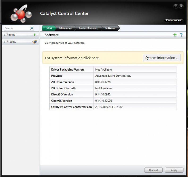

AMD Radeon HD 6490M Series, running AMD Radeon HD 7400M Series
Driver Version: from (9.0.0.) to 9.12.8.0) 2/11/2013
Intel® HD Graphics 3000
Driver Version: (9.17.10.3347) 10/31/2013
Catalyst Control Center v2012.0815.2143.37180 (Not Working)
Intel® WiDi Version: 4.3.3.0

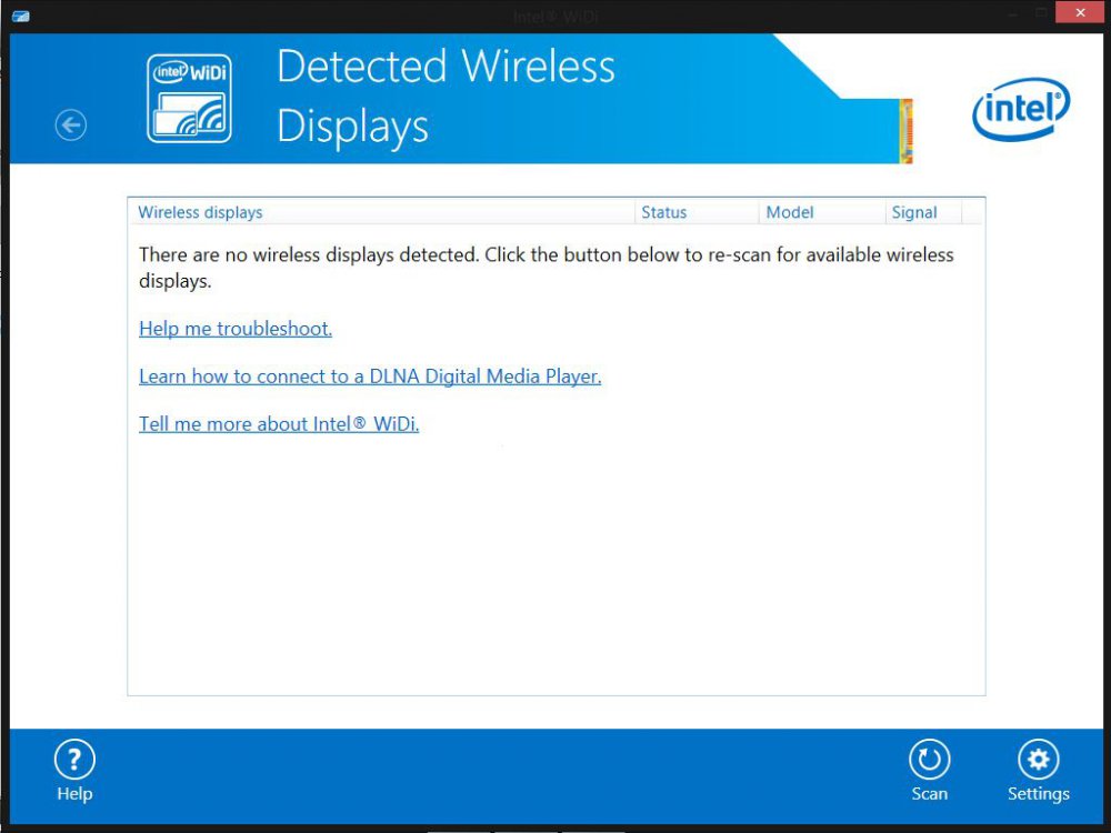

My current system’s configuration works flawlessly with older versions of both the HP provided AMD & Intel Driver Package sets such as, AMD High-Definition (HD) Graphics Driver_sp59147 or AMD High-Definition (HD) Graphics Driver_sp59850. The above mentioned HP provided driver packages each work great on my system under both a Windows 8 and Windows 8.1 (OS) Operating System environment.
However, I recently decided to update my Intel Wireless Display (WiDi) driver in order to make it compatible with the new Netgear Push2TV 3000 adapter I recently purchased. I had been using an older model of the Netgear adapter while using WiDi. But I could not update my graphics driver or even wireless network drivers beyond that point to ensure my WiDi would continuing working.
Any real gaming on this system was never really a consideration for me from the time I purchased this system. However, I would like to take full advantage of every feature it had at the time I purchased it, regardless of whether I update the OS. I can neither use WiDi nor even play a simply Angry Birds Rio game right now. The Intel graphics is the only one of the two GPU’s available to me right now with the Microsoft Update’s more current Graphics driver versions installed. The AMD Catalyst Control Center is installed, but not working. It has no way of controlling the two currently installed graphics drive in order for them to work in tandem as they should. As you know, HP never intended for my particular Laptop to be support beyond Windows 7, so I’m limited as to what I can do.
I’ve tried many different system configurations using mostly HP drivers for similarly configured systems to mine that were pre-configured to run Windows 8. The problem is, I’m now running Windows 8.1 and Intel continually releases new update for their WiDi feature in seemingly rapid succession. Each new release seems to require the latest Graphics drivers to be installed.
I ‘m cool with not having switchable graphics enable on my system, but I would like to be able to enable it when I need it.
Is there anyone out there who has managed to find an HP AMD graphics driver package that contains the latest Intel graphics driver v.16? I’d be willing to even try a Leschcat solution, but not at the expense of my 8.5 hour battery life (both the 6 and 9 cell) or the cool sense thermal and noise control. A clean install also isn’t an option for me. It is way too much work trying to find the most current and correct drivers for everything.
Can anyone help me find a reasonable solution?
