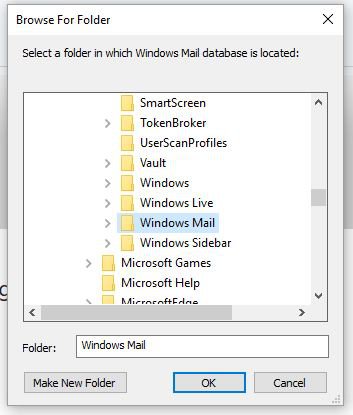

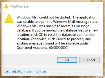

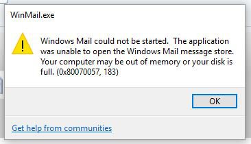

I can't link WinMail to my Windows Mail message store
Endeavor,
By following the instructions in post #10, it looks like I was able to (almost) get WinMail going on Win 10.
My problem, at this point, is that when I launch WinMail, I get this error message:
Clicking OK gives this screen:
What ever directory I select (from the two I have listed below) I get this message:
I have lots of memory and my disks are only half filled.
Part of my problem may (or may not) be that a couple of years back I installed an SSD as my new C:/ boot drive and ended up with a dual boot system. There are Windows Mail folders in both the Programs Files folders on my C: and D: drives. Before the Win 10 upgrade my WinMail under Win 7 was running out of the D:/Program Files folder.
Looking around, I have found multiple Windows Mail message stores in Users\Me\Appdata\Local\Microsoft\Windows Mail
WindowsMail.MSMessageStore.2013_11_27_17457 11/27/2013 47,120 KB on my C: drive (this one looks like a backup)
WindowsMail.MSMessageStore 12/02/2015 30,736 KB also on my C: drive
WindowsMail.MSMessageStore 02/06/2013 43,024 KB on my D: drive
The WinMail folder I set up is on my D: drive in place of the one that was working under Win 7.1.
However, the most recent Message Store appears to be on the C: drive.
Any ideas?

endeavor
355
Hi John,
From your screenshot background that looks like x64 right, you might want to change your spec to say x64 instead of just Win 10 Pro. Sometime these details are important for sure.
Speaking of screenshots you did a good job of outlining your problem.
I've never encountered that particular problem myself, but there was someone recently that pm'd me with a similar message store prompt message, but I don't know if they ever got it resolved.
It's always something simple, however it might not be in this case because of a number of reasons and what you did to cause this issue. Thinking outloud here, if you imported you old message store into the new one and clicked some wrong buttons, or some other function similar you did setting up WinMail.
Also I myself triple boot on each of my Primary partitions, and yes of course WinMail is on all my different OS's since Vista, However! in my case, I don't use a standard or definitely not the built-in boot loader of the OS, no way do I want MS or any particular OS boot loader system files getting its paws into any one of my other OS installs; iow, installing OS's allowing it to place 'any' of its OS files throughout any other of my primary partitions or even logicals is strictly not allowed on any of my setups! period! ...specifically because for those very reasons. On each Primary partition of mine, only One OS is allowed to be set active and set visible at any given time, the other two are Always set Hidden. When I install a new OS - all other primary partitions are set in-active, and set hidden, so that the built in boot loader does not see or activate, AND, it does not place any of its files within any other primary partitions. When I boot to other partitions OS's, automatically the one that it's leaving, is set inactive and set hidden (...anyway, all of which is very OT to WinMail so I don't want to digress here)
Back to your issue, in order to solve your current problem I need to be able to reproduce your problem, and then develop a reverse for it. I would need to have your exact movements of what you did to duplicate it, and then resolve it, and/or your computer and keyboard in my hands to figure out how to set it straight.
Also as you know I am a big supporter of everyone use a partition image backup software program, so that they can restore OS partition images at will, backwards or forwards in time, which allows them to have god like power over most all situations - I wish we could do that in real-life with our lifes' timeline - LoL
You should only have One:
''C:\Users\you\AppData\Local\Microsoft\Windows Mail'' folder and its specific related files within it's folder.
(once you start fooling with files or accounts in this folder, or news or local folder (needs to be done only by an Expert user) ..then all bets are off, but once you do and the registry picks up various incorrect targets, then again you're in trouble! Some type of registry and/or system and/or partition image restore is necessary to set it aright again.
I do know one thing for absolute sure, is if you install your OS anew, with it being the only OS seen on your system, and following proper importing guidelines, fresh installs are better, then absolutely you will be able to reinstate WinMail every single time without any problems.

JohnErbes
6
Milwaukee
Fixed it, thanks Endeavor
Well.... I just gave up, deleted all of the Windows Mail folders I could find in Program Files (there were a few of them) and then redid it all using your downloaded Windows Mail folder.
Took all of three minutes.
When I started up WinMail my thousands of old emails were still there and it immediately downloaded all of the new emails I had missed over the past week.
Works great. Thanks again.:)

endeavor
355
Nice job then John,
In order for you to still have those emails then you had to of... well it's complicated to type it all out.
It's unlikely if you created multi-folders within your incoming WinMail folder that they would have stayed in order within the same folder structure. I don't care for restored folder structures either.
Yes my message store from way back to Windows95/98/etc, etc, etc ...goes with me in each new OS install I do. Looking at my current inbox my first email goes all the way back to the early 1990's LoL!
I have swapped my email store from one OS installation to another different one yes, but I will not even outline the procedure.
Not many people do it, it's a complicated procedure sort of, well not if you have the exact steps written out; I've even forgotten most of it of which I mean ''to have it in my accessible brain memory that is'' ...and of course I would have to refer to my notes I made to myself. Next time I have to do it I need to organize my notes to myself better...I know I can succeed in doing it, but I would not walk anyone else through it and don't want to be responsible, and only advise installing from scratch and importing, etc.
Yes swapping email store folders within ''the same OS'' but just different timelines (from restored partition images) ..is very easy since the registry markers are all the same number, so it's just a delete/copy/paste of that entire folder. I do that part all the time.
Anyway, nice job, and happy holidays everyone
