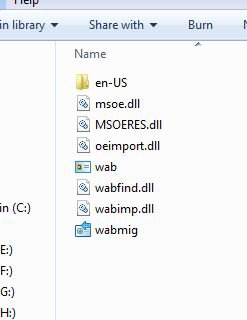

No quarantined files, hidden files and folders set to be visible, Latest 7-Zip. I don't understand. What's best to open a RAR file?
You did mean the zip file in post #1 of this thread - right?
This is all I see:
