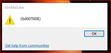

Well it was fine. I had WinMail working in 10 AFTER the Anniversary Update.
Now I'm getting this which I haven't seen before:
