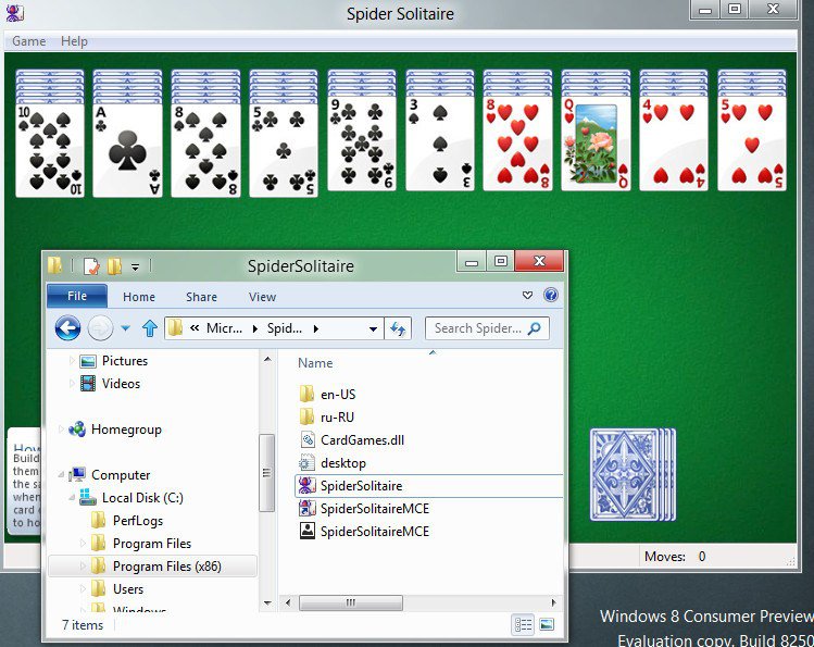

I found a way to make the games work, unfortunately, I don't remember where. So, all credit to the original author and my apologies for misplacing your identity :(
To do this you'll need the following:
1. The Microsoft Games folder from C:\Program Files - This needs to be from a 32 bit version of Windows 7 even if you're using a 64 bit version of Windows 8
2. The cardgames.dll file from Windows\System32 - Again, from a 32 bit version of Windows 7.
2. A Hex Editor - Get a good free, no install program, from Free Hex Editor XVI32
Procedure:
1. Make a copy of the game file you wish to modify. Example SpiderSolitaire.exe - Found in the Microsoft Games\SpiderSolitaire folder
2. Open XVI32
3. Select File/Open and navigate to your Microsoft Games\SpiderSolitaire folder
4. Select SpiderSolitaire.exe

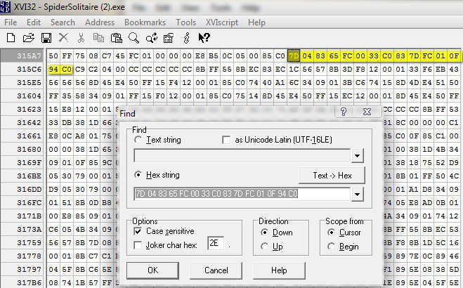

5. Open Search and enter 7D 04 83 65 FC 00 33 C0 83 7D FC 01 0F 94 C0 (copy and paste)

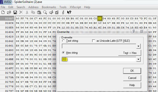

6. Select 7D and select Edit/Overwrite String
7. In the dialogue box, make sure Hex String is selected and type EB
8. Select OK
9. Select File/Save
10. Copy cardgames.dll to the Microsoft Games\SpiderSolitaire folder
11. Copy the Microsoft Games folder to your Windows 8 Program Files (x86) folder
12. Play.
I haven't tried the other games but I believe the same 'hack' works...

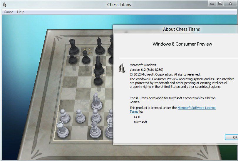

By the way, Chess Titans works using the method I described above.
