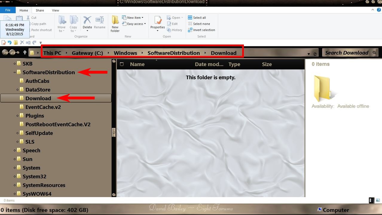

If the Windows 10 update is already downloaded, look in-
If you want to get rid of it, if it shows up there or elsewhere in the main folder, delete it.
You can rename the Download folder & delete it to get rid of everything in it quickly.
When you restart your computer it will be recreated by Windows.
I have done this myself.

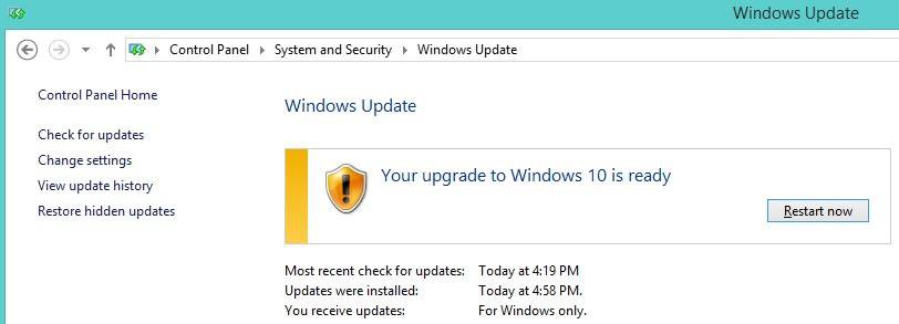

Unfortunately, this problem is well beyond merely stopping a download or not saying "Okay" to the Windows 10 upgrade - it appears that something I did actually invoked the equivalent of an "Okay, go ahead and install the upgrade" and now this system is stuck like this:
and I do not know of any way to get around that - the dialog that told me this happened didn't ask if I didn't really want it and, upon Restart, I eventually got another similar dialog asking if I wanted to go ahead or if I wanted to reschedule (2nd time), again with no way to say "Look! I do NOT want to go through with this! Cancel!".
So each time this machine reboots I'm now expecting, upon login, to eventually have a dialog pop up asking if I want to go ahead or reschedule. Of course, until someone helps me get this cancelled, I'll be "rescheduling" the automatic upgrade for a couple days hence.
So if anyone knows how to cancel an "update" that says it's going to happen on Restart, please help!

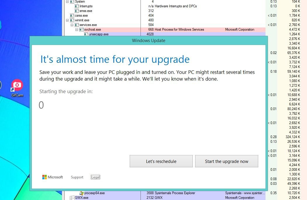

An aside about these dialogs that are popping up saying the upgrade is going to start if I don't reschedule it - the 1st one I got (just before I started this thread) had two options - go ahead immediately or reschedule for up to two days in the future; I chose two days in the future at 07:00 (Friday morning). The 2nd dialog that popped up just now after a Restart had the same two options but the TIME of the rescheduling has changed to be a bit later. This suggests (I hope) that everytime I restart/reboot this computer I will be given an option to reschedule for the future that isn't limited by midnight August 14th...maybe.
Post-post addition:
Here is an example of the dialog that pops up about 4 or 5 minutes after a reboot and logging in - there is no choice to cancel the install:
YES!
Thanks for that excellent lead - I will indeed try that since Scenario 3 is exactly my sad situation (I think I got there, BTW, by selectively deleting SoftwareDistribution\Download" files or something similarly bizarro as I tried to track down that SPP strangeness, a strangeness that is widely mentioned on the 'Net with almost zero valid feedback - may simply be a red herring).
[aside - this morning a few minutes post-powerup the popup immediately above showed again, however THIS time it had advanced the maximum possible reschedule date by one day. This strongly suggests that I could indeed simply keep rescheduling into the future until I was satisfied with whatever I needed to be satisfied with]

Thanks again for that lead - it apparently worked fine. After reading your post and the linked contents, I restarted my machine to get the popup to appear, then rescheduled the upgrade to a couple hours in the future rather than on the 15th. Following the Scenario 3 directions I then simply waited until the auto-install kicked off and it wonderfully broke completely, kicking me back to a plain old Windows 8.1 Pro system. At this point I'm waiting for something to show up under Windows Update to confirm that THAT works normally even though the Windows 10 Upgrade has been hidden, etc.
Thanks very much.
Now...on to the other things that are strange about this 8.1 system - like failures to update apps like "Windows.Reader", etc...and that SPP apparent-error and whether or not it means anything at all.
This is not speculation.
