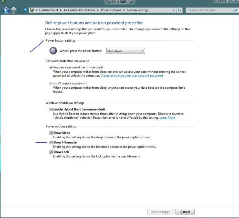

Go to the Control Panel - More settings, then to the Power Options in the old Control Panel. Or type Power Options into Search on start menu- go to Settings at the bottom there. Click on "Choose what the Power button does" on the left.
Scroll down to the bottom, and tick the "Show Hibernate" box. Now it will show up in the Start menu - Settings, under "Power".

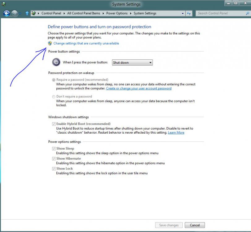

*If the settings are grayed out there, click on the "Change settings that are currently unavailabe" at the top, then change it.

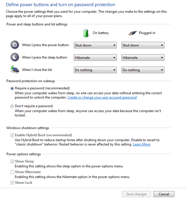

Where did you see the option for "Change settings that are unavailable"? Here is a screen shot of the menu I had. I didn't see this option... power options.PNGCould you post a screenshot of your menu?
Hmm, not sure why I have it and you don't.
Although I've installed my Win 8 on a physical desktop machine, and I see you have it on a laptop. Maybe that is what makes the diff? Also I am using a Local account, as opposed to a Live ID account. Not sure if that has anything to do with it or not.
It's also accesable for me through the Require a Password on Wakeup link in Power Options as well.
Link is there:
Clicked and assessable there:
It isn't because it is a laptop. I checked on my desktop and the option is missing on this one too. Also I don't think local client has anything to do with it because my laptop is a local client (my desktop is live). I checked on the "password on wake" and it also is missing that option. What is your build number? Mine is Build 8102.
I'm running the x64 version. That seems to be the only difference that I can tell...Seems like an odd difference though....
Strange. I don't know then. Maybe try restoring the Power plans back to default from the power options advanced window.
I see reference to users that turned off User Account Control didn't have it in Vista, and turning it back on made it reappear, but I tried it on my build and there was no difference. Was still there regardless, even after reboot.
The words "Change settings that are currently unavailable" are
OK, I went to the link you provided and tried several things. I created a new power plan: no luck. I reset the power settings to default via command line: no luck. Then I tried turning on User Account Control again. At that point, I restarted and some updates that I had downloaded earlier finished installing. So either those updates did the trick or it was the user account control.

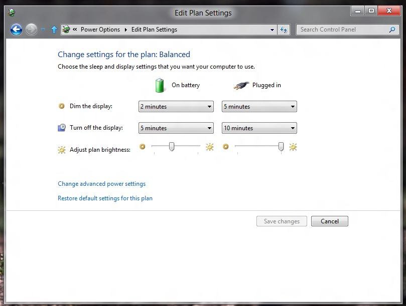

This is an easy one
Freelancer, all you need to do is go into control panels, then to power options, and tick the box mark "Hibernate", and set the
time you want to wait before your system goes into hibernation. NOW remembering that is in the "Advance" section. :geek:
See photo below.
