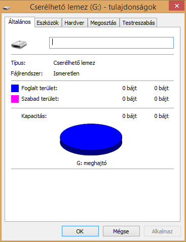

I want this in particular, because connecting as USB mass storage device doesn't work for the internal memory, it seems. (and because I'd like to use it through wifi)
I only get this in windows:
Also MTP's is frustrating garbage. And other methods are still more convoluted
I am going to guess that on your android phone your file manager tells you that there is file's on your phone.
Try to disable developer mode if you have it enabled (its not the default setting someone changed it)
Try to disable Unknown sources in security
