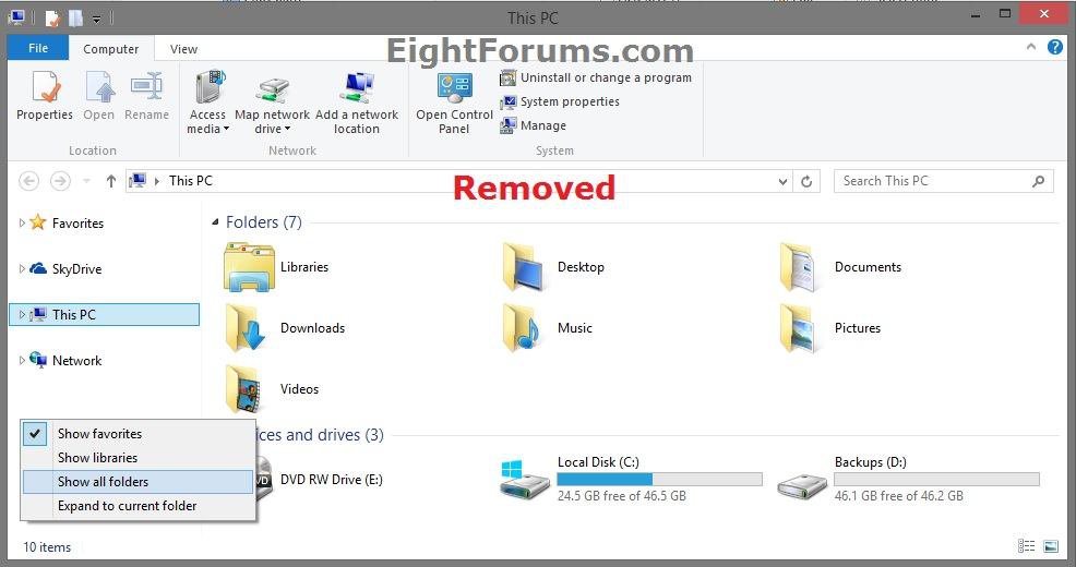

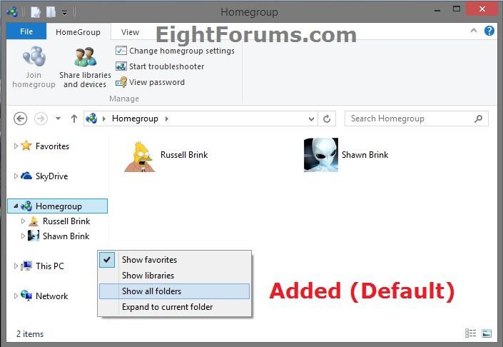

EXAMPLE: Homegroup added and removed from navigation pane

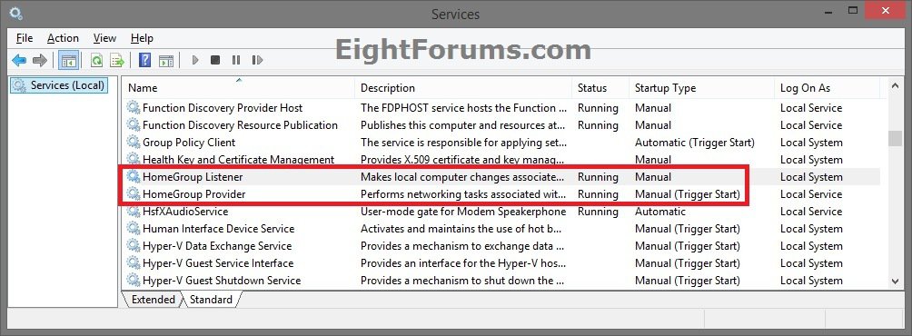

2. To Enable and Add Homegroup to Navigation Pane
A) Enable, set to Manual, and Start the two services below. (see screenshot below)
HomeGroup Listener
HomeGroup Provider
B) You will now be able to create or join a homegroup if you like, and users will be able to use OPTION ONE above.
3. To Disable and Remove Homegroup from Navigation Pane
A) If you are currently joined to a homegroup, then you will need to first leave the homegroup before continuing to the next step.
HomeGroup Listener
HomeGroup Provider

To Add or Remove Homegroup from Navigation Pane for All Users
This option will only add or remove Homegroup from the navigation pane for all users without affecting being able to use the homegroup.
This option will only add or remove Homegroup when Show all folders is unchecked. Homegroup will still always show when Show all folders is checked.

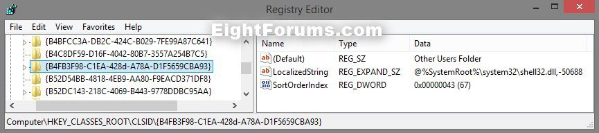

3. In regedit, navigate to the location below. If you have not already, then in the left pane of regedit, change owner to Administrators and check the Replace owner of subcontainers and objects box of the {B4FB3F98-C1EA-428d-A78A-D1F5659CBA93} registry key, and set permissions to "Allow" the Administrators group "Full control" of the {B4FB3F98-C1EA-428d-A78A-D1F5659CBA93} registry key. (see screenshot below)
HKEY_CLASSES_ROOT\CLSID\{B4FB3F98-C1EA-428d-A78A-D1F5659CBA93}

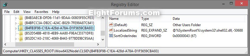

4. If you have 64-bit Windows, then in regedit, navigate to the location below. If you have not already, then in the left pane of regedit, change owner to Administrators and check the Replace owner of subcontainers and objects box of the {B4FB3F98-C1EA-428d-A78A-D1F5659CBA93} registry key, and set permissions to "Allow" the Administrators group "Full control" of the {B4FB3F98-C1EA-428d-A78A-D1F5659CBA93} registry key. (see screenshot below)
HKEY_CLASSES_ROOT\Wow6432Node\CLSID\{B4FB3F98-C1EA-428d-A78A-D1F5659CBA93}
