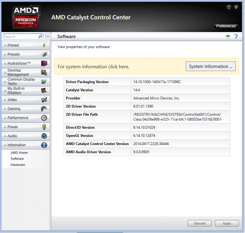

Ops, looks like I goofed up a bit. I'm running AMD Catalyst Version 14.4, not 14.7. I'm not sure why I thought it was 14.7? If you are running 14.7 maybe try 14.4 instead. I think 14.7 is RC , release candidate/beta, so maybe 14.4 will work for you. Something else I noticed is if I right click the Catalyst Icon in the notifications area I get a Configure Graphics and a Configure Switchable Graphics options.

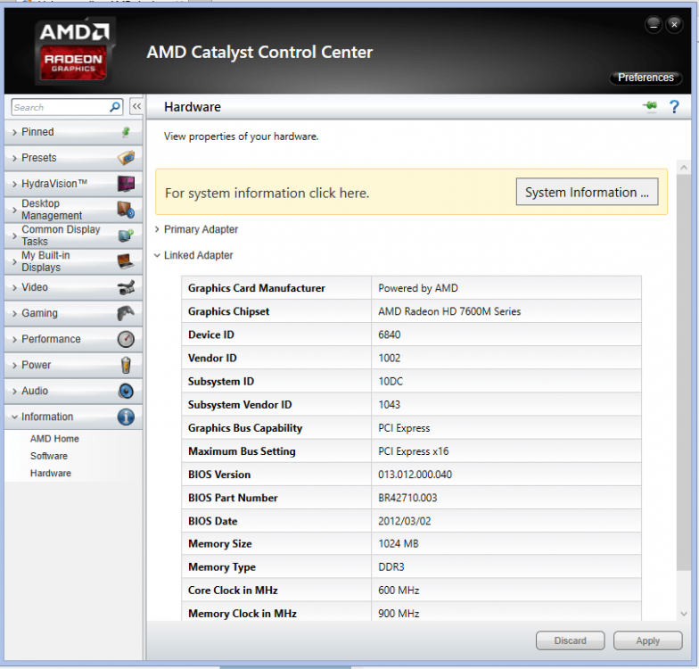

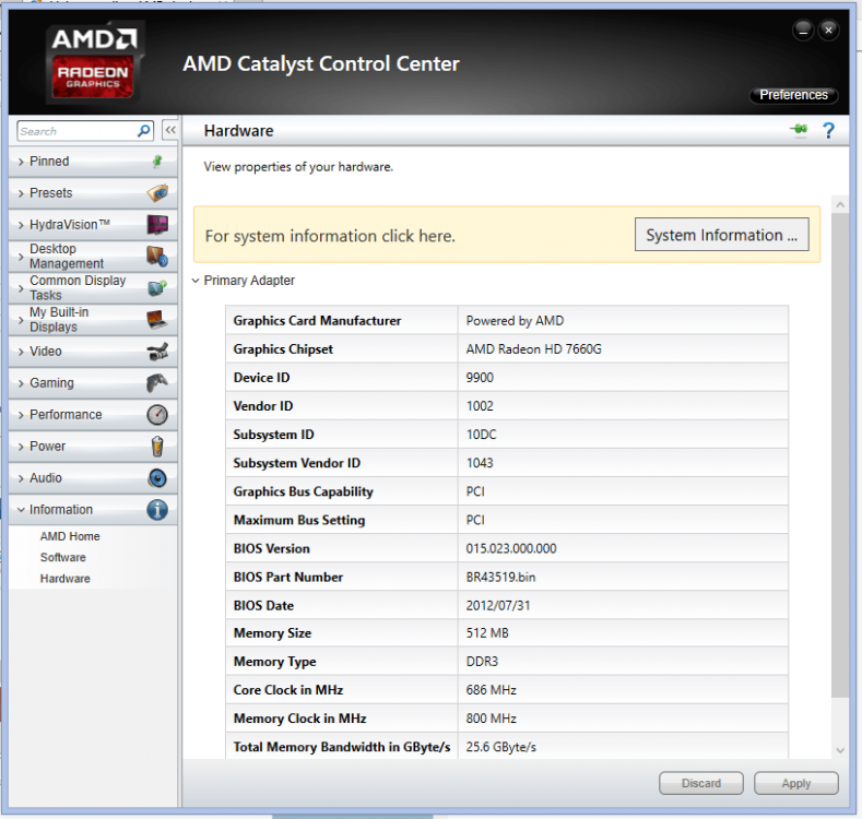

well i went to HP site and downloaded the video driver they provided here is the info i got from it
it says primary adapter and linked adapter i know whats that means
Wait a minute? Weren't you originally trying to disable it because of a game crashing? If so, it appears its turned off already? Now the issue becomes which GPU are you actually using? Still, if you could enable it, you should be able to set a profile for that game and force it to use which ever GPU you want. I haven't found anything helpful on turning it on or off. Everything I see says you do that in the CCC in the section I posted the screen shot for earlier.
yeah actually i want it to use dedicated one not integrated
it's disable that means only one of them is working ok ???
and have a look at it
only integrated GPU is working

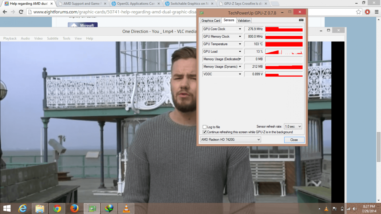

Yeah thats very any any way to keep it down also my laptop doesn't seems to get heated very often still that tmp is so high
Any thing i could do about that
With laptops it is usually one of two things, clogged/broken fan or poor heat-sink bonding as in dried up thermal paste or improper application of it. Sometimes both problems if the paste has gotten excessively hot due to the fan not working correctly.
