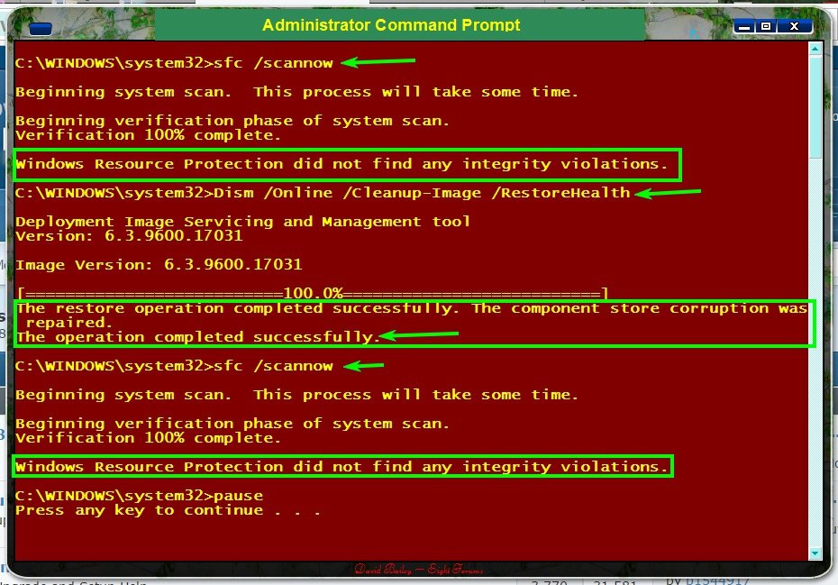

Have you tried running-
in admin cmd prompt ?
Then running sfc /scannow ?
i ran the dism and it replied (deployment images servicing and managment tool version :6.3.9600.17031
not really sure what this means but it did not fix anything
hmm thats odd because im not getting any type or % tracker of sorts
"edit" its actually doing it now and stuck on 20% as you said :dinesh:
will update once its finished.
again thanks for the help
Give it time.
It should look similar to this when done-
ok so after the dism it came up with this
error: 0x800f0906
the source file could not be downloaded.
use the source option to specify the location of the files that are required to restore the feature.

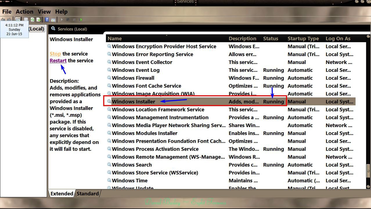

ok so yeah that update has been installed but when i tried to uninstall it it came up with this msg
the windows installer service could not be accessed. this can occur if the windows installer is not correctyl installed
i uninstalled a voice com though and it worked fine.
Maybe start the service & try uninstalling again-
