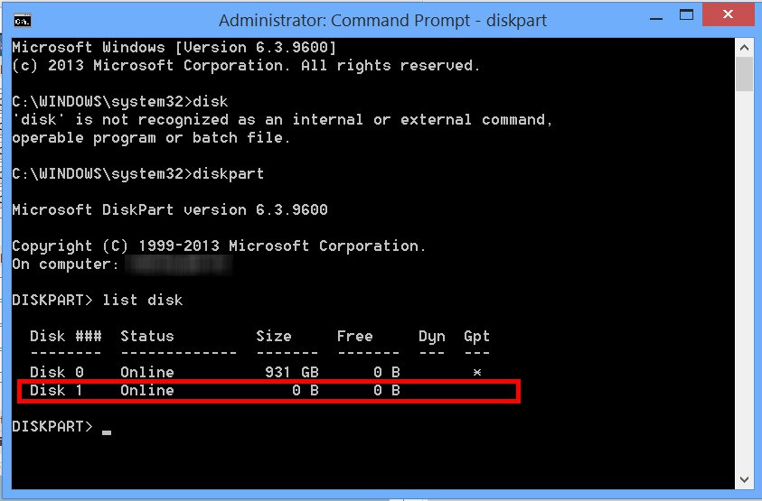

Using Command Prompt, it says Disk 1's status is "Online", but size is "0".

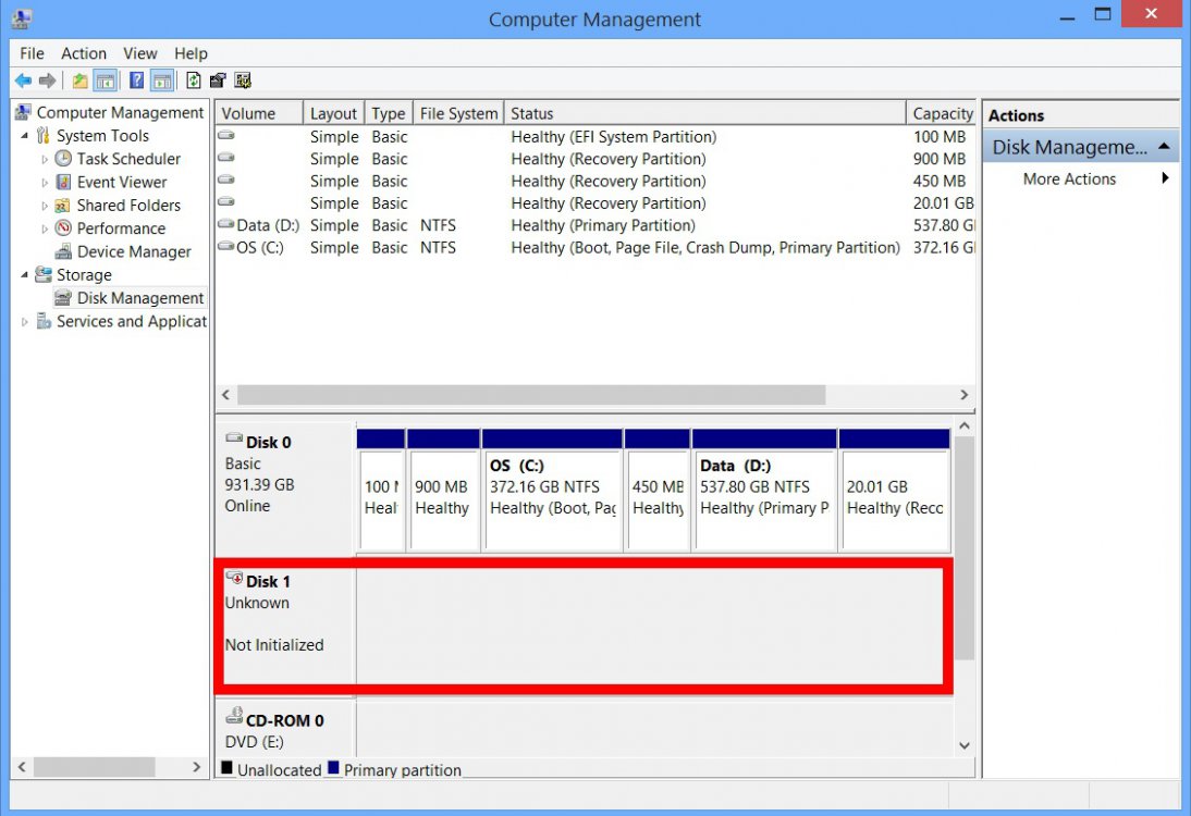

Here is the status at Computer Management:
Disk 1
Unknown
Not Initialized
I also tried to Initialize on MBR, but it returned me with "Incorrect function." message.

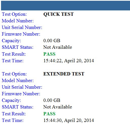

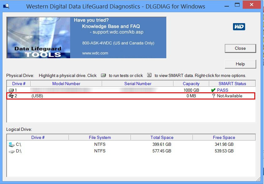

The manufacturer is Western Digital. I downloaded WD's diagnostics tool and performed the test. It only detected as "USB" instead of recognizing it as a WD product and unable to determine the capacity of the drive.
The test result was a "PASS" but oh well, with the capacity: 0.00GB (refer to screenshots).

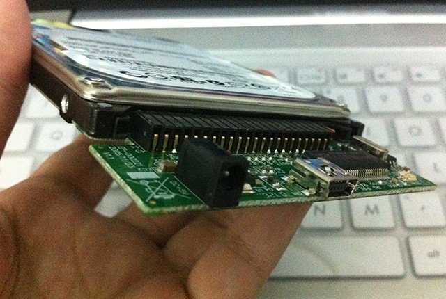

I am sorry if I misunderstood your sentences. Did you mean the pins?
The pins are soldered intact with IDE to USB 2.0 circuit.

Yes, I see that now, missed it before somehow, sorry. Yeah it sounds like the drive died.
