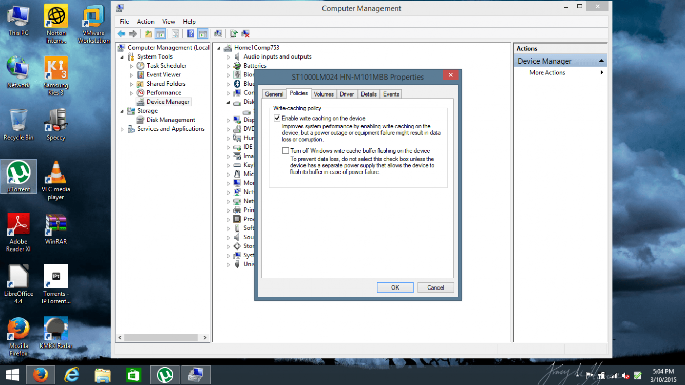

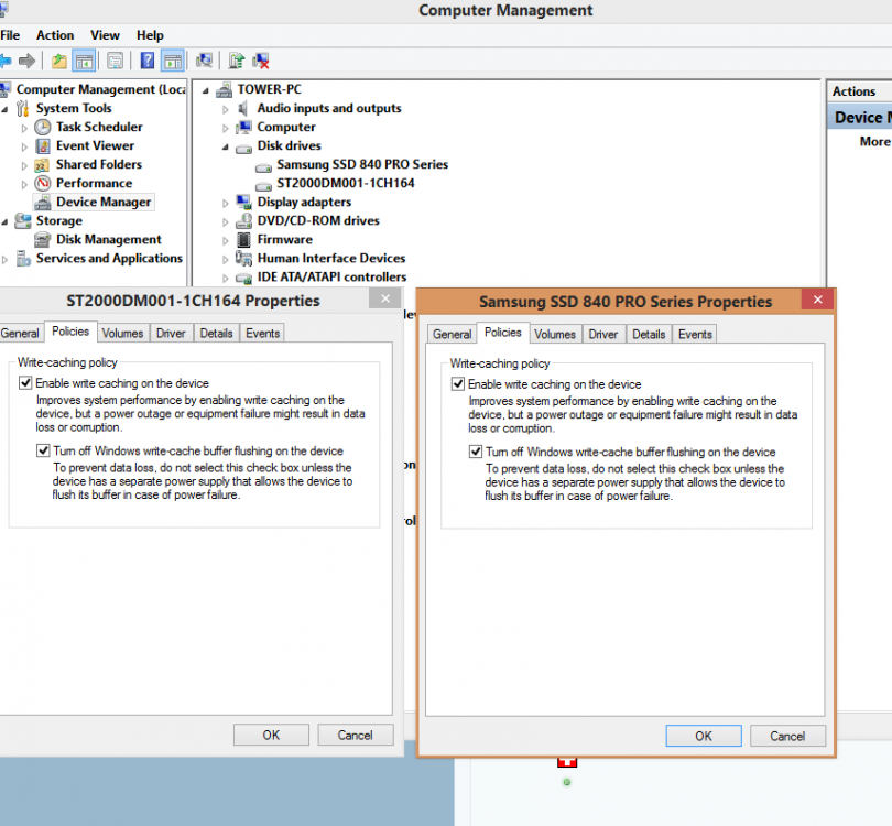

Capture.PNGAre all your disks policies set up like this(best when/if you have ,an uninterruptible power supply (UPS) to provide a backup power source for your computer too guard against power failures) with buffer flushing on the system has to wait until the buffer is written then it can fill with more data(this is safer) turned off the buffer can fill and write at the systems convenience and to the user it looks as if it's already written. Read this
The top checkbox is safe with UPS or laptop battery, the bottom one apparently not so much, as the drive itself is supposed to have its own separate PSU. This is the article that needs to be read concerning that option:
Dangerous setting is dangerous: This is why you shouldn't turn off write cache buffer flushing - The Old New Thing - Site Home - MSDN Blogs
I dont have the "Turn off Windows write-cache buffer flushing" checked off any of my drives. Never had to do that before. Going to give it a try and see what happens.
I have mine set this way, but I have a very good power source(still taking chances & I use Macrium Reflect). Where I live Germany I haven't experienced any unannounced power outages(from the city) or ones caused from storms. Its a lot different in N.H. where I come from.
