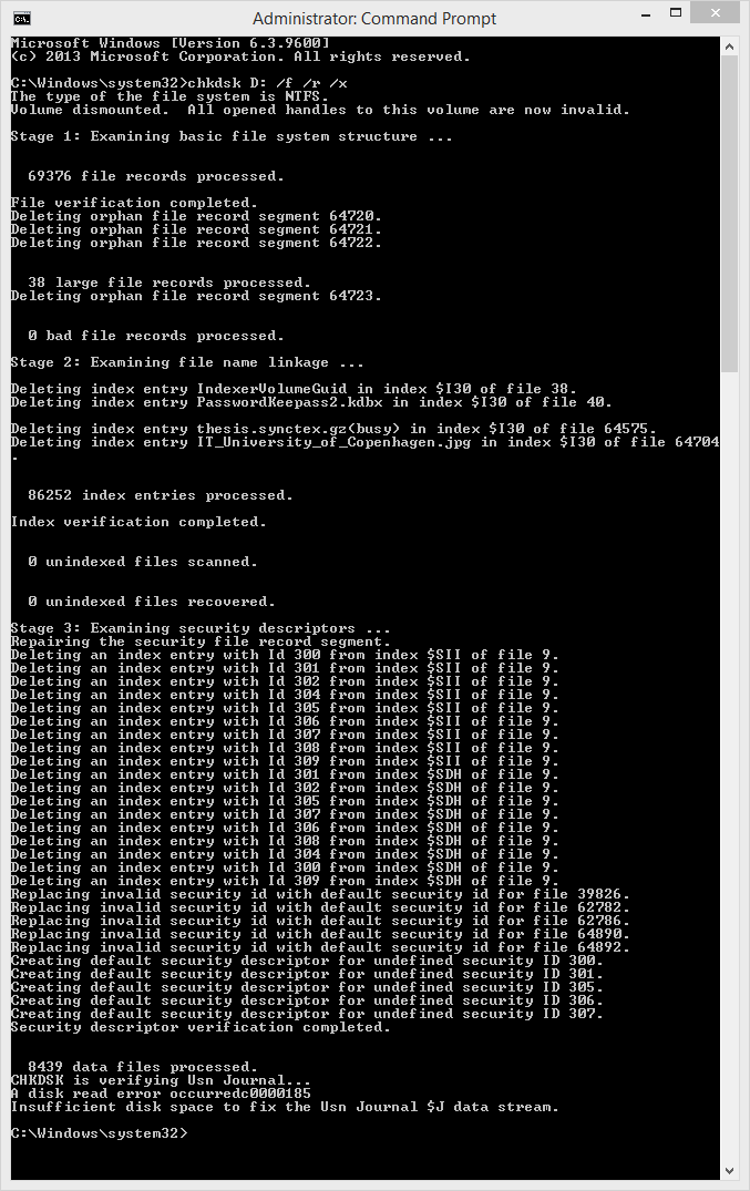

3- After a lot of struggle I decided to do a check disk with the following command: chkdsk D: /f /r /x
This took forever, again with the system using the 100% of the HDD. At the end it resulted a lot of mess, the chkdsk mentioned indexes lost, sectors moved as "not usable" and tons of other things.

- This is the result of the chkdsk
- Another chkdsk said that it found and error in Usn Journal but it could not restore it because of lack of space on the HDD. I cleaned 93 GB more, hence leaving more than 200GB free and it still said that it didn't have enough space to restore it. What is wrong with it?

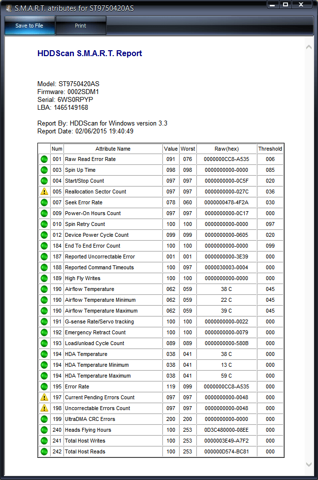

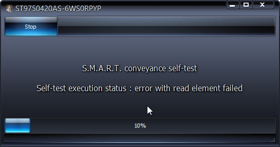

- Additionally from HDDScan:
Should I be worried about the 3 warnings?
- Conveyance self-test failed
