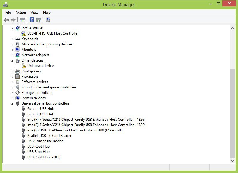

Under 'Universal Serial Bus Controllers' there are so many to choose from I don't which one is which? ScreenHunter_06 Sep. 18 19.14.jpg
You mentioned USB 3.0 so I would try the one that has USB 3.0 in the description. It is no big deal to delete them all. When you restart plug and play will reload them all. But I would try the one that says USB 3.0 by itself first to be cautious.
