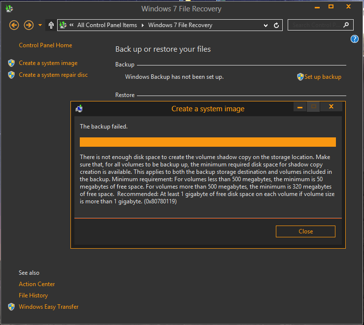

Since a week is it impossible to make a Win7 Backup Image (Control Panel).
This is the feature that got removed in 8.1 but now (on 8) I'm still using it in case I need to restore the OS.
The message shows this:
"Not enough disk space" but I have 360GB free on one disk and 150GB on another. The image is calculated at 67GB and it worked each time until now.
All OS updates installed.
Does anyone have any hints or ideas how to fix this?
Thanks

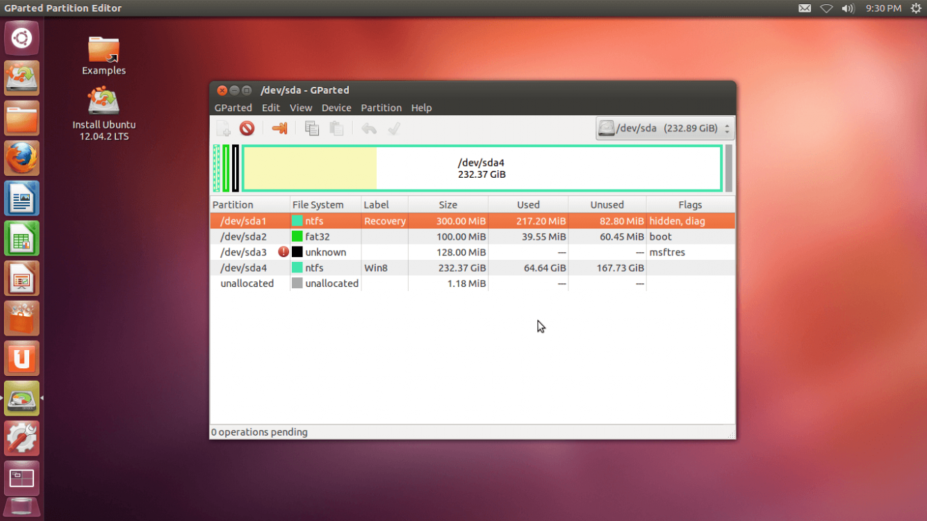

I've checked with Gparted from within a Ubuntu USB to see how the partitions look:
Recovery is 72% full. It seems this might be the cause of the error. I don't know what the default values are, I don't know if it was filled in time or if it can be emptied.
Normally, HP UEFI Diagnostics cannot install on Recovery because it's a NTFS partition.
The EFI System partition is 39.5% full and it has a safe value even it was filled with extra files (good HP diagnostics candidate).
However I'm unable / don't know how to see which partition contains the HP diagnostics but more important: How do you see what's on the recovery partition or reduce its size if possible?
My self proposed solution is to try and increase the recovery's partition's size but it will require a chain-reaction resize to the rest of the disk because Recovery is the first partition.

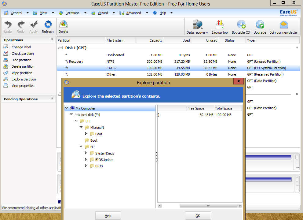

This has been taken care of by using Easeus Partition Master. I see that the recovery partition is intact (winre.wim + a few small logs) and that the hp tools were installed to EFI System (fat32).
It's risky and I doubt the recovery partition to be the cause, now I've seen what's on it.
I agree it doesn't look like the Recovery partition is the problem, it looks like mine. I did notice your EFI partition contained the additional 10-11 MB of data you indicate are the HP files. So not really sure how that might effect the backups, because you do still appear to have the necessary space to create the Shadow copies needed.

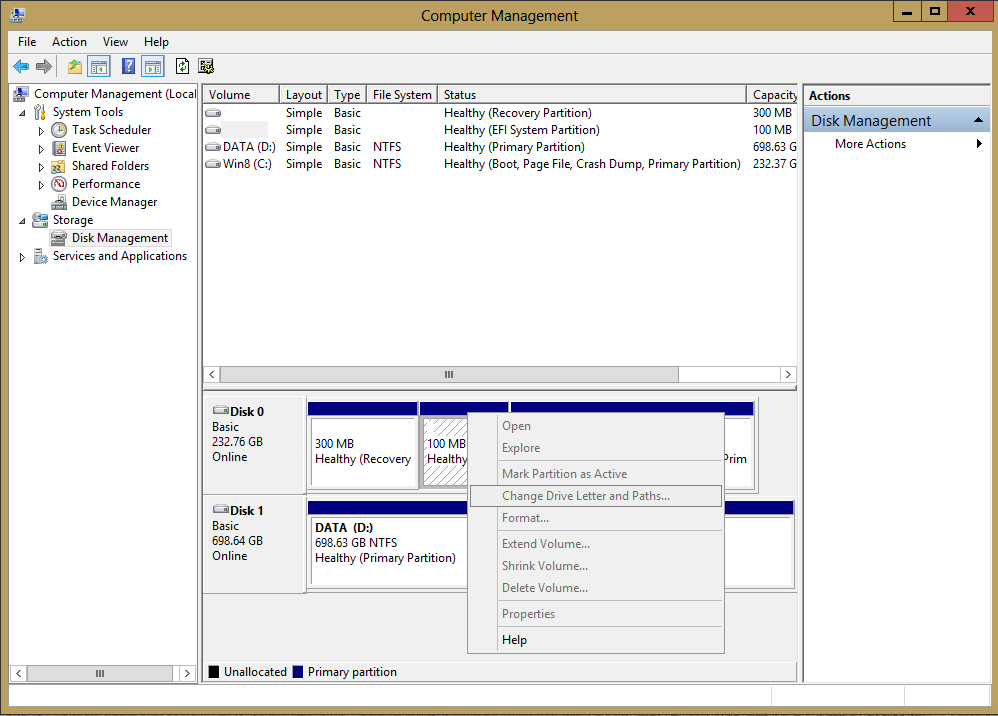

If you need to alter the EFI partition, you can put a drive letter on it and access it in the command prompt. A dir /a command will show the folders. Since I do not know what the HP stuff is or what it does, I cannot comment on what you might do in the partition. If you try this, make sure and remove the letter when finished.
I was reading about one of the third party imaging software packages and it appeared to use Shadow Copies also. But since I have not used any of them recently, I do not know if that is correct. Let us know if the one you choose works. If Windows 8.1 does leave the Recovery folder in the C: partition, the software will probably work, but not include the old Recovery partition in the image. So I will wait for the final version, which should be soon, to check the operation.
Thanks for the idea,
I'm not allowed to add a drive letter to Recovery or EFI partition.
I can browse it with Easeus Partition Master, as said in previous posts, see here:
It does contain the HP stuff in it but that is indispensable for the system.
Funny how the Recovery is labeled as "unused partition" with 217MB used space.
What is the unknown 'reserved' 128MB there (previously seen in Gparted as well) that Disk Management doesn't show?
-> it's entirely full but I guess that has something to do with the OS, SecureBoot or the filesystem; and it doesn't get included in the backup so it shouldn't affect anything: but I never checked its size before. :think:
Sorry, I forgot to mention you need to use Diskpart to add the letter.
I was just giving you an option, not suggesting you alter anything.
