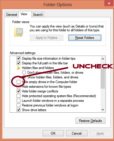

See, in Device Manager choose "Show Hidden Devices" and look for your Dummy CD Drive in the CD Drives list
Dont touch the MS Virtual drive, just remove that one Dummy drive:
(I dont have any other dummies, but that is where the dummy you have will show up)
And next - STOP using Virtual CD, use UltraISO instead, its pretty cheap. You can also use MagicDisc - both are compatible with 8 and 8.1 - MagicDisc will add dummy drives as well, but they vanish when not used.
Once you get rid of your dummy drive, you should be able to open your Tray from within windows.
