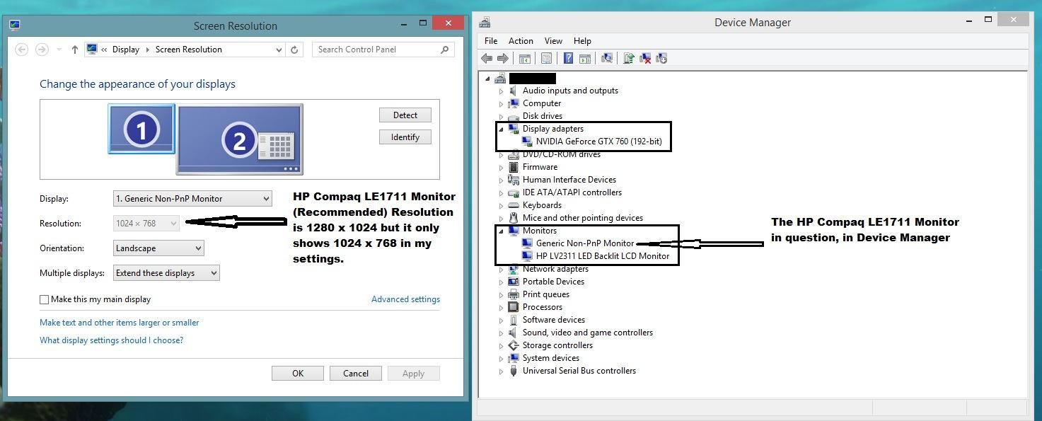

Need help with dual monitor setup. First time trying to do it.
2 Problems
1.
Second monitor does turn on, but is only showing native resolution (1024 x 768) but it has the ability to go up to 1280x1024.
I want to to be able to set it to 1280x1024.
2.
Second monitor will not boot up along with computer.
I shut down my PC, the monitor is still plugged in, and it doesn't wake up automatically.

Picture of what I'm seeing:

You can download the driver here Drivers & Software for HP LE1711 17-inch LCD Monitor - HP Support Center.
But the most likely reason is that the EDID data of your monitor is corrupted or not transferred correctly.
EDID tells your system which features the monitor has and which resolution it supports.
If this fails windows will use the generic nonpnp monitor and set 1024x768 resolution.
First check if there's anything which could prevent the EDID exchange: Broken cable, damaged connector, VGA-DVI adapter, one-monitor-two-workstations switch, etc.
Check your VGA-HDMI adapter is properly connected , not faulty broken pins etc.
Try this is a Test: I suspect that if you use The VGA-DVI adapter the monitor will be recognized correctly, if not your VGAcable may be faulty.

It didn't work. I'm actually trying another Monitor at the moment. HP 1730, which I couldn't find any graphics on.
However I was able to make this monitor 1280x1024 resolution but it's a tiny bit blurry. I did it by making a custom resolution in the Nvidia Control Panel.
