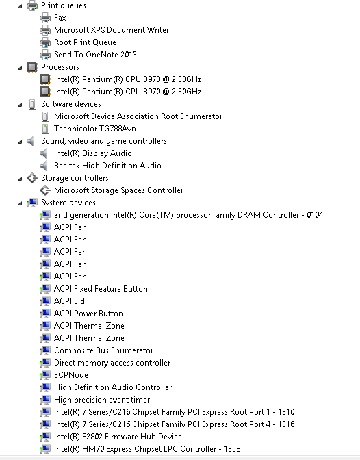

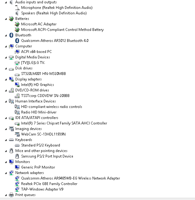

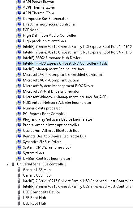

For the wireless adapter, you need to download the appropriate drivers. You need to actually download the drivers for your laptop itself, the chipset and stuff as well. Could you post the exact model number of your laptop and I can help you get the drivers? Also, if you could right click the start button, select device manager, and expand all of the devices, take a screenshot like the one I have attached, and post it, that would be great. I had to do it in 3 parts because there are so many devices associated with my computer, you likely will as well.
You will need to be booted into Windows 8.1 in order to capture the device manager, since that is the OS where drivers are currently installed.

Hey enus - here is the repository I have created for you with drivers for your laptop with Windows 7. Most are Samsung certified drivers for Windows 7 from the Samsung website, and some are directly from the Intel website. If you install all of these under Windows 7 you should be up and running. https://onedrive.live.com/redir?res...50&authkey=!ANbemR7LyD5TuQ8&ithint=folder,ZIP
After that, be sure to install a free antivirus such as Microsoft Security Essentials or Bitdefender Free Edition. Then do all of your Windows updates and install any other software you want and that should be it :) Feel free to ask if you have any more questions.
