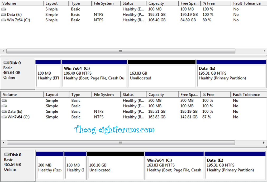

1. Start or restart your PC, and boot into Windows 7 or Vista. (see screenshot below)
2. In Disk Management, delete the partition that you installed Windows 8 on so that is is now unallocated space. (see screenshots below)
3. If you like, you could either create a new partition to use with the unallocated space, or extend the Windows 7 or Vista C: drive into the unallocated space to add it back to the C: partition. (see screenshot below)
NOTE: This will vary depending on how you have your hard drive setup though.
4. When finished, restart your PC and only have Windows 7 or Vista installed and listed in the Windows Boot Manager screen.

When you have your Dual boot on a PC with a uEFI setup.
Follow the steps in Part One.
All done.

Probably a dumb question but.. does the unallocated space join back with the main OS partition or do you have to manually do it somehow?

You do it manually.
Rt click the win 7 partition and select Extend.

Hello Nonpasaran,
When you delete the Windows 8 VHD or partition from within Windows 7 and restart the computer, you do not need to do that since it is removed automatically when you restart. :)

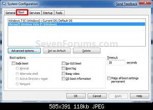

And that's why i prefer to delete the boot option from msconfig to finish it off before restarting.
Hello Nonpasaran,
Not need, when using Windows 8 Reboot bootloader.
