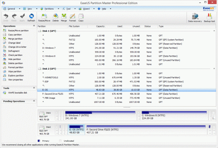

The SATA 2 drive has eight partitions -- see the attached gif - click on the thumbnail below to see it clearly.
- SATA 2 is Drive 2, the original Win 8 is highlighted for this gif and appears as "OS", and you can see the partitions for WINRETOOLS and PBR that maybe are mentioned in the error messages. Note that nothing here is "boot".
- SATA 0 is Drive 1, and you can see its two dual-booting OSes. Windows 8 is actually 8.1, and it is marked "boot".
So, what do you think about these two new error messages in this confusing setup? (Other than I'm out of my mind.) Thanks.
