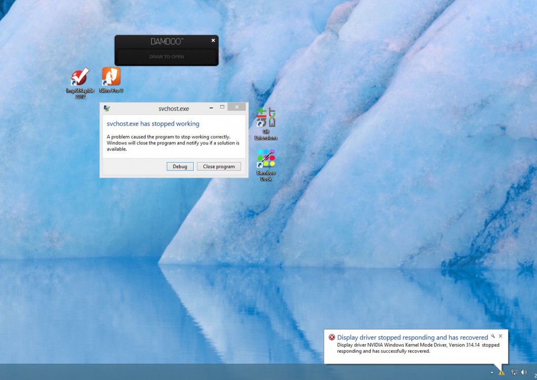

I just installed my new graphics cards and successfully install new driver.
Most of time i got this error on the start up of my computer. Here an image
But it did happen once,when i was playing sniper elite nazi (for about 10min) and when it crashed i had to reboot because the driver didn't recover so any other games refuse to start giving DX11 failed error or just .exe crash.
All other games work properly.
I tryed to place the card in another PCIe slot but doesn't work either. I try both Driver Beta and the official one but both failed.
Please help me ^^
Thanks guys!
I did my own investigation and the primary reason is that my chip have 70.5% ASCI (with GPU-Z) which is kind of bad but not defective.
I flashed my bios with maarteen version and i'm able to have 1123 mhz gpu clock without problem and no throttling. Higher then that it keep crashing.
So more your ASCI is low, less u can overclock, lets say lower than 70 mean that your card have more "flaw" then other and is probably defective (lemon).
